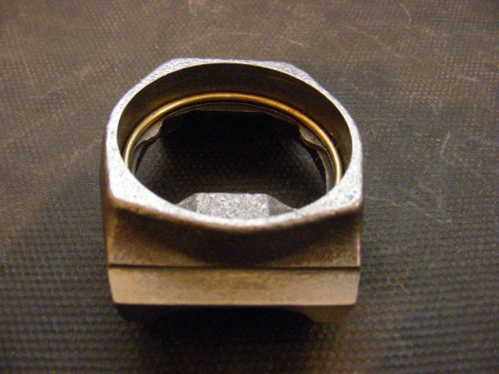

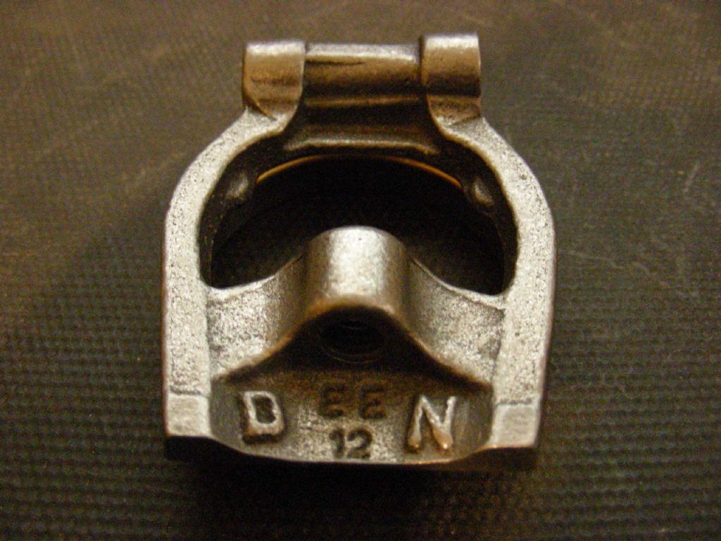

        Can anyone identify the item in my photos?
        The object, believed to be a steel forging rather than a casting, came into my possession during a recent factory tour in west London; overall dimensions are about 2" x 2.75".

              Only if they are bad at spelling – it is marked DN not DK

                        Thank you all for your interest – and interesting suggestions. Unfortunately, I don't know whether the dnforge idea is correct but I can say that early versions of this component came from France.
                        As a hint, the gold-coloured ring is brazing metal.

                          West London factory, brazing, steel. Brompton bike hinge?

                                    It looks quite complex to be a forging but I am not an expert on forging, far from it. Would it be a malleable iron casting? having a bit of a google it appears there are a few letter combinations on similar items.
                                    Mike
                                    #454192
                                    John MC
                                      @johnmc39344
                                      Looks like an investment casting to me. Also looks like a Brompton hinge but looking at the picture of the unmachined hinge, they look like sand castings. As for material, my money is on malleable iron.

                                          Posted by Roderick Jenkins on 25/02/2020 07:42:09:
                                          Rod
                                          Got it in one sir!
                                          PS I will try to find out whether it's a casting or a forging.

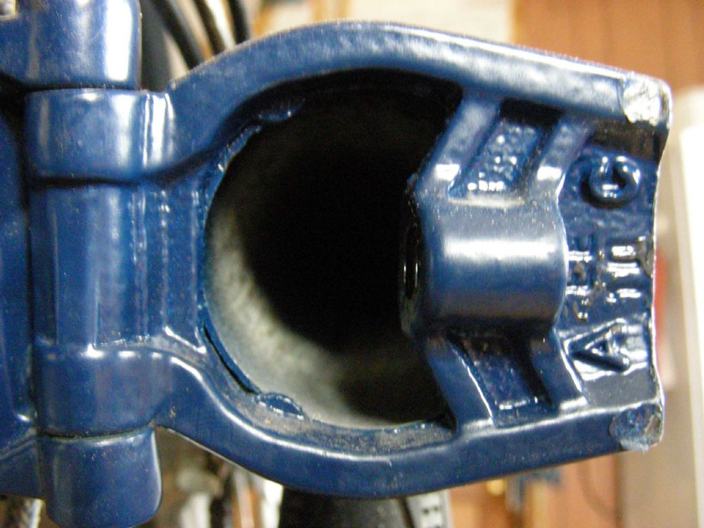

                                            I have now photographed the corresponding item in situ:
                                            The letters are, again, different.
                                            Thinking about the traditional cycle frame lug, I was struck by the short length of engagement of the tube at this vital juncture. Brompton used to warrant their frames for life although I understand this is now a nominal five years.
