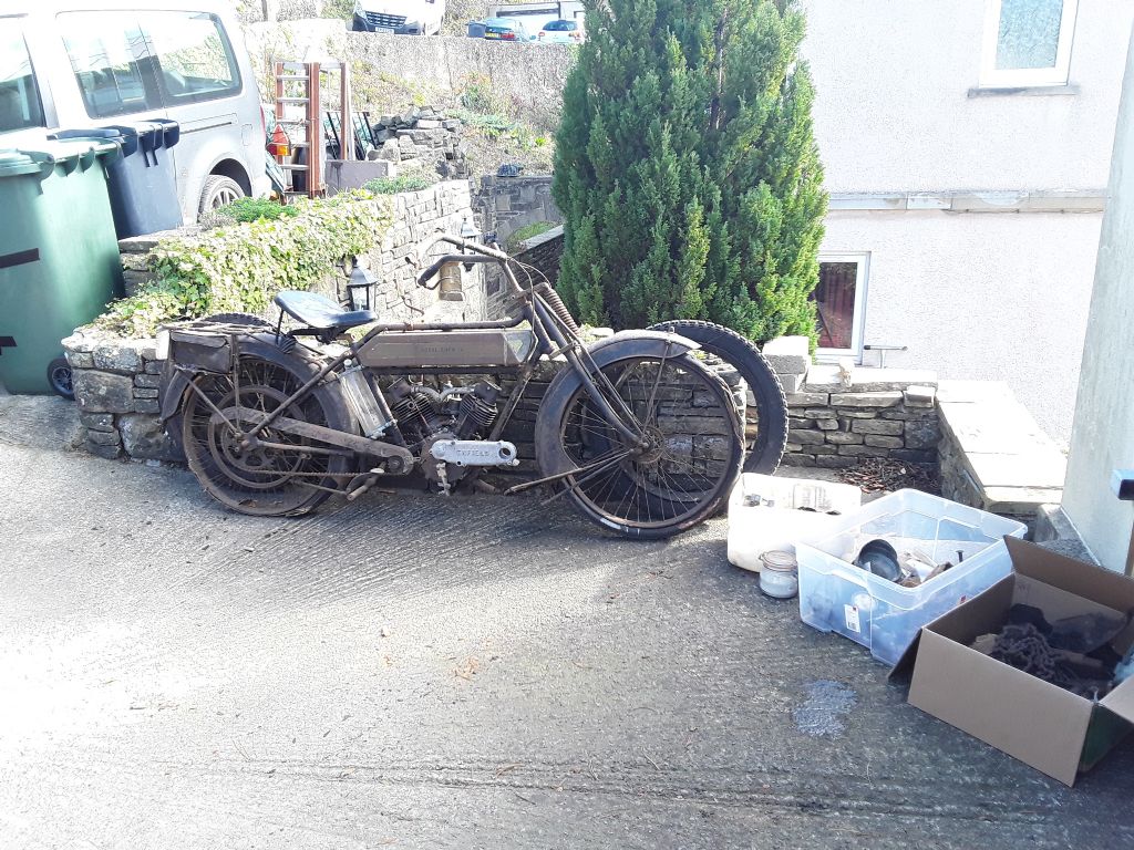

      I have a couple of Royal Enfield motorcycles, each in excess of 100 years old. In the course of the restorations (running concurrently), I need to make some compression fittings male and female for oil circulation lines. The thread count of the existing fittings is definitely 32 tpi, but the diameter is odd at 0.392" over the crest of the threads – suspiciously close to 10mm.
      Can anyone help as to whether this is from a recognised thread form/classification that I am unaware of, or maybe they're just a special fine thread that the manufacturers came up with. This is the only size/diameter other than standard Cycle thread in use on the bikes.

                                Thanks for all the responses folks – I'm beginning to think the thread is 10mm x 0.8 pitch, having tried a metric pitch guage now as well as an imperial one, as I can't see the difference over about 10 threads.
                                Frustratingly, I could retain all the original fittings I have, which are double ended, one end threading into the crankcase/oil tank/oil pump etc, the other end to a compression fitting of a missing oil line. However all the fittings I need are the compression nuts, so I'd have to screwcut these threads internally into a blind hole – not my favourite pastime!
                                I may remake the double ended male components 10mm x 0.8 pitch one side, and 26 tpi cycle the other, and make all the compression nuts 26 Cycle also. Would be happier using a tap up the nuts.
                                I specifically didn't include much motorbike detail as I thought the post may get moved, and the thread i/d was the important issue, however if I can remember how to attach a photo I'll put one up. I do have an RE with the Motosacoche engine (1912), but the bike in question is from 1915 and has Enfield's own in house engine with a totally different oiling system to the Swiss engined bike (dry sump recirc, rather than total loss – way ahead of it's time). Notice the GLASS oil tank.20221014_115717.jpg

                                  That’s quite something, Keith
                                  Thanks for sharing the photo.

                                          BTW, that is one beautiful old bike. Phenomenally well preserved and complete for that vintage. WOW! Will you preserve that original paint and patina or hide it under a layer of modern two-pack paint? The glass oil tank is unique. Maybe a step up from a glass drip oiler on a steam engine?
