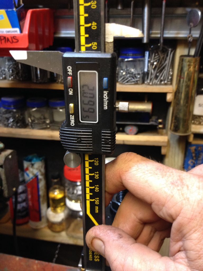

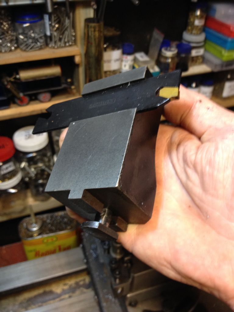

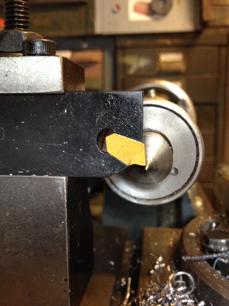

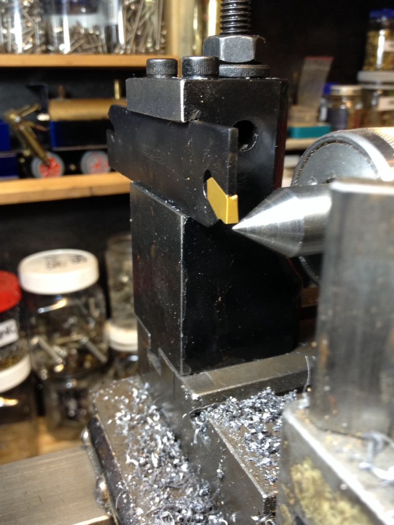

      image.jpgimage.jpgHi All
      I recently purchased a rear toolpost to solve my issues with parting off.
      It arrived from the UK, and works very well, but the tip of the parting insert sits about 2mm above centre, so work is not completely parted (it leaves around 4mm nipple).
      I've contacted the supplier and they've offered a refund or replacement, but I'll have to post it back, which is reasonably expensive and slow.
      Can someone let me know what the distance from top of cross slide to centre should be on an ML7 – I'm trying to work out if the issue is with my lathe or the toolpost. I've measured the distance from top of cross slide to parting tip and it's about 2.1".
      If the issue is the toolpost I'll get a replacement, if the issue is my lathe, I'll see if I can get a couple of mm milled off the base of the toolpost.

          If it's the tool post then milling it will make it right. If it's your lathe then milling the tool post will make it right. Seems to me the easy thing, and likely the right and fastest thing, would be to mill the tool post.

              As Peter has explained it does not matter which.To find your lathes centre height scratch a piece of flat bar supported upright with a square across the centre that you have mounted in your mandrel and then measure with your calipers.

                  I had cause to measure the centre height of my ML7 from the top of the cross-slide a few years back and I got it to be 2.0625".

                      Grind or file the top of the parting tool. When it is turned over for the rear tool post it will be lower. Just avoid the area close to the insert to avoid weakening it.

                        You do not need a milling machine for this job. Just mount the rear tool post sideways on the cross slide bottom face to the headstock and clamp it firmly ensuring it is square to the lathe axis. Check this by putting the face plate on and bring the bottom of the rear tool post firmly against it and tighten up. Then use a simple fly cutter (easily made) either in the 3 jaw or mounted on the face plate to remove the required amount of metal. It would be wise to take a bit more off than is calculated as the parting tool can easily be shimmed to get it at the best possible position.

                          The bottom of the toolpost isn't flat, so I can't face off 2mm in the 4 jaw.
                          I can't file the parting tool as it fits tightly in the slot in the toolpost.
                          I may be able to use a flycutter, will have to make one and have a try on some scrap first. I'm a bit nervous about taking some of the ridge which fits snugly in the slot on the cross slide.

                            File one side and pack the other to maintain the clamping effect.

                                I think the problem is caused by the fact the insert blade cuts at a lower (or when flipped higher) point compared to a HSS blade. As a temporary measure you could get a HSS blade while you figure out how to fit the carbide one in.

                                  You can cut off the bottom tongue and fly cut the base as suggested. You will just have to manually align the tool holder at ninety degrees with the machine axis.
                                  You could consider cutting a step in the inserted tool holder to lower it by the required 2mm. On reflection this would probably be the quickest and simplest answer.

                                      Well if what you are parting has a bore it leaves no pip, if it hasn't then just face it off,not ideal but if it works?
                                      My home made rear toolpost has the slot to hold cutter at a slight downward angle so by moving tool back or forwards centre height can be slightly adjusted up or down

                                        I don't think it's the wrong tool for the job Ian H – it looks exactly the same as my RTP set-up in fact.
                                        Grotto – I'd first ask the supplier to check their stock and see if the replacement was going to be any better.
                                        Easy enough to do – just measure from the bottom of the tool holder block to the lower edge of the tool slot and ask them to do the same on one of their stock items. If the two are the same – then there is not much point in sending for a replacement. If theirs is measurably shorter – then you have a duff item and should just replace it.
                                        If the replacement is going to have the same problem, then (in your circumstances) I'd ask for my money back.
                                        The base will be hard for you to machine without a mill or shaper because of the T-slot extension..
                                        One solution would be to just machine (fly-cut) the whole base flat and then replace the extension after machining with a bolt-on replacement piece but it's a lot of extra faffing around.
                                        "Lowering the lip" will also make the slot wider and then you may not be able to grip the insert holder securely enough. The lip also has a small dovetail machined in it that (without a mill) you may find difficult to machine, not least because it's on the lathe's centre line (or in your case – just above it).

                                              In answer to the OP's original question, and in case it comes in handy for anyone else, here's a scan from G.H.Thomas'  'The Model Engineer's Workshop Manual', page 240, Fig. 21.2, bottom RH corner.
                                              GHT recommended ML7 owners to make their own version of this diagram and keep it handy.  I followed that advice and found that my ML7 dimensions agreed with GHT's within 3 thou.
