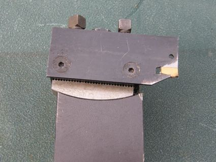

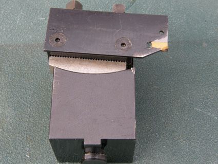

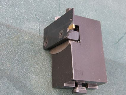

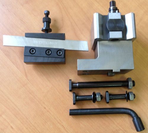

      Thanks for all the helpful comments.
      The parting tool, inserts, and toolpost were a package deal, so I don't think that changing the parting tool will fix the issue.
      Unfortunately I couldn't find a supplier here in NZ to get the item from, otherwise it would be easy to fix.
      I'll ask around and see if I can find someone local with a mill who can have a crack at it. I've been meaning to go along to the Model Engineering club for ages, so this is a good incentive.
      Supplier has offered a refund or exchange, but wants the toolpost back to see if it's out of spec., so can't really complain too much about service.
      It works very well despite being 2mm high, which surprised me, as 2mm off centre on the front tool post would not work at all.

        Have you tried using the other end of the parting tool holder? The notch may be in a slightly different position. Or a different carbide insert?

          It looks to be the same rear toolpost they use for their HSS parting blades so it's clear the fault is with the parting blade/tip.
          **LINK**
          I would buy a HSS blade locally and send them the parting blade holder and tip back for replacement at their cost or if you're determined to keep it all, I'd grind/draw-file the bottom 2mm off the told holder and make a fixture similar to the one in the above post to make up the missing 2mm of height in the holder.
          If you go the HSS route then I can thoroughly recommend the mod I made in the above post. I've parted 2" on the narrower 3/32" blade without any trouble at all and never put the old 5/32" blade back in.

              Howard Lewis
                @howardlewis46836
                What you seem to have here is an EXTREME example of Tolerance build up.
                The arguments about who / what is to blame do not solve the O P problem., and returns/replacement look to be costly and time consuming.
                It is unlkely that every toolpost / tool combination would set the tool tip exactly on the centreline of every Myford 7.
                If everything could be made that precisely, there would be no need for adjusting screws on Q C Ts would there?
                For what my advice is worth, hoping that you will only need to do it once for your lathe, this is my suggested way of dealing with the problem:
                1)Measure the height from the face of the Cross Slide to the Centre.
                2)Measure the height from the Cross Slide to the tip of the Parting Tool.
                3)Note the difference.
                4)Turn two dowels to snug fit in the T slot in the Cross Slide.
                5)On the centreline of the key in the bottom of the toolpost, drill / tap two holes, as far apart as practicable. Make them deep enough that the outer ends can be drilled / reamed, at the same positions to take the newly made dowels.
                6)Alternatively, drill / tap the rear face of the Toolpost., in two places, near to the bottom.
                7)Make up a bright M S plate, at least 6mm thick, and drill clearance for the fixings chosen for the above tappings.
                The plate should be made so that it hangs below the bottom of the Toolpost, to locate against the rear face of the Cross Slide..
                7)Set the toolpost in the four jaw chuck, as near on centre as possible.
                8)Face off the key,
                9)Turn off the lower face of the toolpost, the dimension noted earlier.
                10)After deburring, and cleaning, fit the two dowels, or the locating plate, to the Toolpost, and fit to the Cross Slide.
                The dowels, or the rear locating plate should bring the tool to the same alignment as the original key.
                The tip of the insert should now be at the lathe Centre Height.
                Do not be surprised if subsequent tips, especially if from another manufacturer, differ slightly from this Centre Height. Everything is made to dimension which has a tolerance.
                Tolerances allow interchangeability, but do not guarantee absolute precision.
                Heres to trouble free parting off!
                Howard

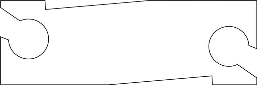

                #216328
                  This is just musing, but perhaps altering the parting tool something like this could drop the height by 2mm whilst keeping the fit in the toolholder. I have probably exaggerated the angle, and I realise that it will change the angles at the tooltip, but less work than modifying the holder.
                  parting.jpg.

                            Grotto
                              @grotto
                              Posted by Hopper on 14/12/2015 04:22:55:
                              Both ends give the same height unfortunately

                                Posted by Neil Wyatt on 14/12/2015 13:46:06:
                                parting.jpg.
                                I reckon this would be a good solution, but I'm not confident I'd get the angle/width exact enough. Maybe if I had more experience

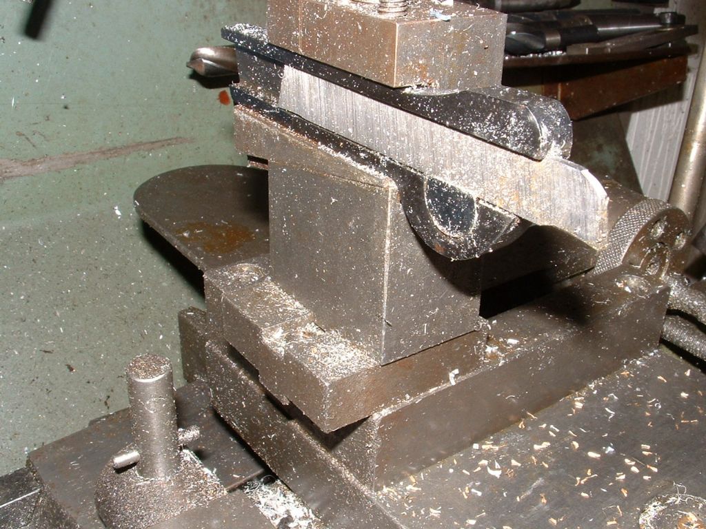

                                  Alan Jackson
                                    @alanjackson47790
                                    I made a base with a slope so that the upper part can slide to the right height.

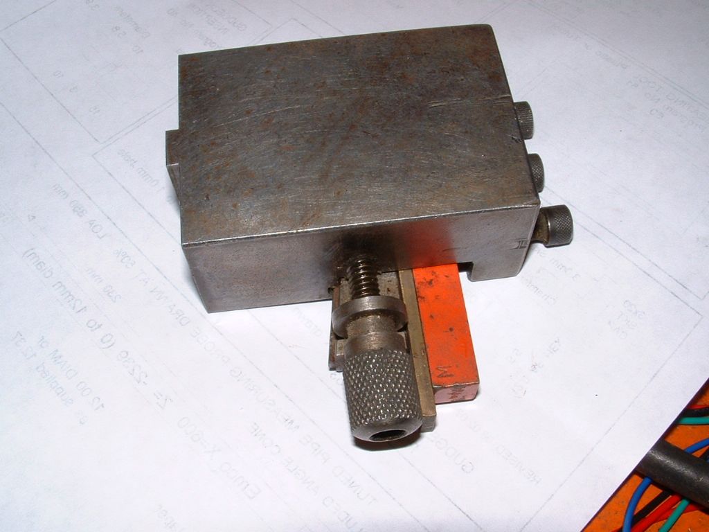

                                                  Emgee
                                                    @emgee
                                                    rtp adjuster.jpgThis RTP may be like Alans, made by a toolmaker many years ago, could have been from plans I'm not sure. I find it very useful for grooving and parting without problems.
                                                    2 more pictures in my Album.
                                                    Emgee
