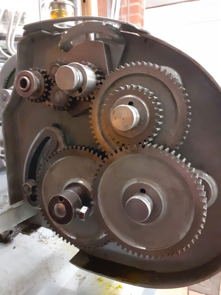

      lm a retired watchmaker & I've only ever used small watchmakers lathes but I've recently purchased a 1947 myford m series lathe I've almost finished rebuilding it but it seem the end of the lead-screw gear wheel is missing, dose anyone have a picture of the gear that fits on the end of the lead screw that meshes with the gear train, as I may have one in the boxes of spairs that came with the lathe? Just don't know what I'm looking for, thanks in advance of any help received

        #563108
          Good morning, Bill … and welcome
          If I understand your question correctly : the “end of the lead-screw gear wheel” is chosen from the set, according to what thread-pitch or feed-rate you need. … It is typically one of the larger tooth-counts.
          Lots of photos here: **LINK** http://www.lathes.co.uk/myford/

          #563110
          Howard Lewis
            @howardlewis46836
            Firstly, Welcome to the Forum.
            Don't be afraid to ask about anything. VAST amounts of experience on here, should you need it. And you can help mothers if they have a problem, to whichr you know the answer.
            If the M is like the early MLs, (1,2,3 and 4 ) the gears are driven from the mandrel, and on to the Leadscew by Driving Collars.
            This just a collar with a grubscrew to secure it to the mandrel, or Leadscrew, with a 3/32" hole part way through to take the pin that drives the gear.
            From memory, the grubscrew is 1/4 BSF
            If you have to use a compound gear, the two are coupled by a 3/32" pin in the same way
            So, IF this is the same arrangement as the ML4, you should have two Driving bCollars, and ideally four pins.
            Four because two will be needed for the Driving Collars and the other two in case you need to have two compound gears in the train.
            If you have not got the two Driving Collars, you can easily make them. They are only a simple turning job, the same thickness as a gear, probably 5/8" bore with the 1/4 BSF tapping and the 3/32 hole, drilled half way through..
            HTH
            Howard.
            #563128
            David George 1
              @davidgeorge1
              Hi William welcome to the forum.. I have an M Type and have loads of information on these and you can have a look in my albums for info or drop me a message. Here is a picture of the leadscrew drive.
              It uses a regular gear with pi and hole with a collar that has a hex head bolt that clamps into the slot milled into the stub shaft. If you are only having a single gear on this shaft there is a collar to adjust position.
              David
              #563240
              Bazyle
                @bazyle
                William has a picture in his album. I think he is missing the 2nd half of the dog clutch.
                #563244
                David George 1
                  @davidgeorge1
                  I think this is the missing part.
                  David
