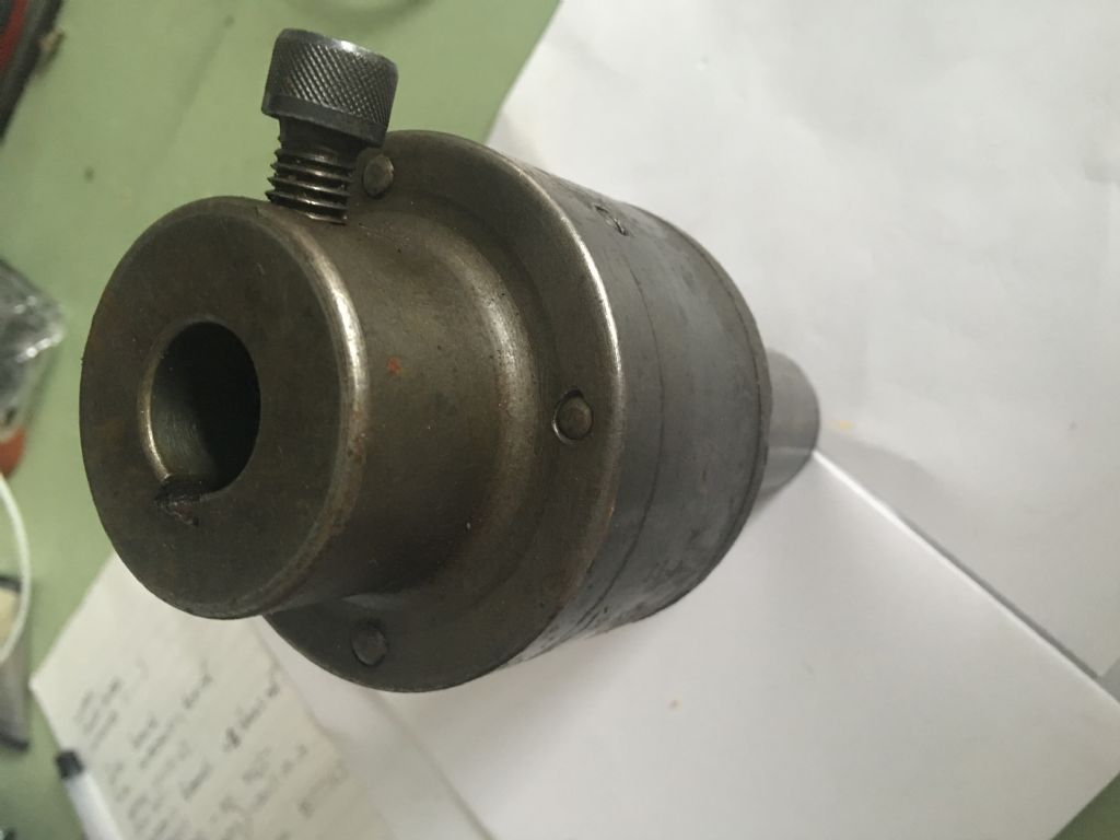

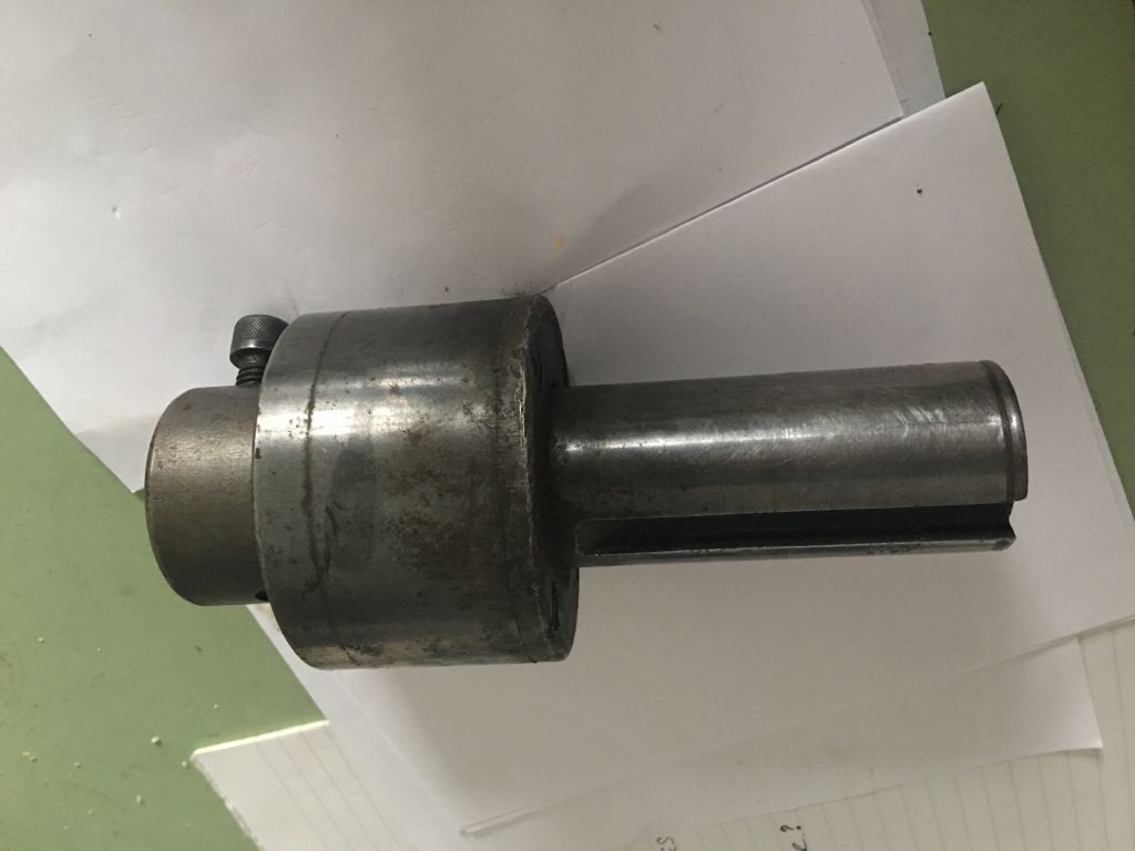

      So an Engineer I use in the area is retiring… >>
      He gave me a box of Coventry heads and this tool was part of the collection. >>
      When the head is pulled up it makes a 1/4 turn then locks but there is a little bit of play of 1/4 inch so not a precision tool.>>
      There is a spline on the back of the shaft and a dovetail spline in the head with a locking screw. >>
      I could go back to him and ask but then I would have to face the smug, lording it up which I suffer whenever I go and see him with a job which my modest machines cannot handle. >>
      Any help will be appreciated.

            #250834
            John Stevenson 1
              @johnstevenson1
              Looks like a self releasing tap holder. You may find that when it pulls out off the drive pegs it locks up on a roller clutch in one direction but runs free I’m the other direction.
              To use set it so at the tapping depth it pulls off the drive pegs and spins free. Once you reverse the lathe the clutch bites and winds the tap out.
              HTH
              #250837
              Daniel Robinson
                @danielrobinson12697
                Thanks for the quick responses everyone.
                John, this would fit in with it being in a box of Coventry heads. Thanks for the tip, I shall go and see if this will fit any of my machines…. That rear shaft is 1 ½ inches which is not something my Chip Master can accommodate
                Dan
                #250840
                Ady1
                  @ady1
                  The rear edge of the big end has taken a beating… loosening and extraction issues?
                  #250844
                  MW
                    @mw27036
                    It's clearly keywayed on the exterior and interior to prevent twisting so i'm gonna guess it's a tap/die holder of sorts, could even be the sliding head of a die holder. The back shoulder has clearly taken a clobbering as Ady1 said, probably to take it out after it got stuck in it's holder.

                      #250882
                      mick
                        @mick65121
                        It looks like a floating reamer holder for a capstan lathe but with dowel pins it obviously can't be, the key way stops whatever twisting, so at a guess perhaps it held a broach to produce a square or hexagon shape in a stationary component.
                        #251368
                        Howard Lewis
                          @howardlewis46836
                          If you do want to use it, why not make an adaptor to carry it, with a suitable taper to fit the Tailstock mandrel?
                          Or even more radical, mount it in a 4 Jaw , clock it for the shank to run true, and then reduce the diameter to something that your lathe can accept?
