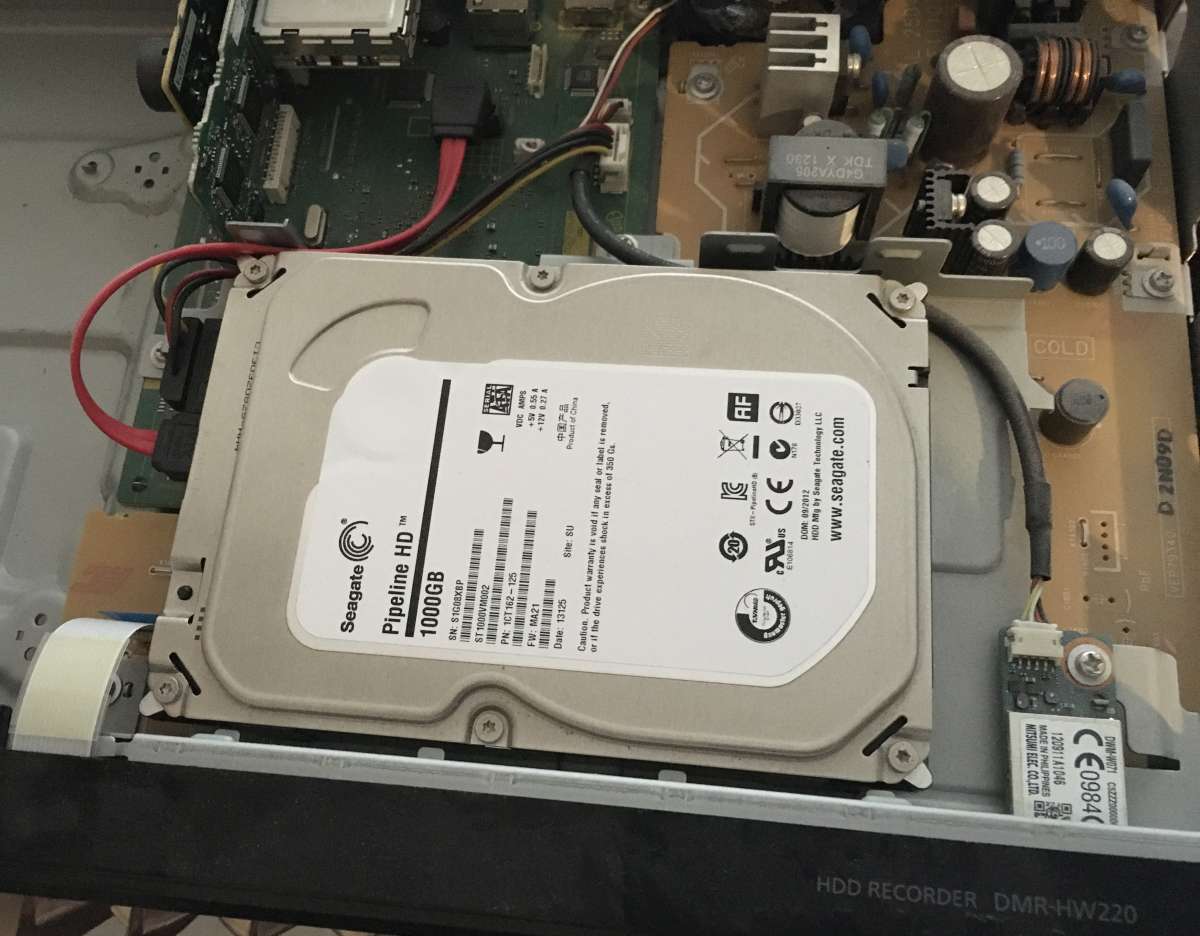

                          #837396
                            At first sight this should have been a straightforward disk-swap:
                            IMG_1423
                            IMG_1422
                            … but Panasonic plays a different game 🙁
                            #837398
                              For the curious …

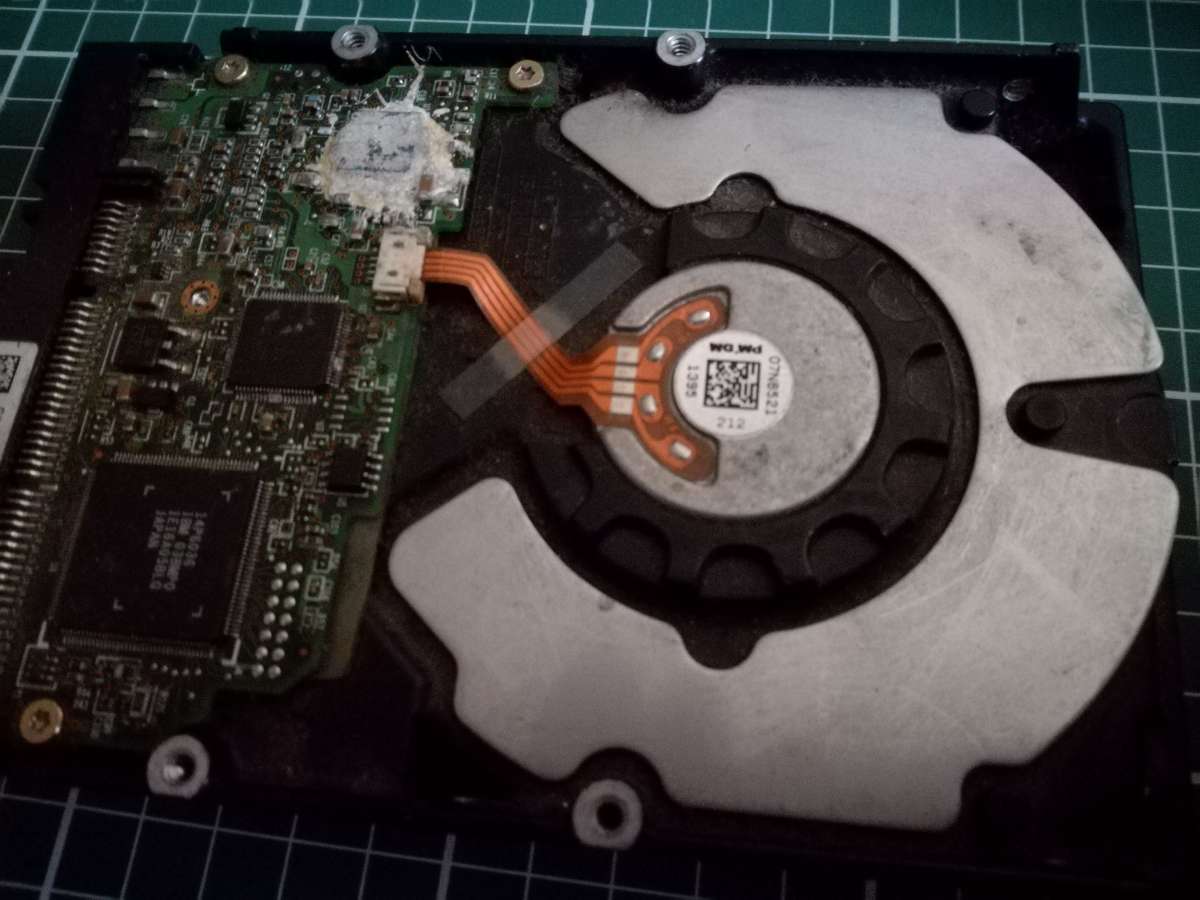

                                #837413
                                Nicholas Farr
                                  @nicholasfarr14254
                                  Hi, they are wonderful things, until they go wrong, I once had one in a desktop that would start-up Windows, but then it froze, shut it down and waited a short while and gave it another go, same thing happened, I gave the desktop a clout, like you used to do with the old TV years ago, and the hard drive would wake up again, for a while. I ended up putting it into a slave position, and had to keep tapping it every now and then, to save all the data, which took a while to do, and got almost all of it transferred, what was left didn’t matter.
                                  I then had another one sometime later that started Windows up, and just as I went to use it, it just went off, so left that a while and restarted it, and again the same thing happened, turn out there was a chip on the board that was getting hot, so with a splodge of heat transfer compound and a strip 1mm thick copper attached to it, I managed to get all the data of that one. You can see in the photo below the one that was getting hot.
                                  IMG_20260213_120915
                                  This is an IBM Deskstar with a 20 GB capacity, but I don’t know if it will still work.
                                  Regards Nick.
