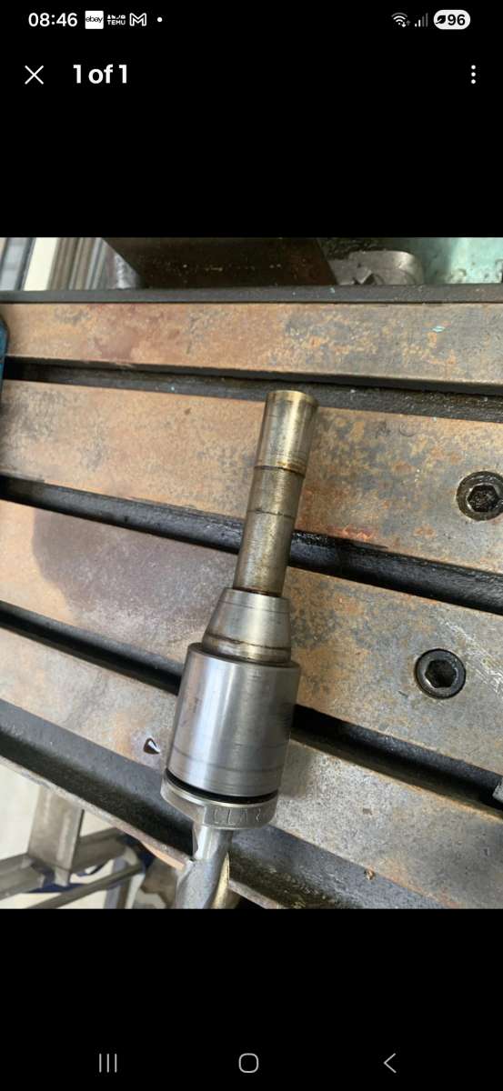

      Can anyone recommend a place to get a morse taper cut into the existing spindle of my herbert ov milling machine. The current taper is similar to R8 but impossible to find tooling for nowScreenshot_20260327_084633_eBay

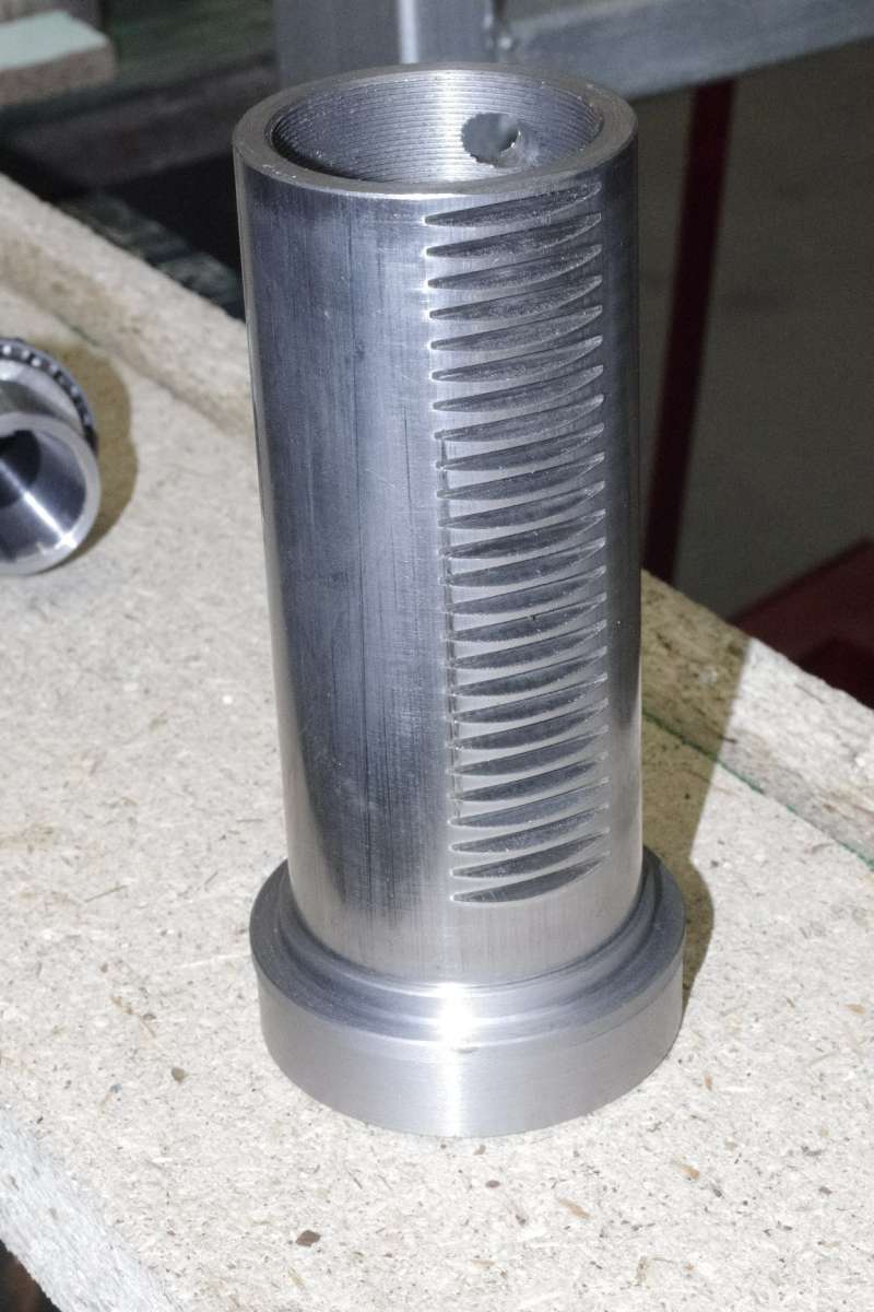

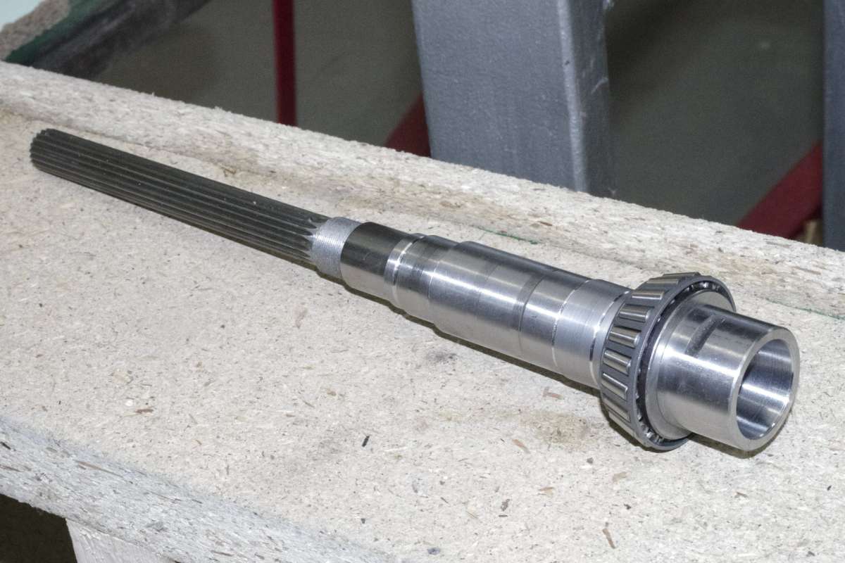

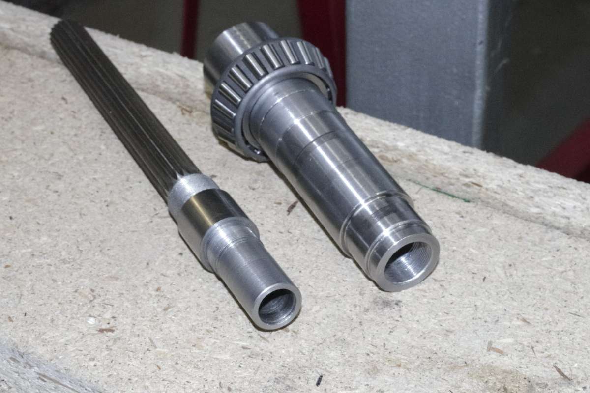

                  I made a new spindle for my Herbert 0V, used tapered rollers rather than the ball bearing arrangement.  I made the new spindle with a 4 morse taper.  I think that is better than the R8 taper, a better (more rigid) connexion between spindle and cutter/chuck and no weak key.  The 4MT allows larger milling cutters and drills to be used, something the 0V is quite capable of using effectively.
                  Getting back to machining a new taper into the spindle, its hard but not hard enough to trouble carbide tooling.  Problem will be the size of taper.  3MT is too small, the bore of the spindle is too big.   A 4MT would be too big, spindle not big enough in outside diameter.  The attached photo shows this.  (Herbert spindle [bottom half!] on the left, 4MT on the right).  A new spindle is thee way forward.
                  Whatever taper is chosen, I would finish it on the machine to ensure absolute accuracy.  Assemble the spindle into the head, clamp a boring bore vertically on the work table.  Tip the head over to the half the taper angle.  Lift the worktable to machine the taper.

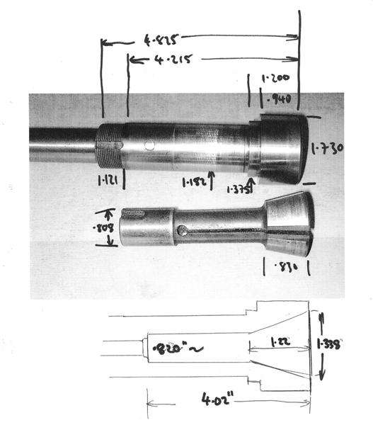

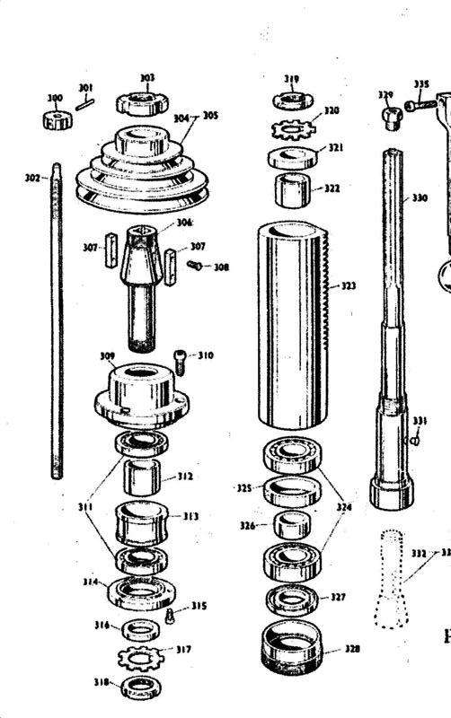

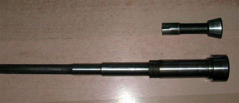

                        It was my Herbert 0V that was converted to R8 by the late (but still great) John Stevenson. He drew up the two collets to compare them and said that he could do it by boring the spindle taper to be parallel then shrinking a slug of EN24 (I think) into it and then cutting the R8 taper into that. This is exactly what he did. He also made a 7/16″ drawbar ever so slightly smaller to fit down the spindle but still draw in the R8 collets.
                        Here are some pics you might find useful:
                        colletcompare
                        millspindle
                        millspindle01
                        spindleassy

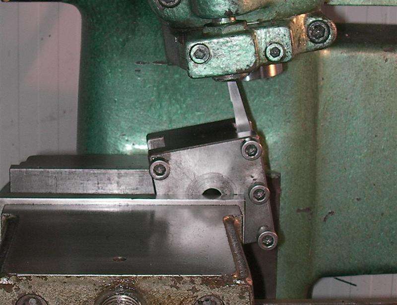

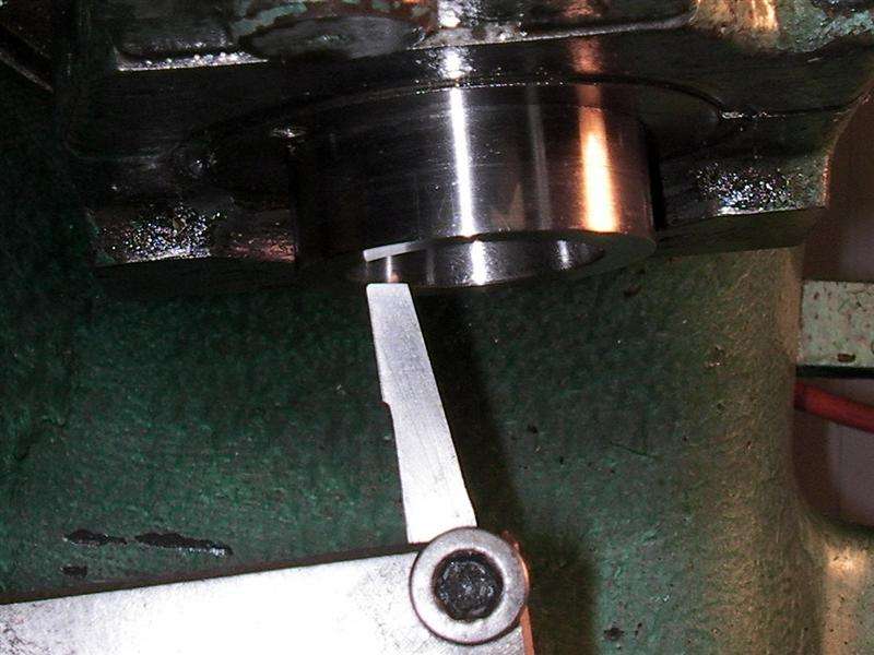

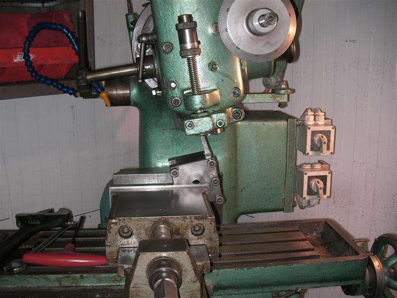

                          Truing the taper was actually very easy. I just tilted the head over to the R8 taper angle, set a lathe toolpost on the table with a HSS tool on the centre line of the spindle and used the knee to turn the taper with the motor running. It worked a treat.
                          truespindle02truespindle01truespindle03

                              Looking at the drawing showing the conversion to R8 collets.  I think that it is not only unnecessary, but undesirable to fit a sleeve inside the spindle nose.  Putting a rule across the business end of the Herbert spindle, it looks very much like there is enough metal to do the job without sleeving.  It would mean that the collet would sit deeper into the spindle so the spindle nose can be usefully shortened.  With the 4MT spindle I made I gained around 1/2″ extra height on the Z axis simply by making the overhang from the bearing as small as possible, a point missed by a previous poster.  That 1/2″ might not seem much, but its been a “lifesaver” on several occasions.
                              (Later,I modded the Z axis feed screw nut to give another 2″ of space under the quill, and still seemed able to use up all the available travel!).
                              I would urge the OP to steer clear of R8 collets, as I said before, too restrictive on cutter size.  The 0V is a very rigid machine capable of shifting metal quickly and accurately, R8’s would restrict the machines performance.

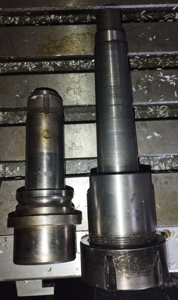

                                          I suppose the other thing to consider is the availability of R8 vs MT4 shank tooling. If you want to be useing ER colets, shell mill holders, saw holders, boring heads, etc then R8 is likely to be more plentiful. Though if you are the type that likes making tools doing your own with 1″ parallel shanks to fit a MT4 collet will be easier than replicating R8.
