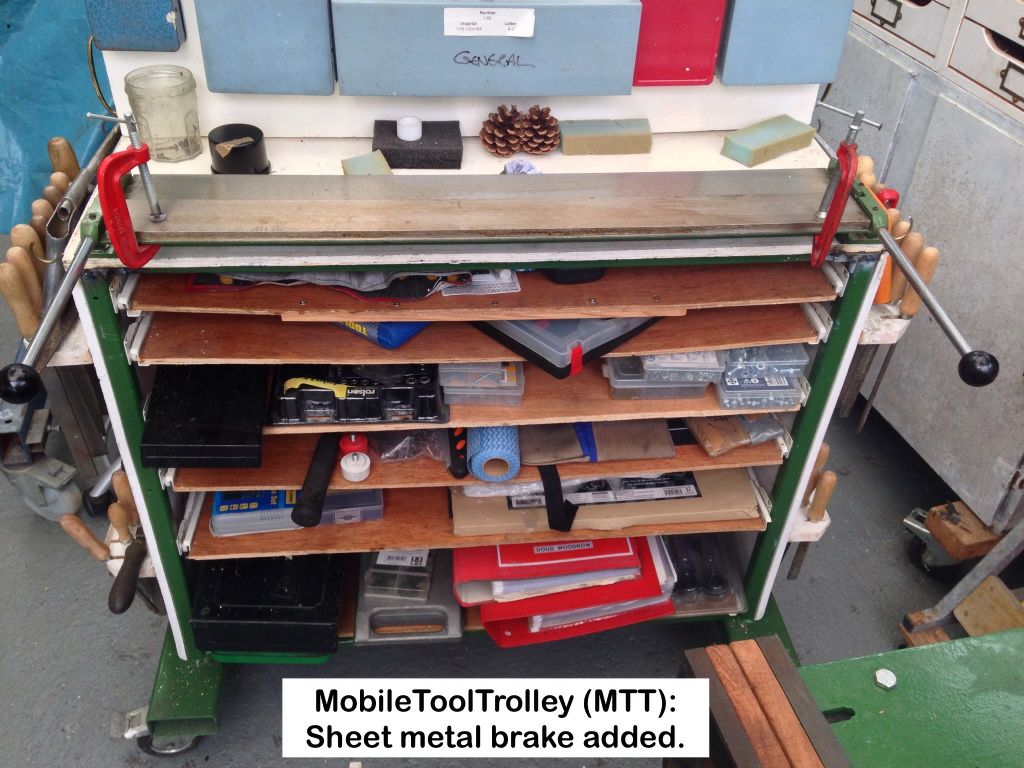

              MTT has an addition in the form of a 30" Mighty Mini Bender.
              Its first use will be in making a replacement for the bottom part of the Austin Seven's B-post that has rusted away, then well and truly bodged and the 'best' I've ever seen.
