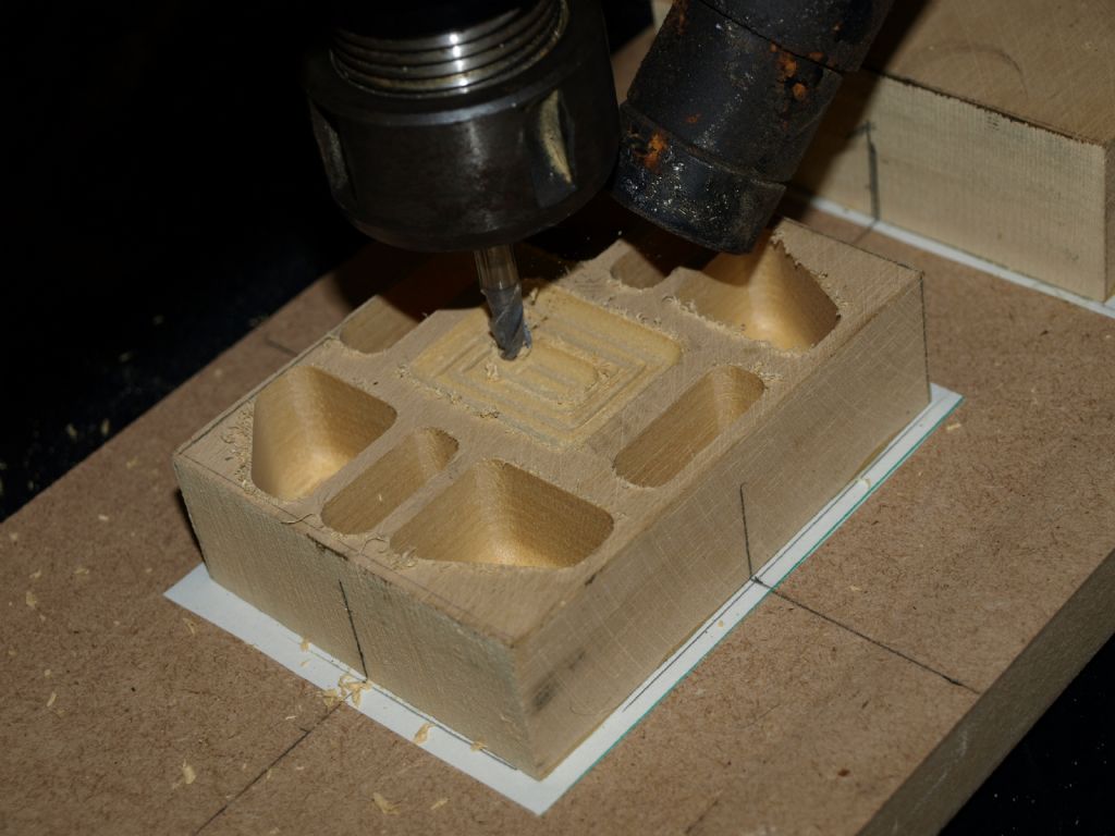

                    #86564
                    KWIL
                      @kwil
                      Milling Wood
                      Forget you are routing! With routing you aim to remove as much wood as you can achieve in a single pass. Pic is real, where is the dust? In the extractor as it happens. Take it easy, cutter is at 2000RPM Depth of cut 1mm.
