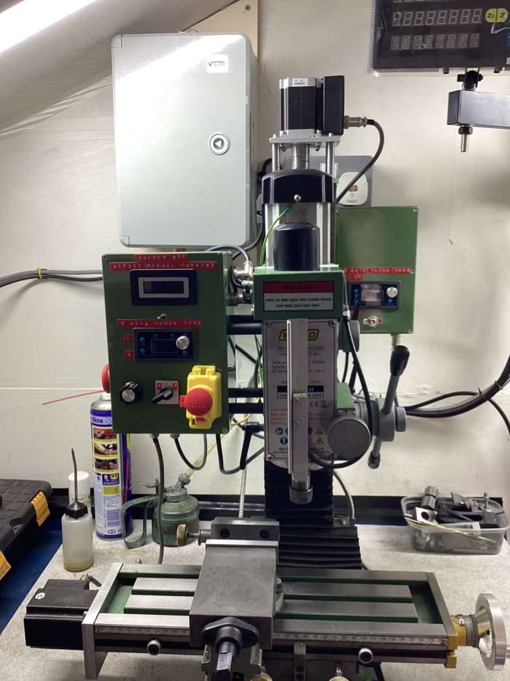

                                Dell
                                  @dell
                                  I have Warco’s smallest mill WM12 I purchased it initially for clock plate bushing because it was half the price of a dedicated bushing tool but can do so much more, I have since made lots of tooling for my & others Pultra lathe IE tool rests, fixed steady’s, T bolts amongst other tooling, I have also made plenty of modifications to the mill fitted 3 axis DRO, powered X axis, powered Z axis, belt drive conversion so mush smoother & quieter & most recently converted to brushless motor due to intermittent fault so now I have forward & reverse so I can & have power tapped.
                                  The reason for some of the mods were due to having gout in both hands so I struggle to hold & turn handles for any length of time, although it is a small mill I find it quite capable for the jobs I do on it but if I had mor room I probably would have gone for the 16 although when I purchased my mill they didn’t do belt drive.
                                  Dell
