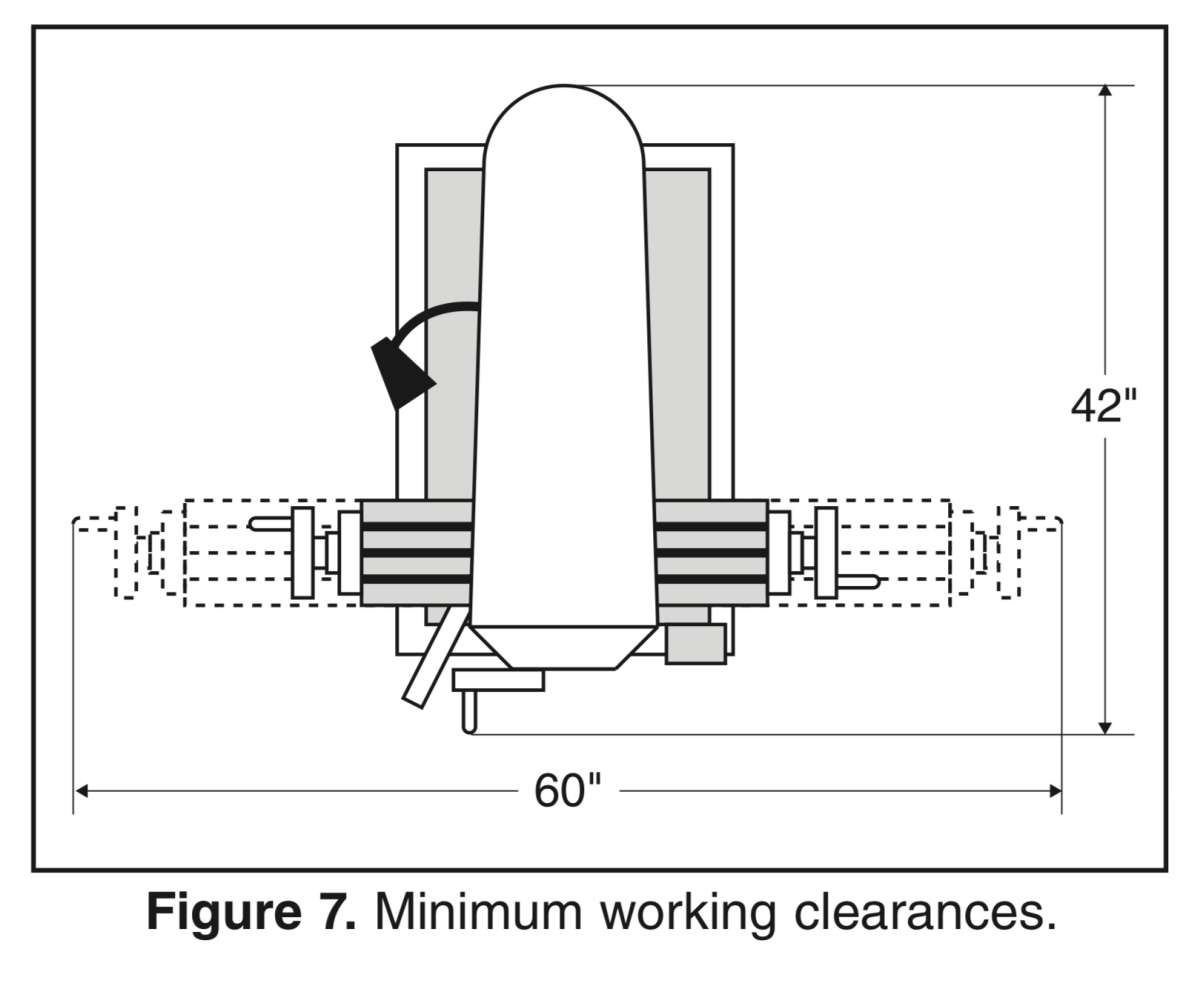

                                                  If you have CAD and are reasonably skilled it may be worth doing a space diagram to verify that the mill you intend to buy actually has enough room to easily handle the jobs you propose to do.
                                                  Continually working around insufficient space is a truly miserable experience.
                                                  I got rid of my first two mills, a BCA and large size square column import, and went up to a Bridgeport purely for space reasons. The square column mill was largely equal to the Bridgeport in stiffness and machining capacity but it simply lacked space to easily handle the work I ended up doing
                                                  Which ended up rather different than I originally planned! Turned out I’m not a model maker. Happy being Home Shop Guy working in 12 inch to the foot scale.
                                                  As David Halford mentioned above the gotcha with a mill is that everything has to fit inside the work envelope so once you’ve added work holding underneath and tooling stick out on top the actual room for the job is a lot less. Don’t underestimate setting up space. Much easier if you can crank things sideways enough so you don’t have to work under the head. Probably the thing that really confirmed that I had to go up to a Bridgeport form my short table square column one where setting up had to be done under the head rather than out to one side then crank back.
                                                    Clive
                                                    Before I bought my Warco VMC I downloaded a manual of the type somewhere and it included a diagram of the working envelope with all the sizes. Easy to scan and drop into a plan of my workshop.
                                                    IMG_1942
