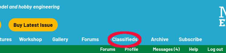

        … I have about 1.2 m of worktop cleared for the mill and a large cabinet for tooling. I would consider a used machine at a fair price as my budget would go further. I understand about the clearance etc and once vices and clamps are introduced that this is drastically reduced, so perhaps a used machine is the way to go. I cant seem to find the classified on the site to see if any are advertised, but i will have a search.
        Classifieds are accessed via the Blue Banner top of page:
        classifieds
        There’s a WM16B on offer at the moment, asking price £1500, location Falkirk.
