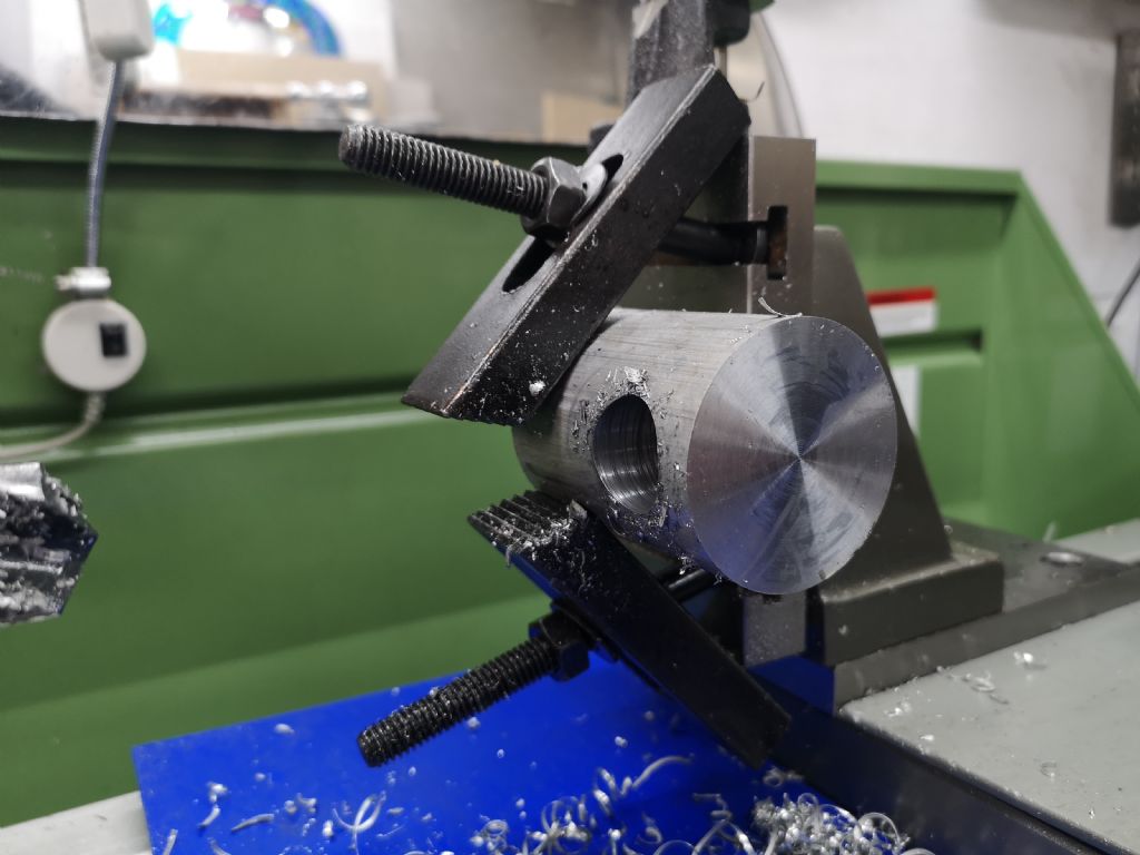

                    Terry Kirkup
                      @terrykirkup37827
                      Oldpedagog – I bought this from Warco when I got my lathe, and ever since the noble gentry on here put me right on saf(er) workholding I get my small milling jobs done quite easily. Ignore this particular instance (I do better now) as it is what got me all the good advice! You can just see the vertical milling slide, cast angle plate and the baseplate to go with it which fixes to the cross slide. I also got their small vise which mounts on the front of the slide but it won't hold most of my work.
                      Edited By Terry Kirkup on 13/03/2021 15:10:50

                        #533771
                        Terry Kirkup
                          @terrykirkup37827
                          Bo'sun absolutely right, so annoying and so restrictive for normal turning/facing operations with the slide in the way and the "unexpected" need for swapping has had me cursing many a time, hence my name is now on a list for a mill!
