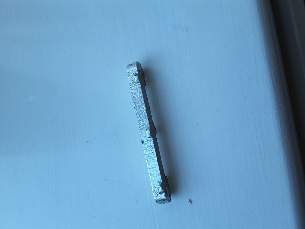

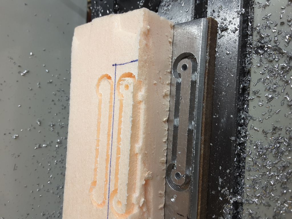

      I've just got back to machining a few bits after a break of a few years and I would appreciate a bit of advice from those with more experience than myself.
      One of my projects involved CNC Milling the part out which is in the attached photograph. My feeds and speeds were a bit on the industrial side (1.25mm doc, 80mm/min feed rate, 6,000rpm with a 2 flute 3mm slot drill, cutting 5mm deep in aluminium) for my KX1 mill as it did vibrate noticeably. I'll reduce the depth of cut and feed rate a little for the next try.
      My question related to slot milling, when I cut out in similiar profiles in aluminium, what would an appropriate cutter size be? Also would I be better cutting the slot width in more than one pass, i.e. cutting further out and then an finishing pass to bring the profile to size. The cut finish with cutting the 3mm slot with a 3mm slot drill was very poor.

          As you don't really want the slot but the part surrounded by it a cutter with more flutes would be one option to getting a better finish though you could also consider an aluminium specific cutter which would have 2-flutes like a slot drill but with a different helix angle to help clear swarf.
          On a contour cut you would be better setting a final shallow finish cut only when full depth has been reached, use climb cutting and some lubrication such as paraffin.
          A small cutter will always be more likely to chatter so consider using a larger diameter one and maybe two setups, the first to drill the holes and then a second setup with the work screwed to a block of scrap material then you could do the cut in a series of full height passes working in towards the final contour, this will give more even wear to the cutter rather than just using the end. Your internal fillet where the straight meets the rounded end will be the determining factor here as to how large you can go.
          Assuming your cutter is carbide I would have used your max 7000rpm and feed at least 50% faster.

                Was your cutter sharp as there are a lot of burrs, is it really soft Aluminium? As with all machining you get a better job using roughing cuts then a finish cut with a nice sharp tool/cutter, use lube & climb mill.

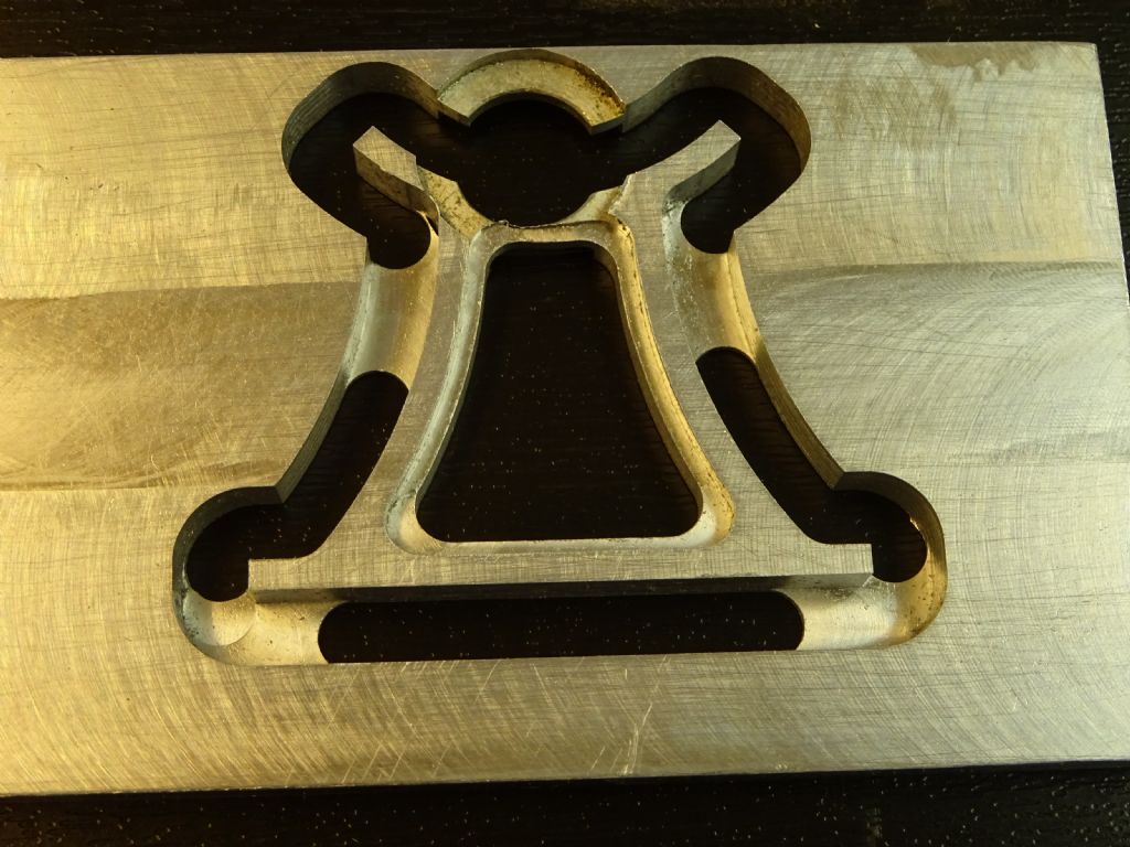

                  I'd agree with Jason. I'd drill the two holes on the manual mill, screw to a fixture on the CNC mill and then profile the outside with a 3-flute 6mm cutter, full depth, 7000rpm, 400mm/min and 3mm width of cut. I normally leave around 0.5mm when roughing and then a full depth finish pass. For roughing I use climb and conventional milling, for finishing mostly climb. If the small concave radii can't be designed out I'd re-machine them after profiling with a smaller cutter. Make the cutter smaller than the radius to be machined or the cutter will chatter.
                  Generally I avoid slotting where possible. Even with flood coolant it's a PITA to clear the swarf and nothing fudges the cutter and finish quicker than recutting swarf. Another issue with slotting is the use of bridges. When I have to use them I make them 0.5mm high maximum. But they're still a pain to clean up. It can be easier to start with material slightly thicker than needed, profile the part, turn over and face off the unwanted material.
                  These parts are steel, but show the sort of finish that is possible with a hobby CNC mill:
                  Andrew
                  #463173

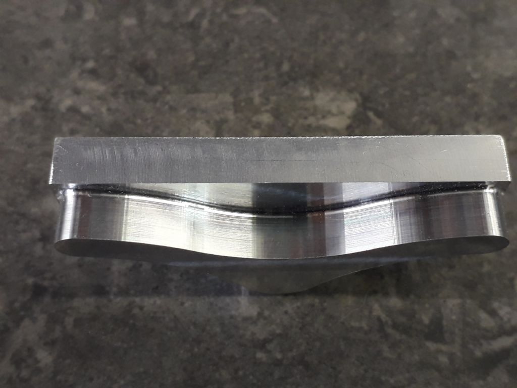

                    Like Andrew I don't use the method much but this is something I did soon after getting the KX-3, think the mill was still sat on the pallet and code done with Vectric. 6mm dia 3-flute HSS cutter, 3000rpm, 150mm/min feed doing 6 passes 1mm deep for each in teh 6mm material, no finish pass as I did not know any better at the time. Few blasts of air to keep chips out of teh cut and a little paraffin gave a good crisp edge and decent surface ( ignore the hold hole at the top in the scrap material)
                    And the sort of finish you can get on aluminium, this was roughed and finished at full depth.

                            This is one I have done this morning material is 6082, cutter a carbide 10mm aluminium specific one from ARC running at 4000rpm, feed 300mm/min, 0.5mm depth of cut from just outside the sawn shape and a final 0.25mm finish pass that was run again at thesame setting just incase there was any spring in the tool ( was not needed) Probably a bit boring to watch it all but the reflection of my finger at the end shows what finish you should be able to get. The other advantage of doing it like this is most of the swarf gets thrown clear.
