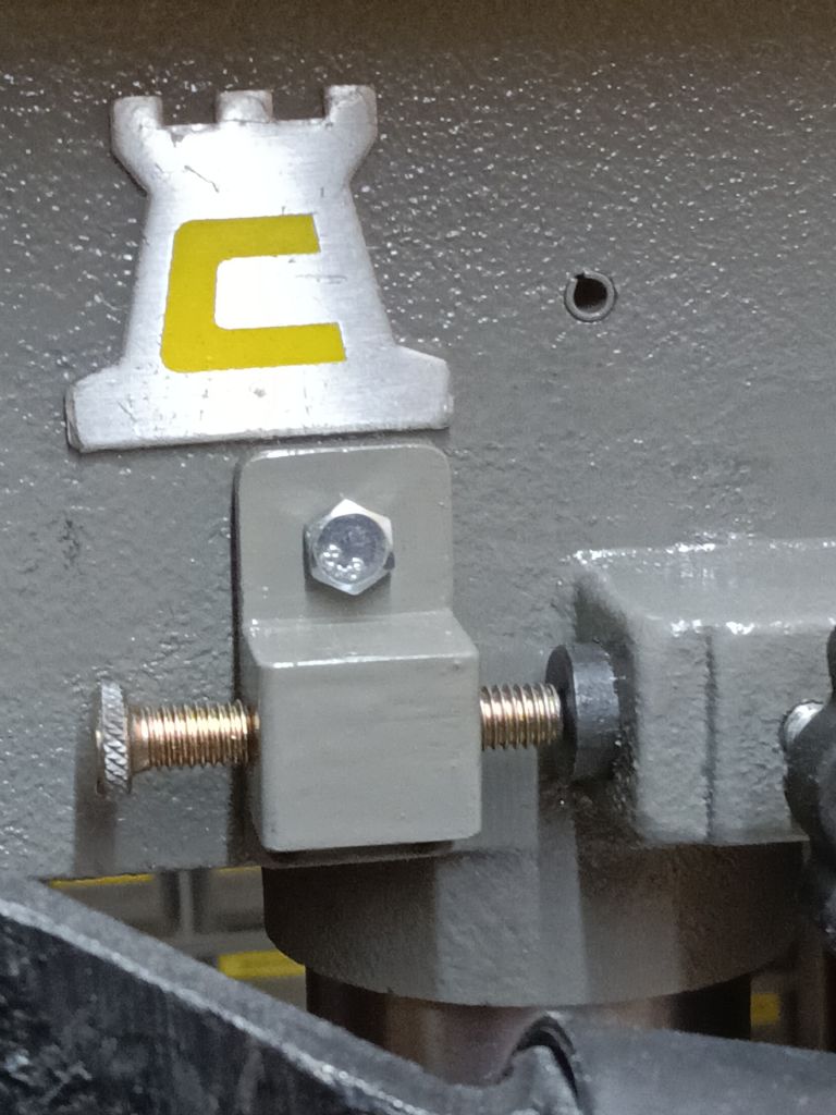

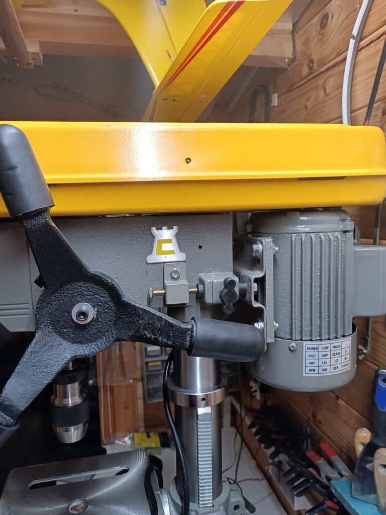

                          As Jason said the headroom is one problem, I used a Sieg SX2 a long time for drilling, but is is annoying to change from drill chuck to collet holder or vice versa. And if you have the collet holder in you can of course drill but for every change of drill bit you have to change collet…
                          In the end I invested in a Chester bench drill D13R. With 235£ it doesn't burn a massive hole into the pocket. But it had its little issues, the v-belt it came with was so tight that it was almost impossible to change gears. Especially as the machine is quite tall, so if you have it standing on a 90cm work top you can hardly see what you are doing. (I am 186 cm (or 6'1&quot tall) I changed the belt to a size bigger and the problem was solved. Next problem was the belt tightening mechanism which was very basic and opened itself due to vibration, so I added a screw (on both sides) to tighten the belt.
                          Belt tensioner

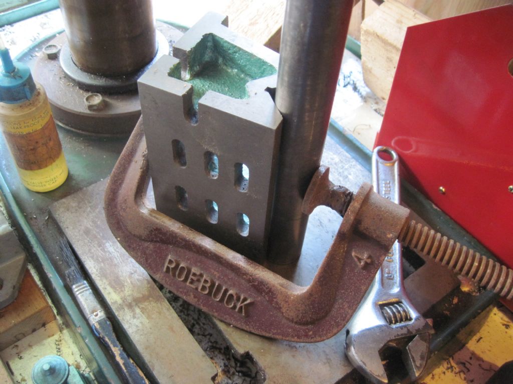

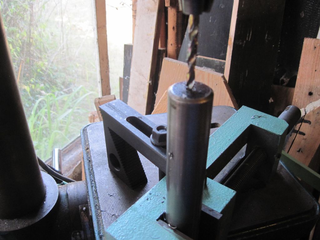

                                If you are limited by space or money and the work is small, then a small mill is fine for many things. But it's nice to have a choice of machine to use if you can afford & house them.
                                For example – end drilling a shaft. Could have done this in the lathe or (horizontal) mill with some bodging – but it was quicker and more convenient in the drill press. Most verticals would not have the headroom. As others have mentioned, a drill press is very handy for woodworking too…
                                Shaft was about 20" long and 1.5" diameter from memory.
                                Bottom support using V-Angle plate….(find mine to be very versatile)
                                Shaft End Drilling - bottom
                                Top end of shaft held in vice clamped to the table (which was swung to one side)
                                Shaft End Drilling - top
