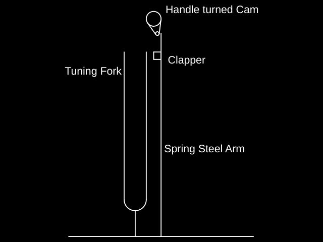

                                    #587327
                                      Something like this maybe:
                                      When the cam is turned it pushes the spring arm away from the tuning fork until the apex of the cam is passed. Then the arm springs back and dings the clapper into the tuning fork. Simplest arrangement is with a straight spring arm but a rigid arm could be hinged and powered with a coil spring, opposing super-magnets, or an elastic band.
                                      Devil as always is in the detail:
                                      • Cam has to be positioned to bend the spring enough to deliver a suitably hard whack
                                      • Clapper has to be positioned so it only hits the fork once and doesn't bounce repeatedly
                                      • Cam shape determines the exact trigger characteristic (but I don't think it's critical)
                                      • Cam might be better positioned in line with the arm, or near the bottom, so it can be turned either way.
                                      Meccano is quite good for testing experimental set-ups.

                                        #587413
                                        An Mich Kotzelbaum
                                          @anmichkotzelbaum85502
                                          Wow, so many inputs. Thank you all!
                                          I like all your ideas, i already started to make some prototypes, thanks God it's sunday

                                            #587634
                                            An Mich Kotzelbaum
                                              I surely will! I started to assemble something like SillyOldDuffer suggested, but i must find a thicker spring arm. Yes, it's all a matter of experimenting different things by now, i never dealt with springs in a qualitative way, it's a good project to get a feeling about it!
                                              Thanks again to all of you!
