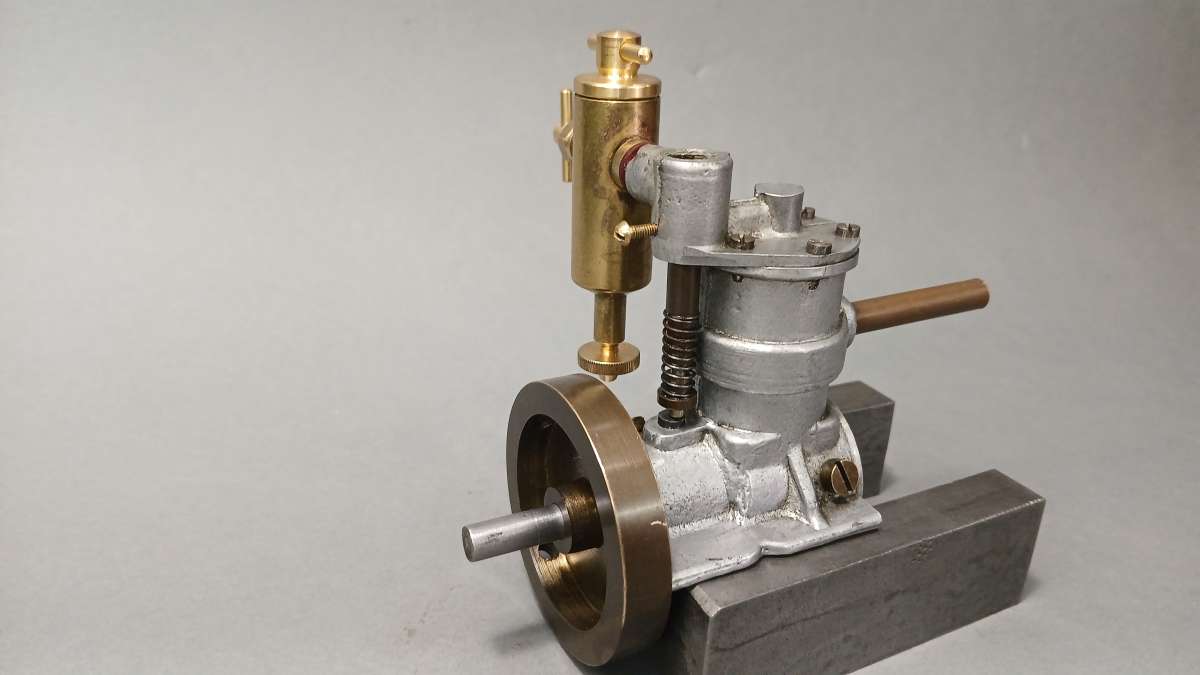

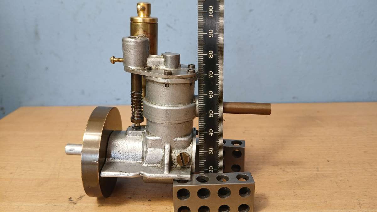

      I was just wondering if any member has a copy of the above mag which was dated 1st feb 1923.
      I have an engine on it’s way that is a non runner and believe it gets a mention on page 116 as part of the write up of the ME Exhibition. A scan or photo would be most helpful.
      It is the “G 1 Uniflow” high-speed Dynamo Engine. by Jackson-Rigby Engineering Co Ltd

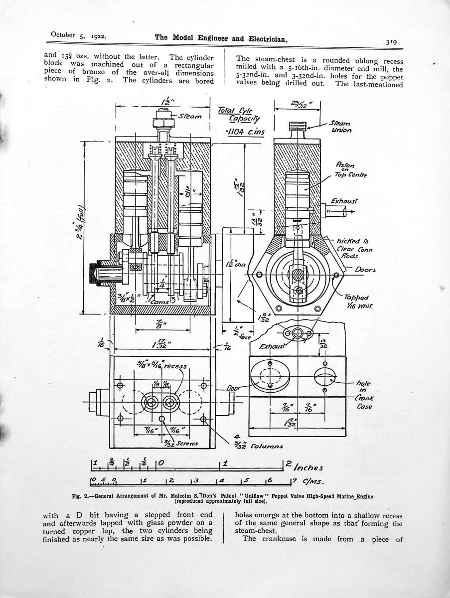

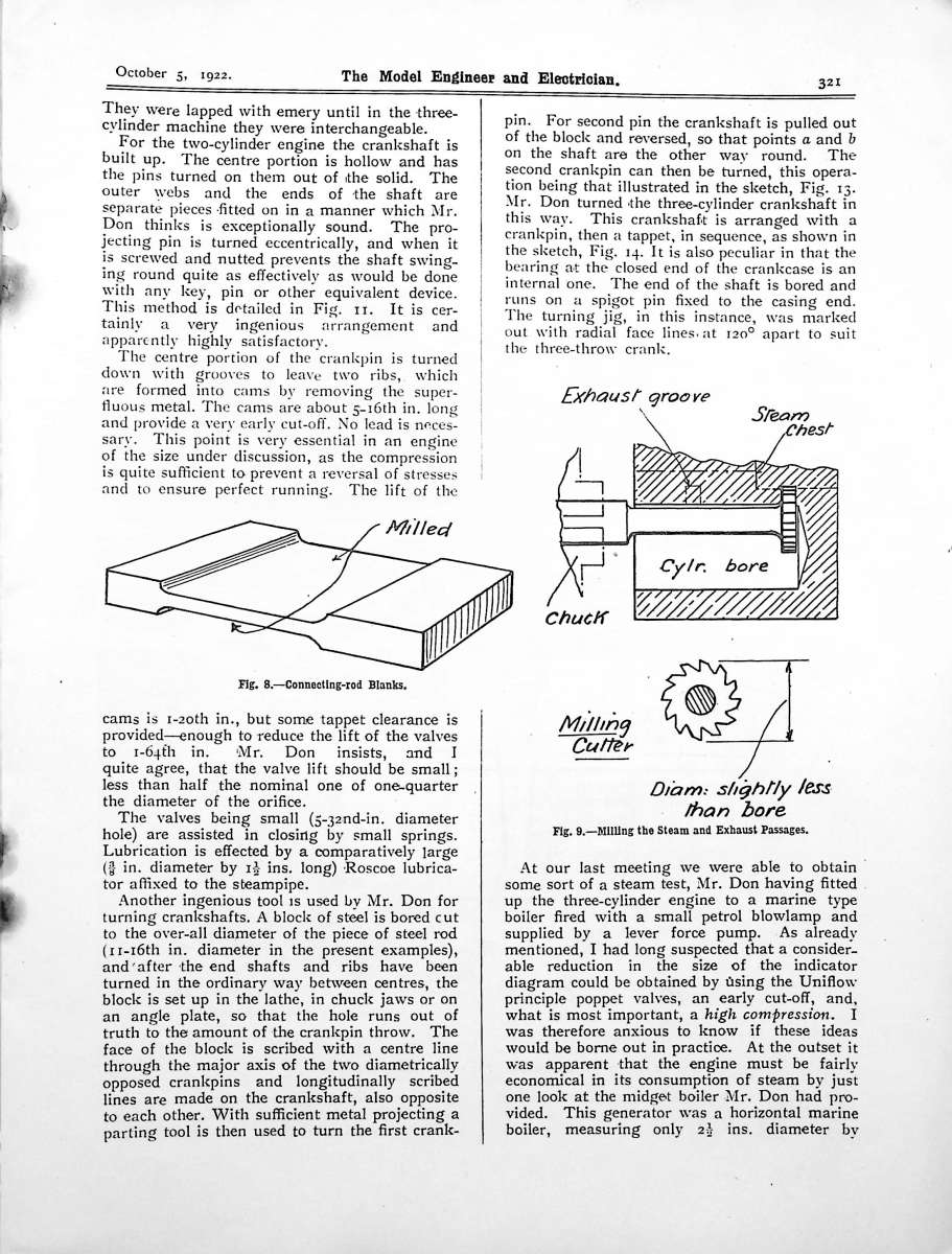

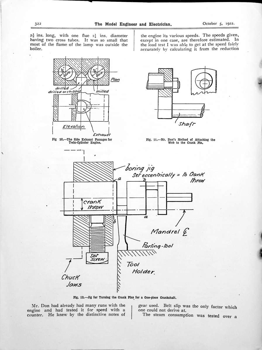

                David Senior
                  @davidsenior29320

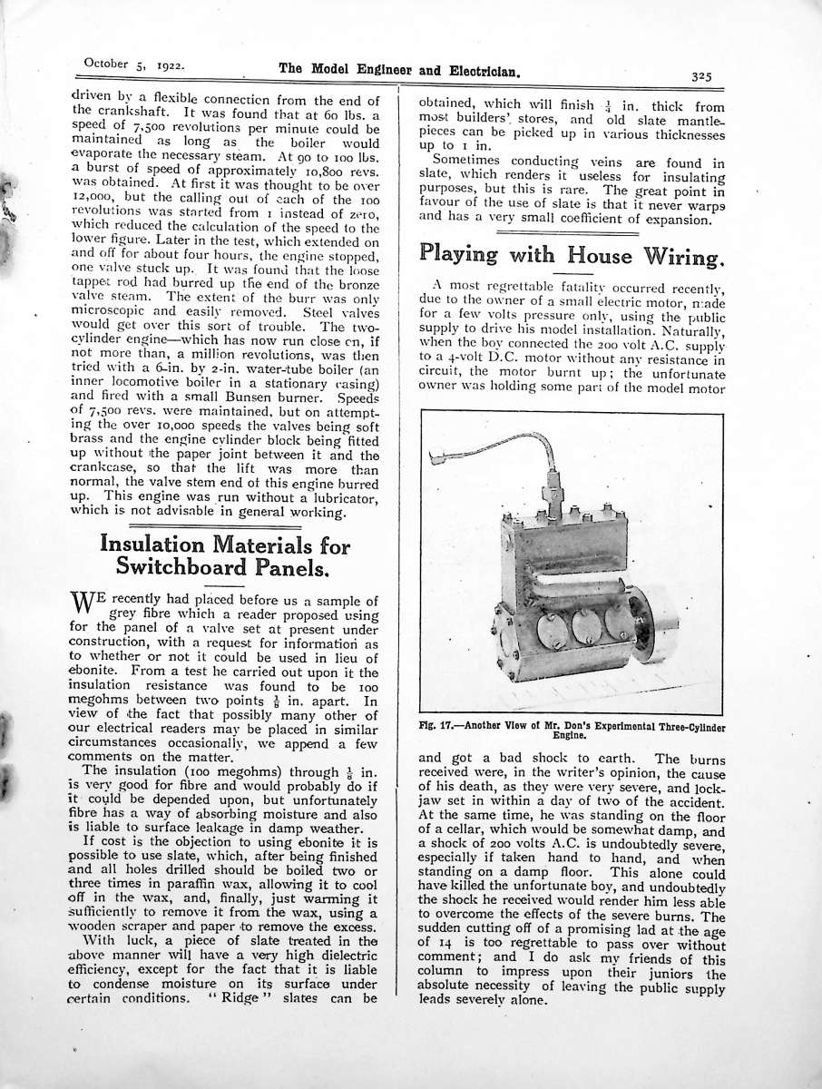

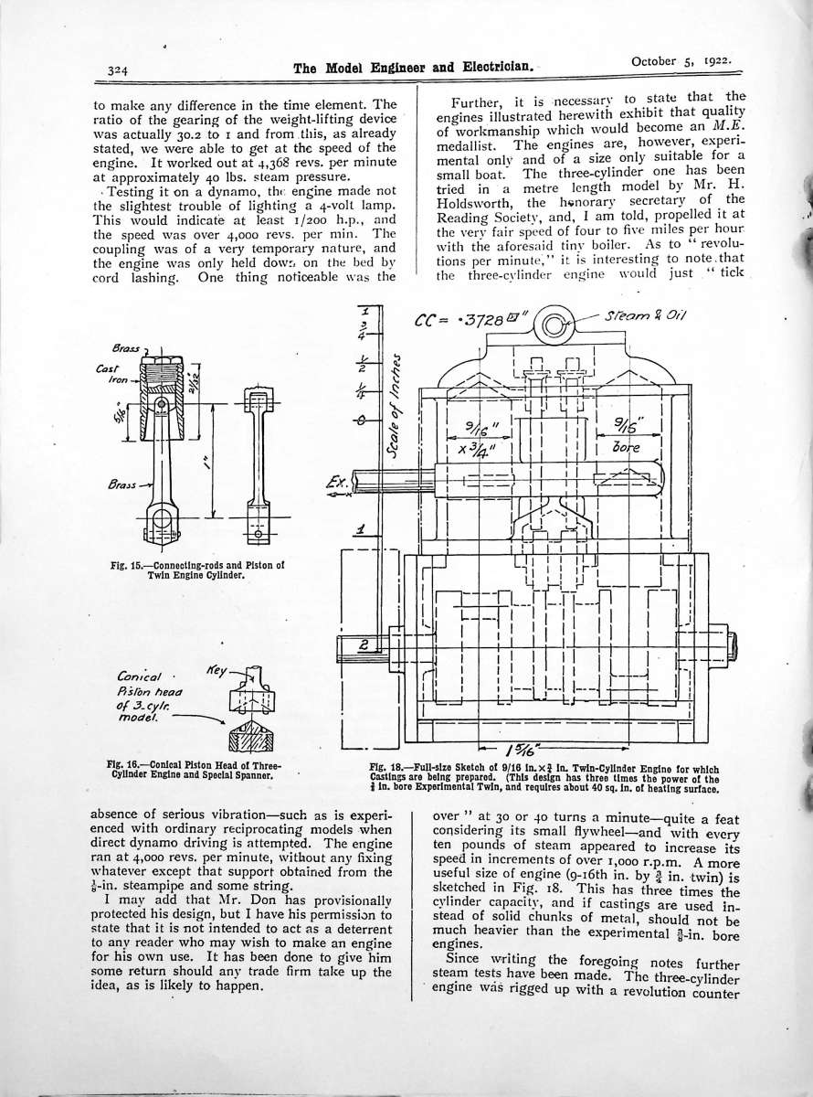

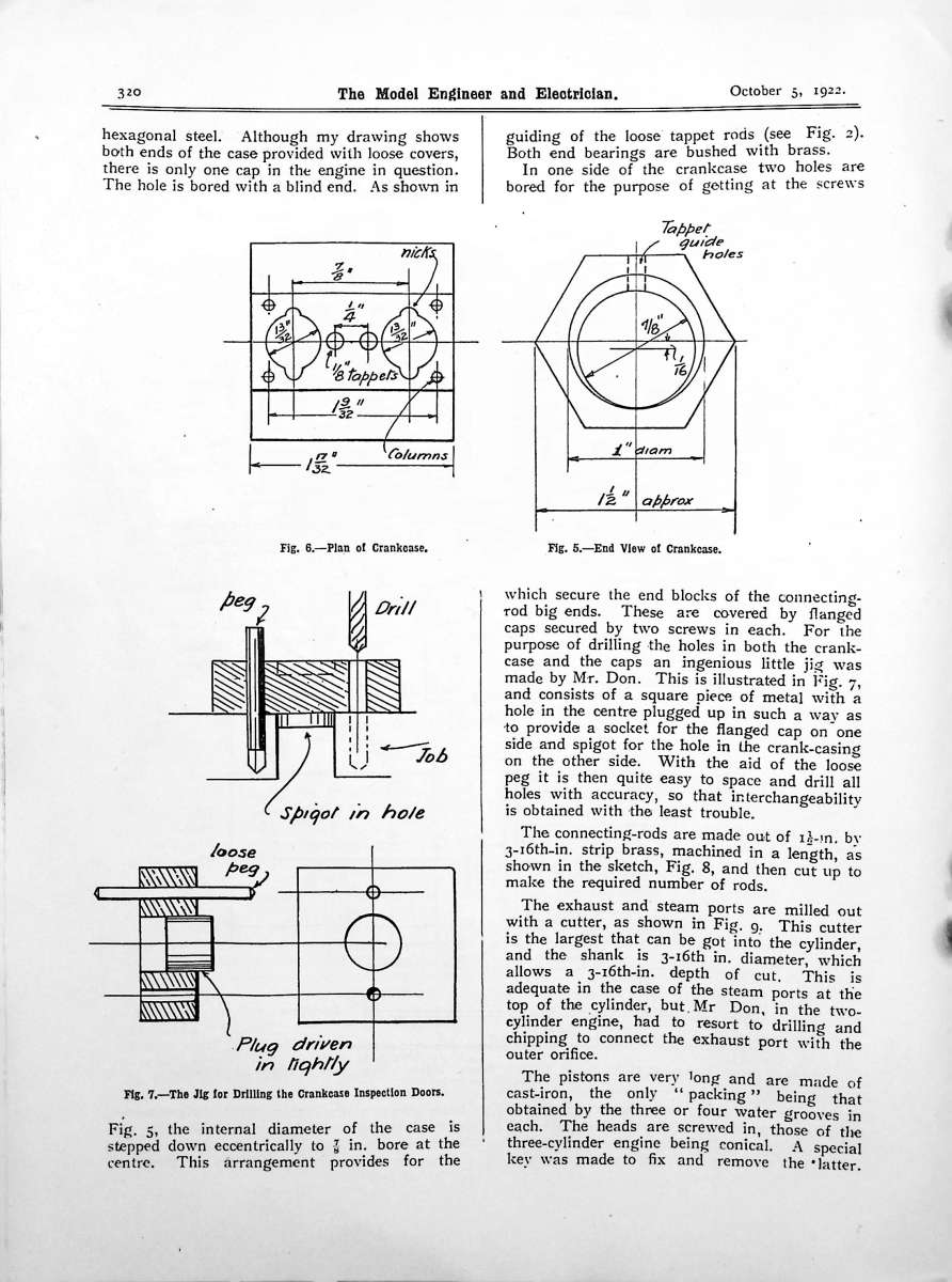

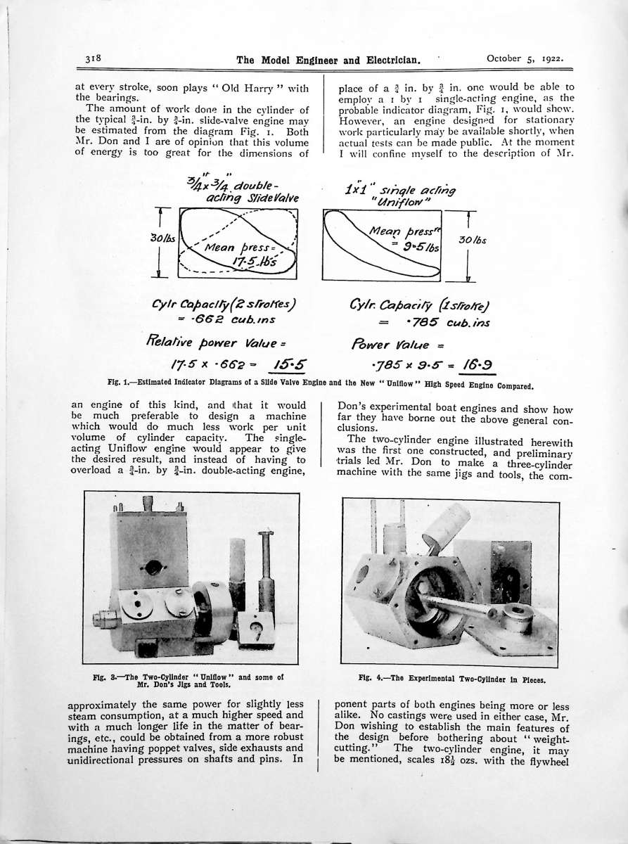

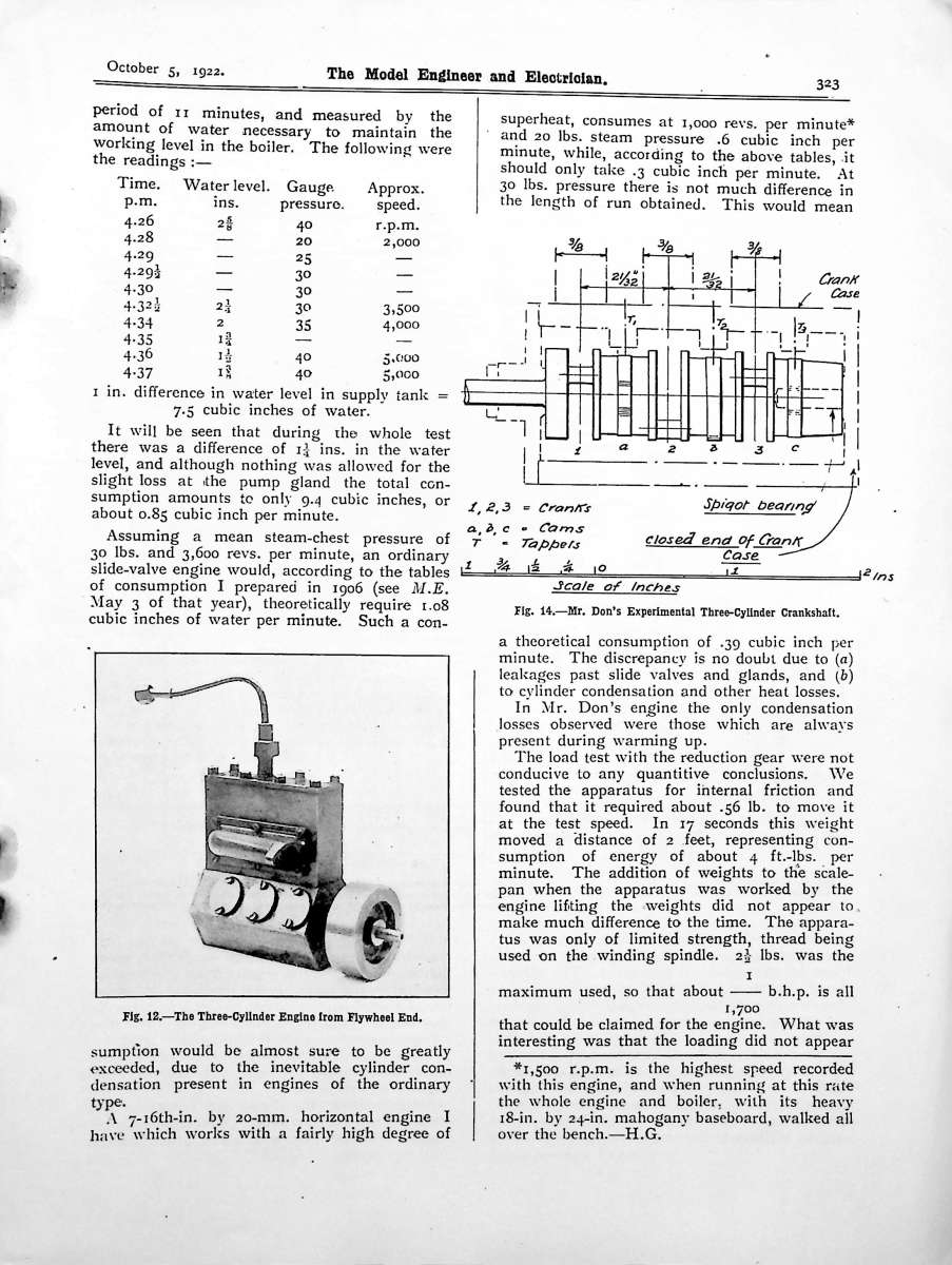

                  The DON engine article from 1922 (not sure why they have come through in a strange order!)
                  image00002image00001image00003image00004image00006image00005image00007image00008image00009

                    It’s very pleasing to see these old designs have not been forgotten!
                    I wondered how they obtained those indicator diagrams (in the 1922 article) until spotting the word “Estimated” in the caption – so they must have been calculated and hand-plotted. I don’t know if anyone has tried making indicators for miniature engines, though it would be difficult to connect one to those enclosed, uniflow machines unless the engine is designed to accommodate one. Usually it uses the drain-cock connection.
                    There are some intriguing design details, such as the eccentric crank-web mounting and the cutting of the port in a blind-ended cylinder wall, and the comprehensive tests on Mr. Don’s engine appear to have included using a weight-loaded, rope-brake dynamometer. What we read there does not mention that, but can be gleaned from what is written.
                    Neat way of making the connecting-rods too, as slices from a side-on profile. I think I’d use hot-rolled steel there to minimise the risk of distortion. The technique is also applicable to other components.
                    Despite the mentions of castings, these machines could well be built from bar stock.
                    I am tickled by one model engine’s specification given: “seven-sixteenths of an inch by 20mm”. A bit of dimensional bet-hedging there? Well, the year being 1922, the UK might go metric soon.
                    Thankyou Jason & David for bringing these to our attention!
                    Aside from these engines, I note two tragedies are mentioned in those pages. One, the awful death of a boy who connected a low-voltage motor to the mains. The other, which would have been known to contemporary readers of the magazine, is a reference to the loss of an aviator trying to fly to Australia. I wonder what happened to him – or if his fate was known?

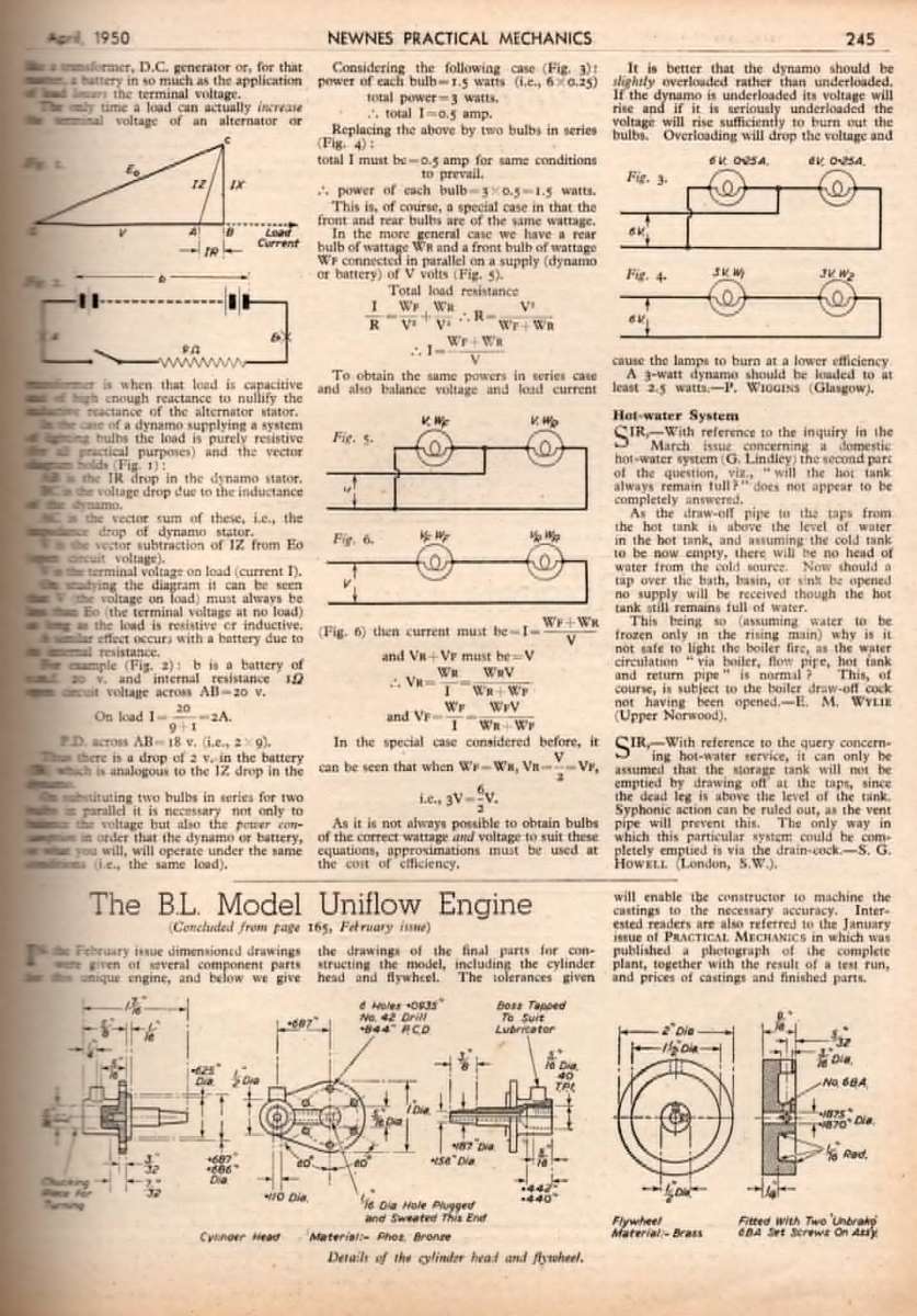

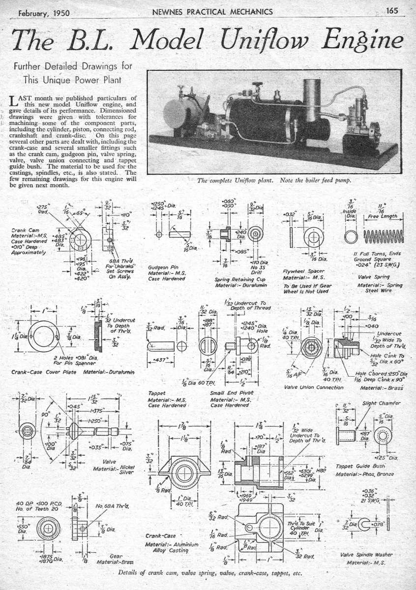

                    Nicholas Farr
                      @nicholasfarr14254

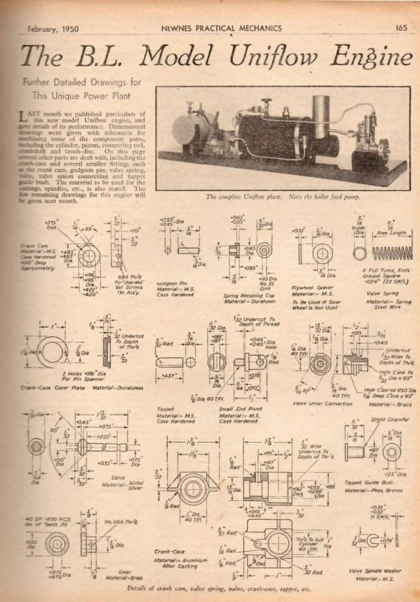

                      Hi JasonB, I’m not sure if this scan is any clearer.
                      THEBL
                      I can’t help with the April one though, which seems as if it should have been in the March issue, but it isn’t.

                              Nick that looks clearer, again I will download and see how it compares. It is intertesting to note that the drawings do not match the image of the engine in the steam plant. The image shows the engine that I have where the cylinder has a jacket which is part of the crankcase casting yet the drawings show an open steel cylinder much like you might find on a 2-stroke aero engine that just exhausts straight out the side(s)
                              Duncan the other two issues are the ones I posted earlier and in Michael’s link.

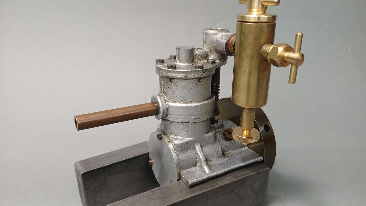

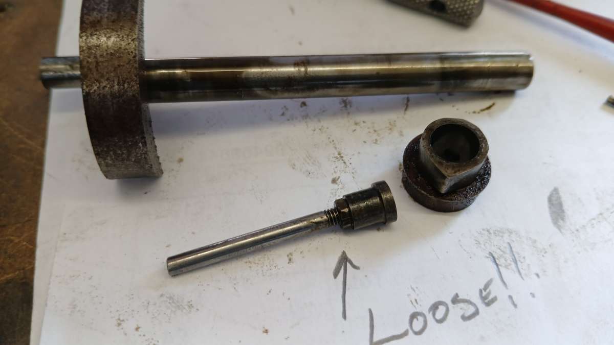

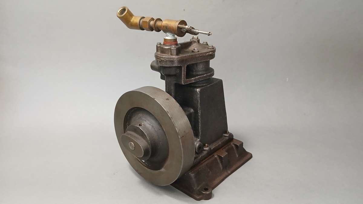

                                I may have spoken too soon🤐🤐🤐🤐  After getting the G1 to run and thinking my work was done it started to misbehave. It would run OK for a while then the speed would go up and down before it stopped rotating and just oscillated back and forth.
                                The cam position was adjusted a few times from below but it still happened as if stopped from oscillating I could hear air still flowing out the exhaust at BDC even if the cam was nowhere near the open position.
                                Off with the head to have a look at the valve. It did not look like it was really closing and a could feel it was in contact with the base circ;le of the cam if not actually lifting so 5thou was taken off the end of the valve stem and put it back together for another try.
                                Same again so another strip down and I thought the valve was sticking a bit, though hard to tell as the spring is held down by the head. Out with the Mic and the bottom of the stem is 0.127″ compared with 0.124″ just under the head so into the lathe and Emery it down parallel and put the engine back together.
                                Same again. Off with the head once more and the valve did not seem to be sitting down so my thoughts turned to the tappet that I could not see. So off with the flywheel, Big end cap off so the piston could be pulled, loosen cam and slide out the crankshaft. The tappet dropped out.
                                On closer inspection the top of the tappet is threaded for a push rod and there is a lock nut. This nut was loose!! Which was allowing the valve lift to alter while the engine was running and when the lift became too high air was passing all the time.
                                I reset the pushrod length and locked up the nut before putting the engine back together.
                                20260501_142755
                                All seems to be running as it should now.
                                Will take a better video over the weekend as the base plate still has to go back onto the bottom of the crankcase.

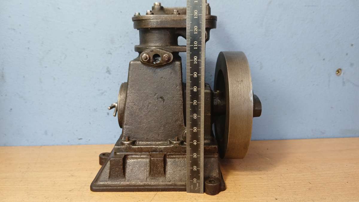

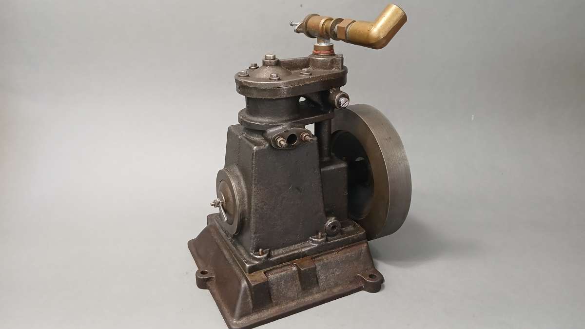

                                    The G1 Uniflow is quite a chunky engine of cast iron construction and quite large for the cylinder size. The steel crankshaft runs straight in the iron, dural piston and conrod.
                                    20260503_133359
                                    20260503_133426
                                    20260503_132659
                                    As mentioned the main problems preventing it from running were that the cam was in the wrong position but mostly that the pushrod was not locked into the top of the tappet so valve lift was altering as the engine was being run. I did not run it at full generating speed as there is no oil in the crankcase and no lubricator but a few drops of oil are enough for short test runs and all seems well with it starting fairly easily. The owner can sort out the damaged regulator valve when he gets the engine back.
