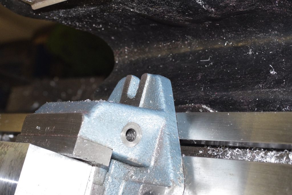

                      You mean like this? Front lip circled in red.
                      I advise caution hacking lumps of metal off tools because it may be there for strength or to improve rigidity. But in this case, I think the lip is just to discourage coolant dripping off the front of the vice. Might be worth having if flood cooling is your thing, otherwise not. Off with it!

                        I milled the back lip off mine by flipping it upside down and using the jaws to clamp to the table tee slots

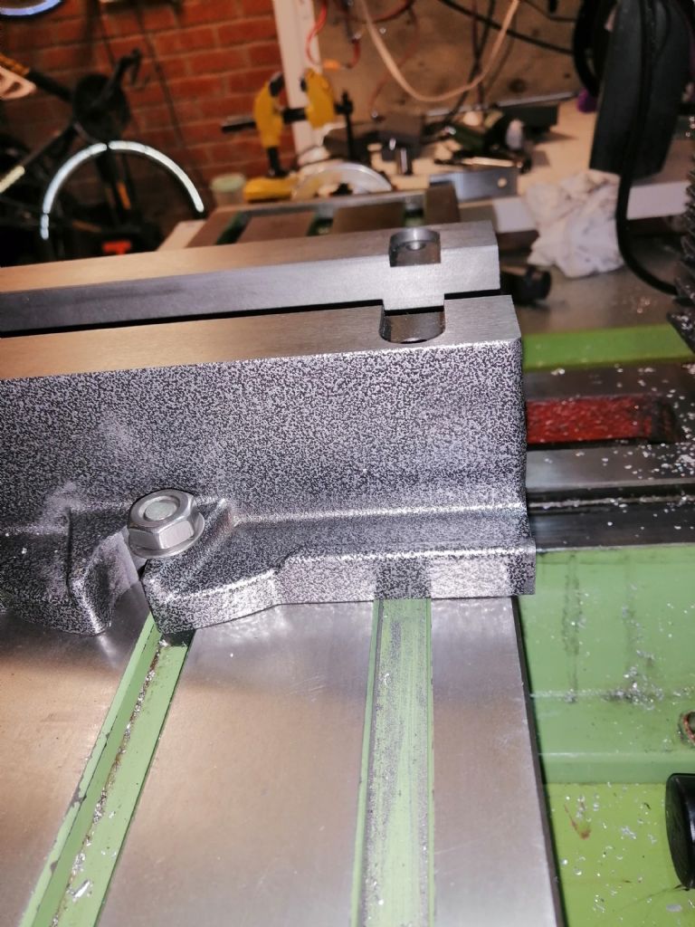

                                All done, i modified the nut locations slightly and have managed to dramatically reduce the overhang.
                                All said and done, the hacksaw wasnt too bad but it was actually not a problem to mill when i was cleaning it up, 0.3mm radial cuts with full depth of cut was fine to whizz the wheel along.
                                Ive added a picture to show how much less overhang i have if anyone is interested

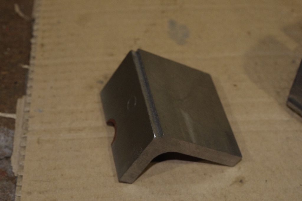

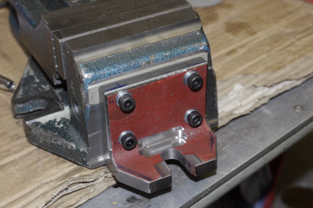

                                      _igp2549.jpgIt's a good idea when the length of the vise restricts both X and Y movements. I have addressed this with the 100mm Bison vises by cutting the rear lug off, but also enabling a bolt on lug just in case the vise needs to be fitted lengthways on the bed. You could make a bolt on lug if there was a need to.

                                        I like that approach – machining the vice to take an angle-bracket for lengthways mounting.
                                        The red paint nicely shows the milled pocket, but what are two rectangular patches approaching the slot? Do they show a slight channel already there in what looks like hot-rolled steel angle stock, or are they raised, shallow lands?
                                        #529189
                                        old mart
                                          @oldmart
                                          The bit of angle is cut from a piece of channel section girder. I didn't bother to mill right across. The thickness tapers from the angle towards the edges. When girder sections are bolted together, special washers with a matching taper are used to level things up.
                                          This picture may show the slight taper.
