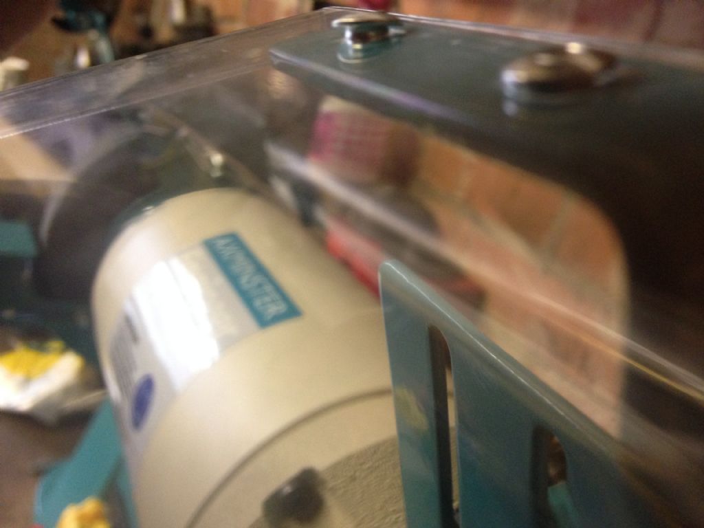

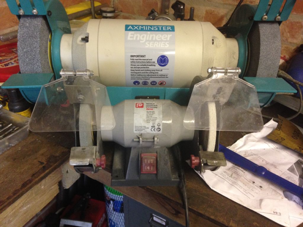

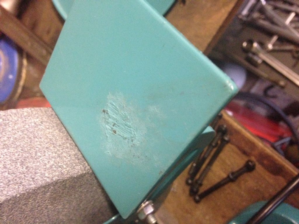

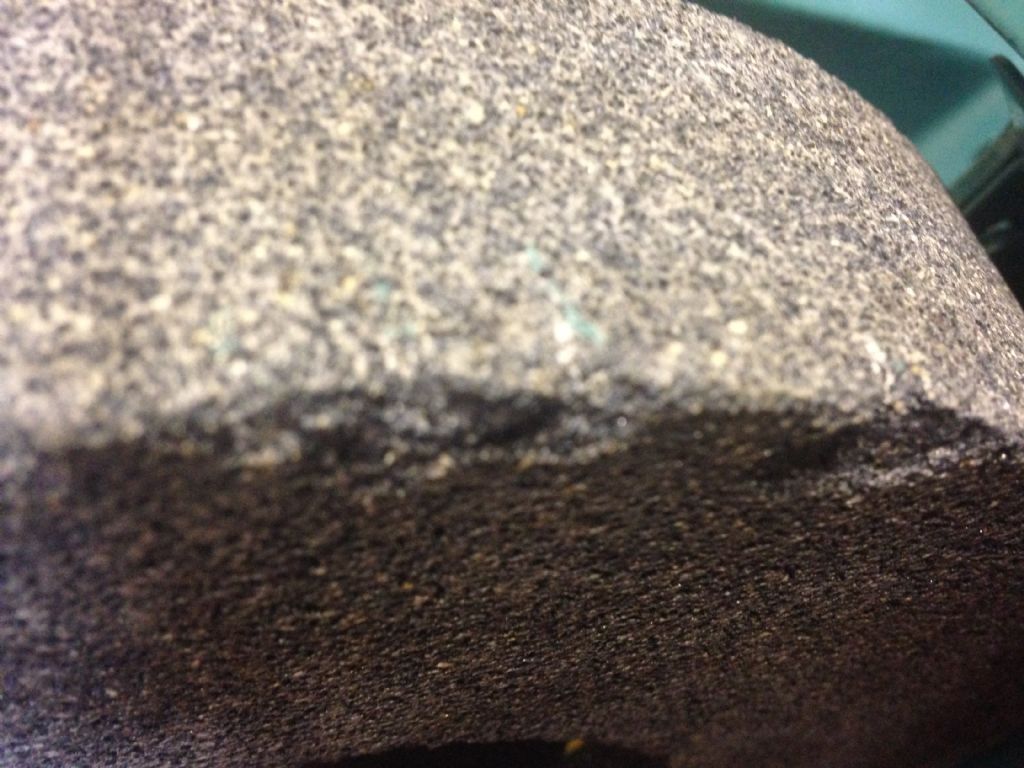

                                    Grinder received today – but damaged sadly!
                                    Strangely no damage to the large wooden crate it came in. I must admit, I'd underestimated the size of this thing….
                                    The left wheel has several dings out of it. It is a (Chinese) Norton Abrasives wheel – Axminster had arranged a replacement and collection of the old wheel within 30 seconds of calling them so I can't complain about that. The left side guard and rest are also out of shape – I can't see any missing paint or marks so I don't know what's going on. I've had a look at the grinding rest and it looks like it was lined up by eye and all 4 or so pieces welded in about 15 seconds – typical Chinese quality and care…. but that doesn't explain why the circular guarding is all of out square. Any how, one of the Aftersales team are going to give me a call back about that one to see if they have a whole replacement guard. It sounds like they may have to exchange the whole thing – I better fish that wooden crate out of the Biffa bin at work!
                                    I'll highlight the good/bad bits for now and reserve judgement on the left side.
                                    It has a nice soft start (a bit too nice maybe… it takes a while)
                                    The grinding rests are quite firm but one of the 3 end plate screws goes through the grinding rest slotted hole stopping it from tilting to grind angles! The securing bolt for the rest is also near the back, so you can feel flex.
                                    Inside the inside half of the guard there is a small half nut that has just one tiny spot of weld, as the screw pulls though, the nut has lifted and is skewed now making it a bit hard to get the screw in and out.
                                    The big plastic thumb/wingnuts on the spark guards are very nice to use and the guards feel secure – they don't get in the way.
                                    The 40mm wheels have a recessed hole as the shafts only look long enough for 25 maybe 30mm, the front and back machined washers that clamp on to the paper ring are very substantial and very nice quality, they look like cast alloyed tool steel, kind of like a modern carbide insert type boring bar. The centre adaptor is also a very nice sliding fit.
                                    The wheels don't run true, the end face is all over on them both, unlike the English made 6" Norton Wheels I have which ran perfectly true right out of the box, I squared them up just for the sake of it when I fitted them.
                                    The paint on the right rest has been touched and it sticks out like a sore thumb (it'll soon wear off)
                                    One of the rivets on the right spark guard has been pulled as the gun was being removed to do the next, so the rivet isn't seated, and it leans off at an angle.
                                    The quality of the right hand guard and the rest, is good and it feels pretty strong, I just wish they'd have taken double the time to weld the rest up and triple the time for the left side! A whole 30 seconds to do it in, and maybe a simple jig would have gone a long way!
                                    Overall, I'm reserving judgement till I know what's happening with the major issues but in general, I think it's pretty safe to say, it's been thrown together – as usual with a lot of these cheap things, it really needs assembling properly (including probably going as far as cutting and regrinding the rests together but I'll wait till its out of warranty before I cut it up!)
                                    As far as Axminster goes, they seem to be very much on the ball, its just a bit of shame they didn't catch this before it went out the door!!!

                                      Well, that was a bit of a saga but all sorted now.
                                      After some inspection and much messing for a few days after delivery, I was unable to get the rest on the left wheel aligned to the (albeit damaged) grinding wheel. The mounting flange was bent and was unequally popping in and out and pushing the rest between toe in and toe out, making it impossible to align the dam thing to the face of the wheel.
                                      I received a replacement grinding wheel after about a week as promised by customer services. I didn't know what was happening with the bent guard as they just said they'd passed it to another department (The Technical Team)
                                      A few days after the wheel, I received a perspex eye guard, not a wheel guard, so I got back in touch, and an apology was made, and again, I was left in the dark while the technical team looked in to it, a dispatched email landed in my email box, so I knew things were in motion.
                                      I then received a full wheel guard, for a 150mm grinder……. another email to customer services, but this time no response at all (embarrased? annoyed at me?).
                                      A few days later another dispatch notification landed and finally after 3 weeks, I have a replacement 200mm guard!
                                      I will fit the guard and wheel tonight with a bit of luck.
                                      SO, eventually, we've got what I ordered albeit still with a few imperfections on the right hand grinding rest and left side eye shield rivets but it is a tool not an ornament so I can live with that, so long as the wheel isn't damaged and the guard and rest are doing their job I'm happy enough.
