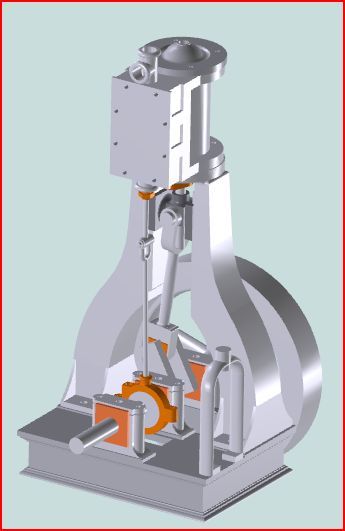

                      Nick, could you be tempted by this in the future? 17" tall, only casting is the 8" flywheel.
