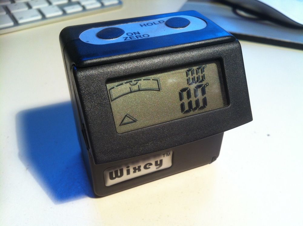

        I purchased this level gauge back in 2012 and have used it several times. The other day I was trying to set 5 deg on a mill job and the display was jumping from 5.2 deg to 3.2 deg.
        As a test, I slowly elevated it from zero and the reading would slowly increase, then suddenly jump to a different value for the next 0.2 deg, then revert to its correct value for a reasonable arc, and suddenly read in error again for 0.2 deg.
        Obviously it is going in the bin. But what worries me is that it could have been like this for a long time – if I was using it at the OK values I would not have seen the jumping.
        Are these units inherently unreliable? Do I pay £40 for a replacement or are there good ones from the many to be seen on eBay?

          I think all these angel gauges work on the same principle. They are basicaliy a pendulum mounted on a ball bearing and they use eddy current damping to stop the reading taking to long to stabilise. The bearing could be sticking or there could be dirt between the capacitance sensing electrodes. I have put some information about the working of these gauges here on my wesite.

                  They are actually quite accurate, 0.1 degree isn't a hugely demanding level of accuracy and they work on a similar principle to digital verniers..
                  A jumping reading is a fault, not a sign of inaccuracy and is probably wither a sign of dirt or a sticky mechanism.

                            I did not take the encder part appart as I was only interested in being able to output the position information a read it remotely. As you can see from the picture I achieved this via a Bluetooth ling to an Android tablet running Yuriy's DRO software. My feeling is that the bearing could be sticking causing the pendulum to jump past the sticky point. I think when CPC were selling them for about £7.00 they must have been an end of line product.

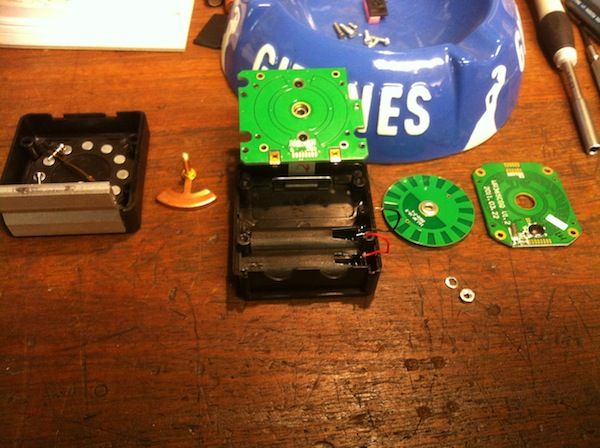

                                              OK I have taken it apart, partly out of curiosity, with little expectation of fixing it. The nature of the fault, being data jumping to a wrong value at certain levels, implied an electronic error rather than a physical malfunction.
                                              So here is a picture of the component parts:-
                                              On the left is the rear cover with a ring of magnets, that damp the copper pendulum, with a shaft that slides into the two bearings carried in the middle of the green, square pcb that is still attached to the display in the main body. The green pcb circle affixes to the pendulum shaft with the nut and washer and I guess carries a set of capacitive elements around its circumference. The final square pcb on the right carries a web of fine traces and a few components. I presume that this senses the capacitive changes. The odd thing was how this pcb connected to the main one with the display. There was a plastic/carbon rectangular section that was compressed between the two when assembled.
                                              The good news is that having disturbed all these parts and reassembled them, it now works without error!! I can only guess that the plastic/carbon connector has changed its behaviour, as that was the only electronic item disturbed, but how it transmits its signal I cannot see.
                                              Obviously the absolute zero level had been disturbed by taking the circular disk off and putting it on in a new, random location. But the device has a 'reset absolute level' sequence of button presses and this was successful. I put it on a metal block bolted to a vertical Rotary Table and slowly rotated it through a full 360 deg. The display seemed to smoothly follow the rotation with no jumping of displayed digits.
                                              I shall now continue to use it, but perhaps keep an eye out for any repetition of the fault. Thank you to those who encouraged me to have a look inside.
