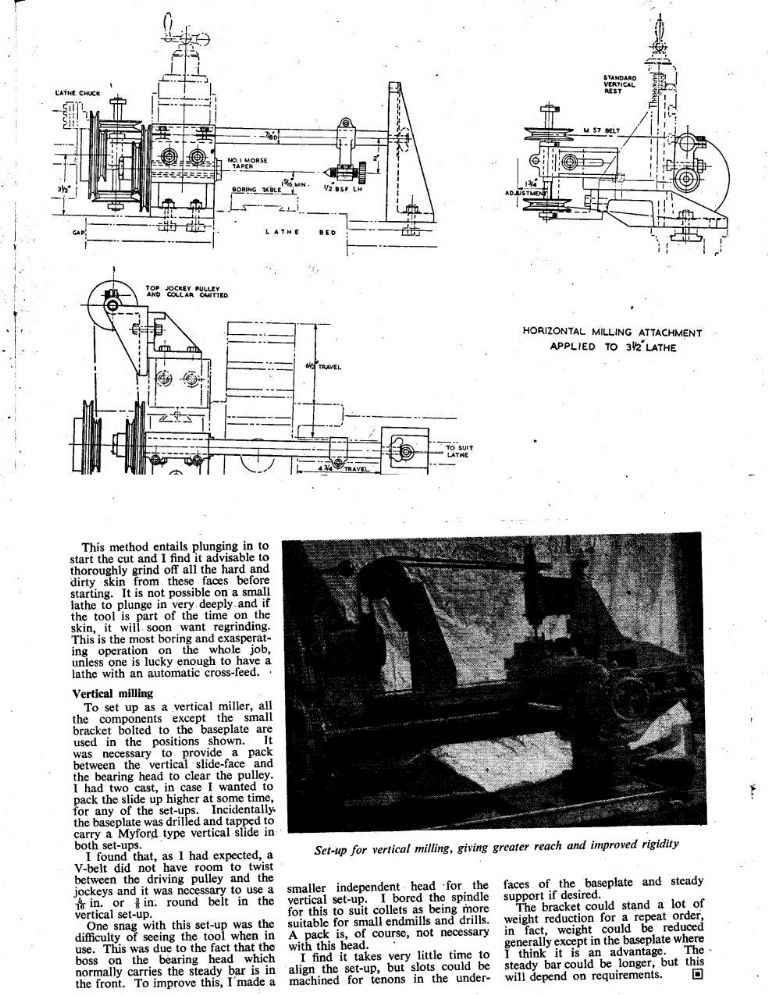

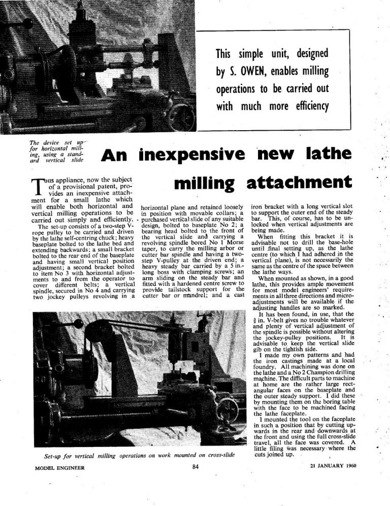

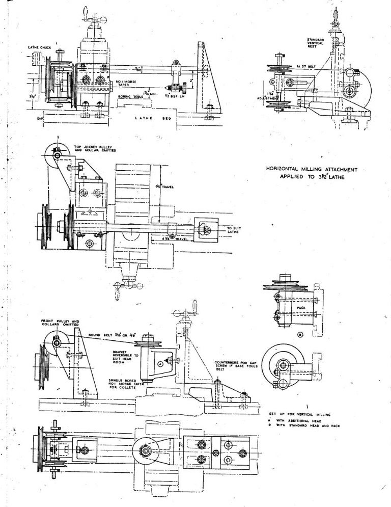

        I hadn't seen this idea before so thought I'd post it up
        The big disadvantage compared to an overhead drive is the loss of your headstock to tailstock working zone
        Looks useful for those wee fiddly jobs though, and best of all, simple

            I'v got the pull out plans for a similar milling attachment by J. Neave, it was presented in issue 21 of model Engineers Workshop. Maybe Neil has that one spotted for a future set of plans to go with the Filing machine etc.

                    You can achieve pretty much the same functionality by mounting a (self-powered) milling head on a vertical slide which has been clamped to the lathe's bed.
                    I used a Taig ER16 milling head and the vertical slide from my Myford (it's Asian) to do exactly that. I just slide the tailstock off and mount the milling head. The total cost was just over £100 (for the Taig head and an extra pulley & belt – all from Peatol) as I already had a small motor. The rest was mainly from aluminium offcuts faced in the lathe. It works well for small jobs and the Taig head can be driven much faster (for smaller cutters) than can be done when they are held directly in the headstock.
