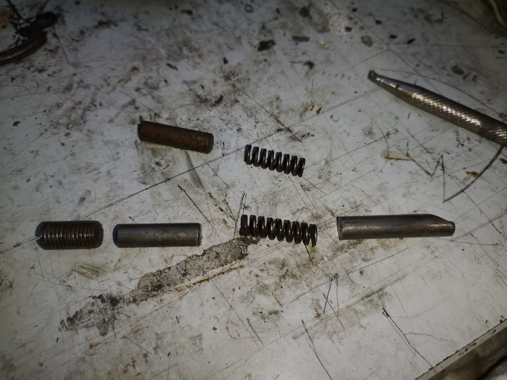

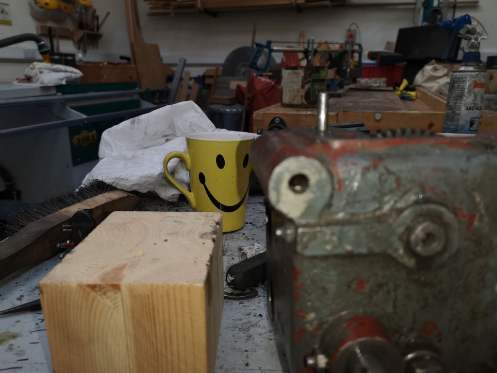

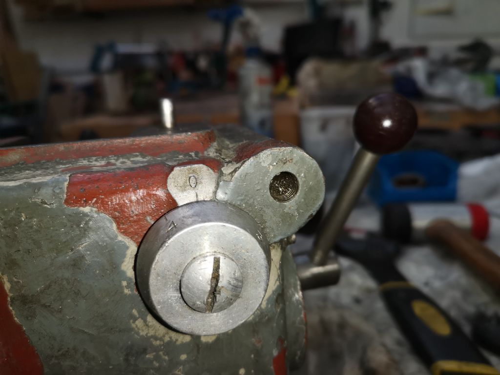

Anyone know what these are for on my hackspaces kerry AG apron? One side is missing parts also are they in the right order?
First of probably many lathe questions
They look like a set of indents to locate a lever or something similar. Probably in the right order ie indent, spring, plunger, grub screw.
Sorry cannot help further. Some more pictures and a further explanation may help.

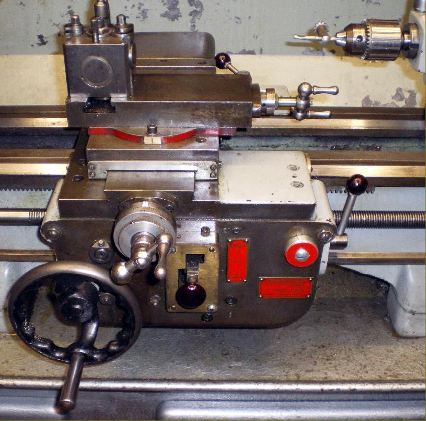

Not from my actual lathe but this shows the two set screws and locking nuts and there positions.
