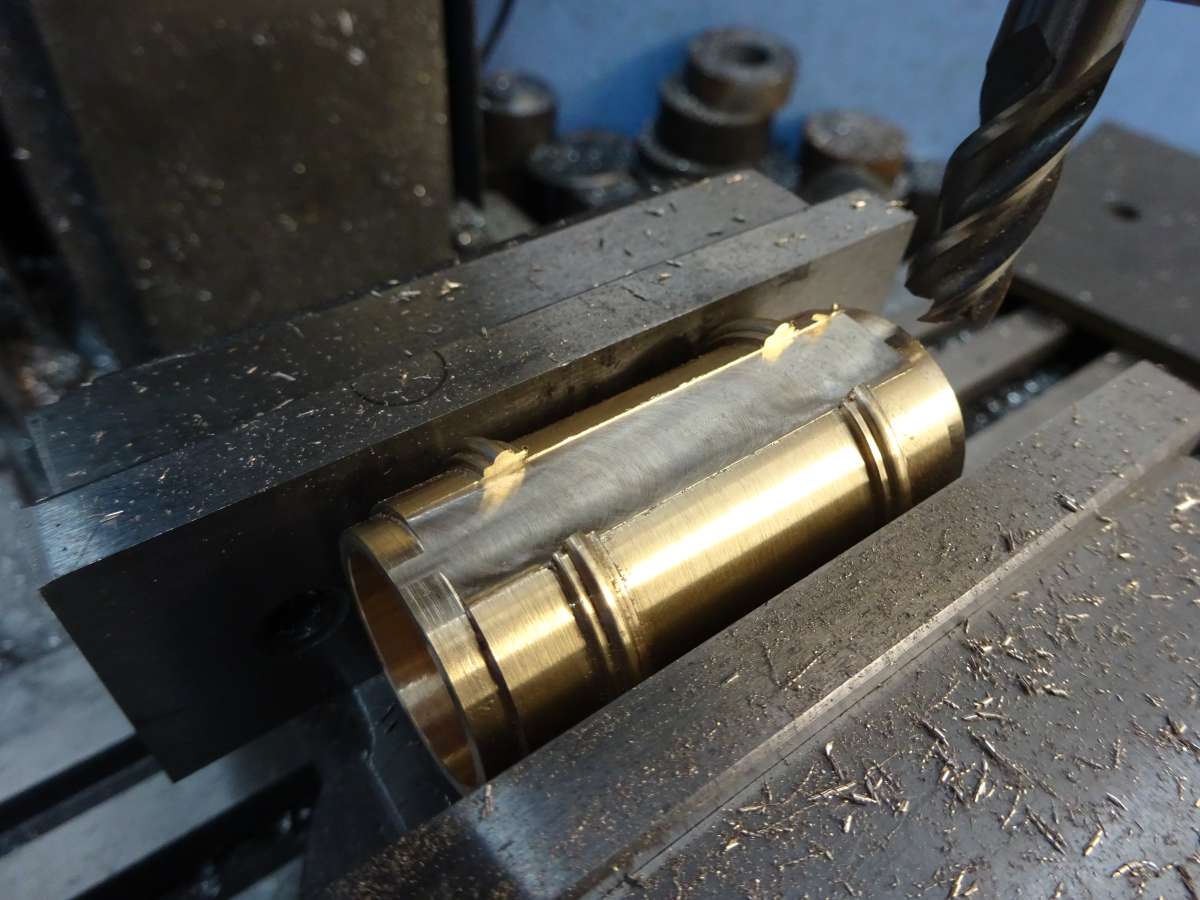

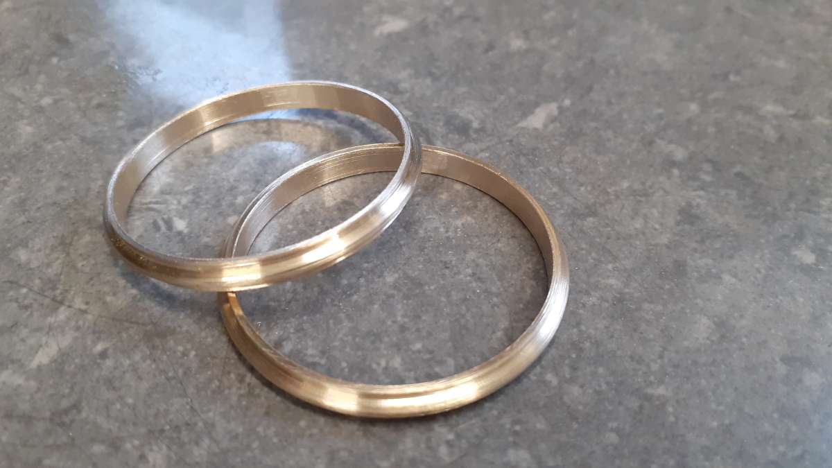

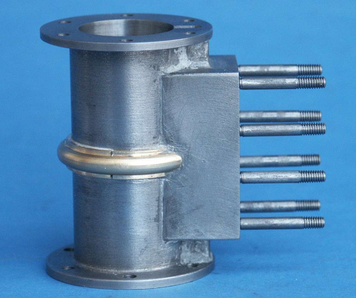

            I cannot see an acyual material specified for the cylinder parts but Julius usually goes with aluminium and this seems likely as he has the bronze liner.
            After turning the cylinder part of the two decorative beads are milled away to leave a 20mm gap. On the passage block part 1-07.2 the inner surface is cut to a radius so that it will fit closely to the cylinder. Due to it being aluminium you will have to bond the two parts together with an epoxy. My choice would be J B Weld which is very strong and can easily withstand steem temperatures. Just make sure you use the “original formula.
            If you are using another metal that can be soldered then that is another option
            Drawing
            I don’t know how far you have got but an alternative to milling away the beads which will be difficult to get into the corners without cutting th emain diameter is to just turn a plain cylinder and make the beads as separate parts which can have the 20mm gap lilled and then a fine saw cut will allow then to be opened up so they can be bonded around the cylinder

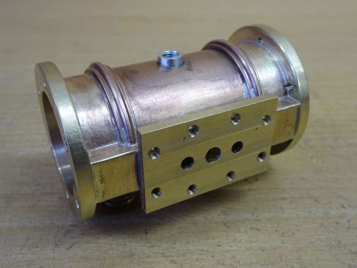

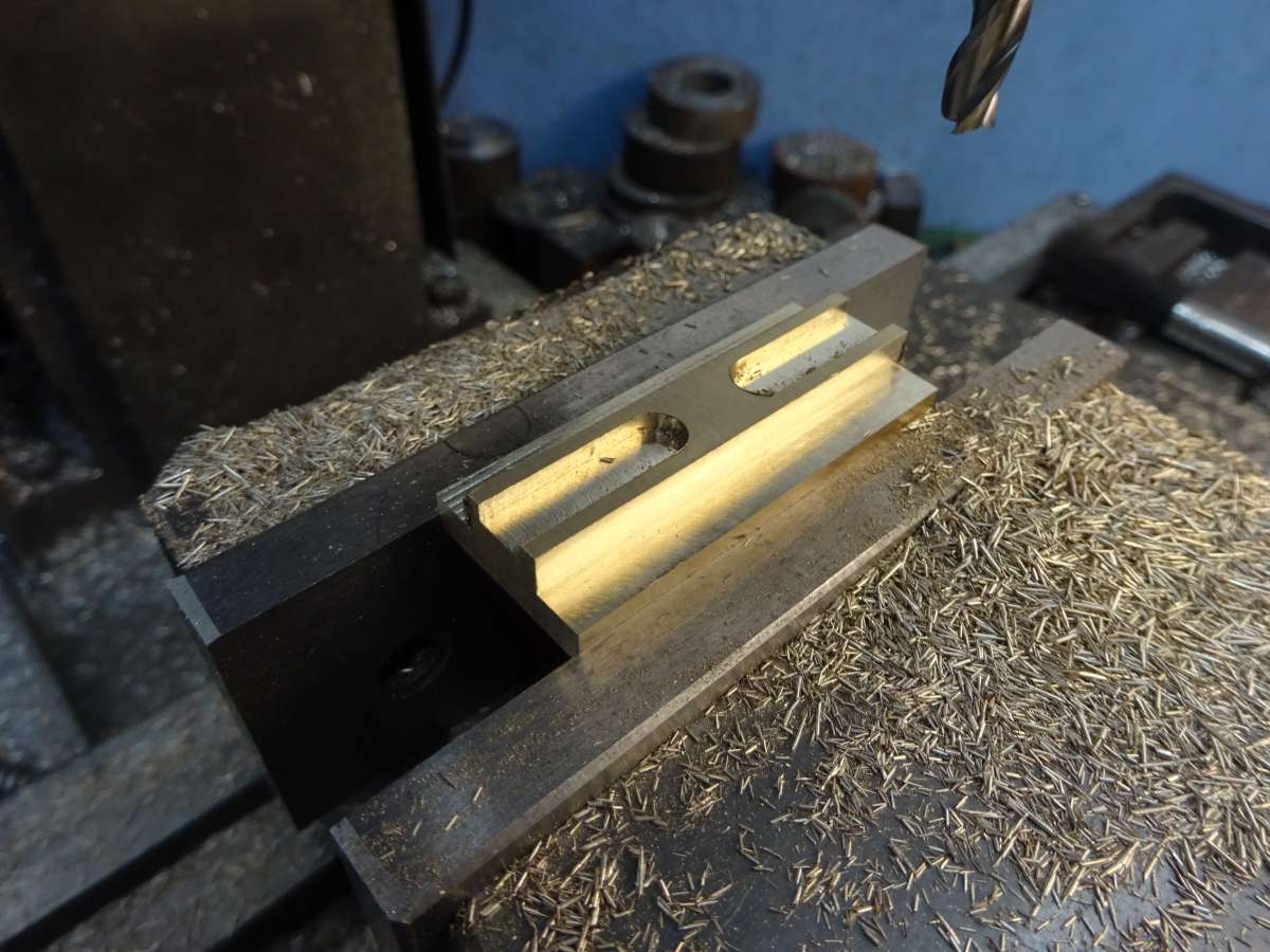

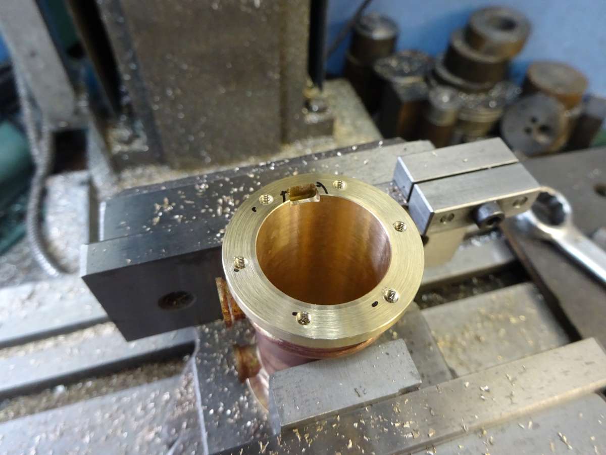

              The drawing showing the end of the cylinder has a grey shaded area that is 10mm wide (5+5) and 5mm deep, this detail is at both ends.
              This will leave a hole in the side of the cylinder that will allow steam/air to enter via the 10mm wide slot cut into the curved face of the passage block. It is not easy to see the slot on the drawing as the top view is quite crouded and the side view is confusing due to the hidden detail. These photos are of another engine that I made may make it clearer though I had a flat joining face. If not just ask and I will draw it in 3D.
