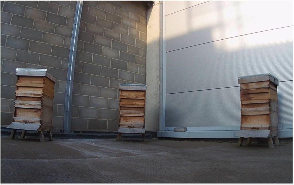

                                      Martin Kyte
                                        @martinkyte99762
                                        Hi Clive
                                        Hows the boiler installation going?
                                        Just to chear you up here is a picture of our beehives at the Lab. They live on top of the energy centre (we have a separate building for all the heavy plant).
                                        regards Martin
