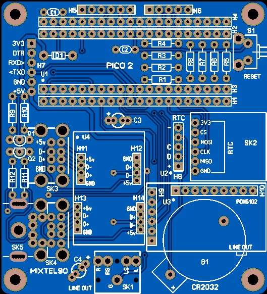

                        The 10″ Waveshare HDMI screens I’m currently working with, were originally designed to plug-in a Pico 1 and the pinout had to be adapted for the Pico2 & HDMI (to use the HSTX pins). Fortunately, a friend (on the Back Shed) designed an adaptor for me and sent the gerbers. He added other useful features in the process. They were £11 for Qty5 or £15 for Qty10 shipped (so I ordered 10 of course). I can use the spares as general purpose Pico ‘mounts’ either with a USB or PS2 configuration.
                        My ‘standard’ PM/VGA PCBs (100 x 100mm) were £12 for Qty5 two years ago. Again, I can populate them (as required) with SD Card, RTC, two Pico ‘pin-outs’, PSU and a 40 way edge connector.
                        My most recent purchase was a fully populated (e.g. working) RP2350B ‘DIL’ board, including PSRAM that has 47 external GP pins available. They were a ‘group’ purchase of five units – and cost us £15 each (inc shipping).
                        All these are high quality, through hole plated, screen printed PCBs. Frankly, I don’t think i could even buy the raw materials for these costs. I’ve been lucky in that others have supplied the gerbers but even if I had to learn something like KiCAD, I still don’t think I’d want to ‘mill’ my PCBs compared to the quality I have avaialble currently.
                        Of course, as always, others will have different needs.
                        Regards,
                        IanT
                        Shown below – Pico2 JLCPCB adaptor for 10″ Waveshare display – £1.50 each – delivery was inside two weeks.
                        Waveshare_10-adaptor

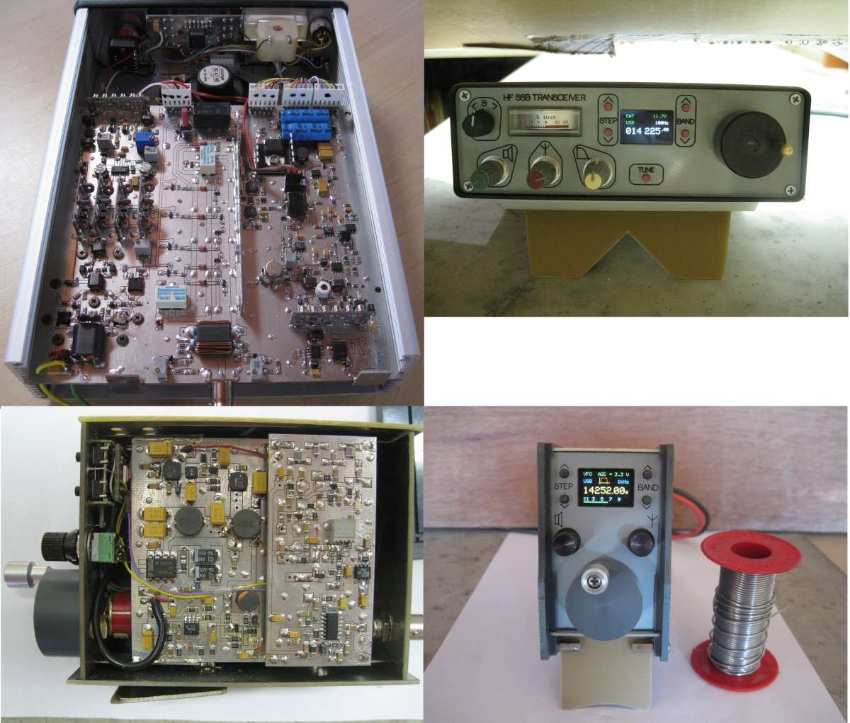

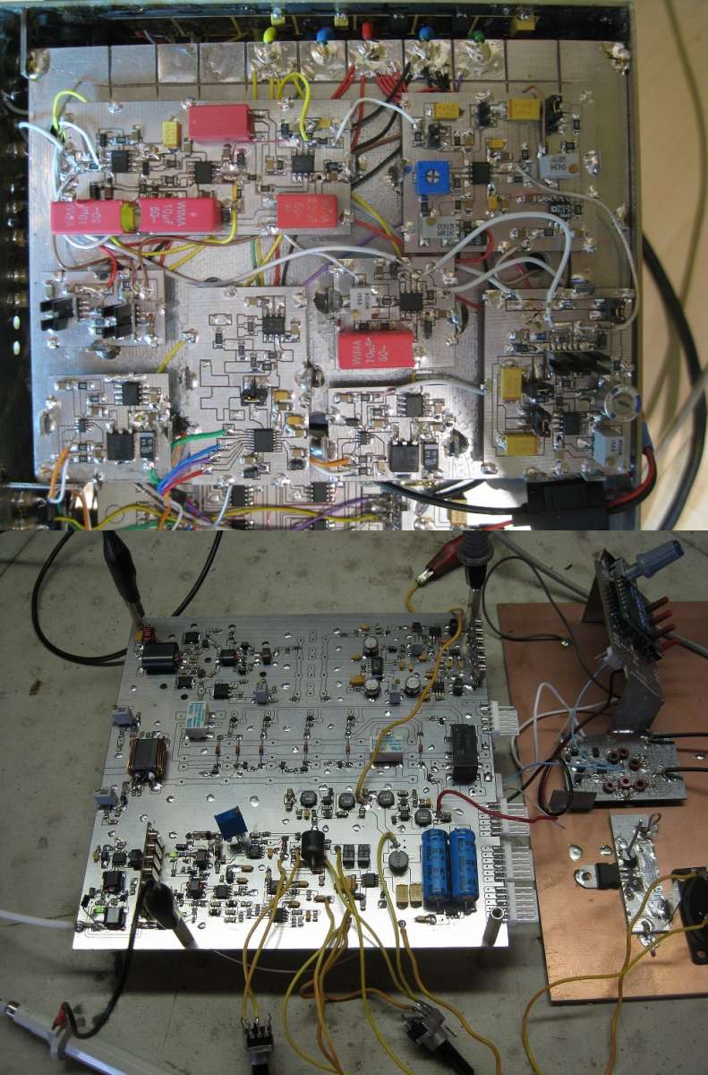

                                These posts made me look back in the folder on my Engraving CNC machine – I see I have engraved 476 PCB’s since Jan 2023…
                                I use Xl-Designer, a British PCB package – I bought it in 2003 for 400 pounds I think.
                                I upgraded once, in 2015, for 300pounds.
                                It does DS and multilayer, never used it for more than 2 sides. Mostly my boards are single sided with full ground plane on the rear, and as much copper on top for ground.

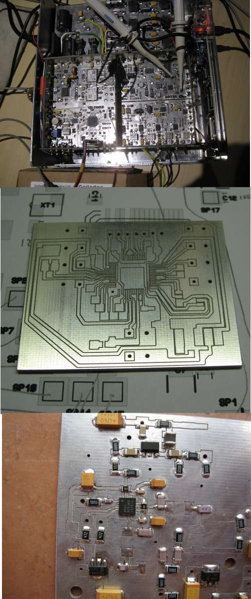

                                The thinnest track and gap I  can do is 0.15mm with a newly ground cutter.
                                I regularly do chips with 0.3mm pad spacing, and mostly use SMD components.
                                The gerber is passed through ‘DeskPCB’ which creates the G-Code file. DeskPCB cost me $90.00 20 years ago – I see they don’t exist anymore..PM me or info…
                                A quick test PCB, with say a few op-amps, a dozen resistors and caps, maybe 40-50 components, takes me about and hour on the PCB software, 10 minutes on the Isolation software and 30 minutes on the engraver. 6 hours later I can make another board if the first one needs changes..
                                Some of the work I have done:
                                Pend
                                HFBits
                                GPSDO

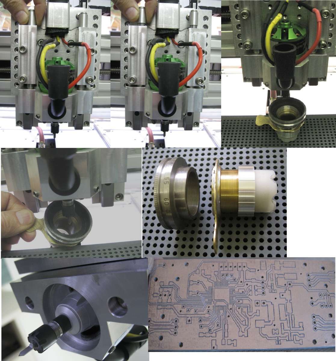

                                The engraver is a desktop size unit, sort of A4 sheet size bed, with an RC Brushless motor on the spindle – 24K RPM. A small collet chuck holds the engraving bit and drills.
                                The head floats on a teflon foot so no faffing around with leveling issues.
                                The pcb is held down on a vacuum bed.
                                The op two images below show the head in down then up position.
                                The engraving tip protrudes below the floating foot by 30-40um, depending on the copper thickness. A vacuum cleaner connected to the black extraction pipe keeps the PCB free of debris so that the foot rides smoothly

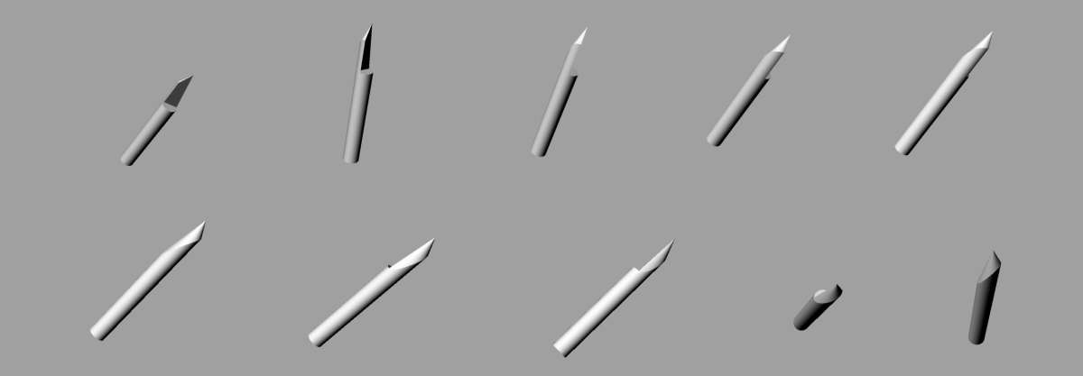

                                The key to clean, burr free fine lines is a really good cutter grind..
                                Engraver
                                Engraving cutter grind
