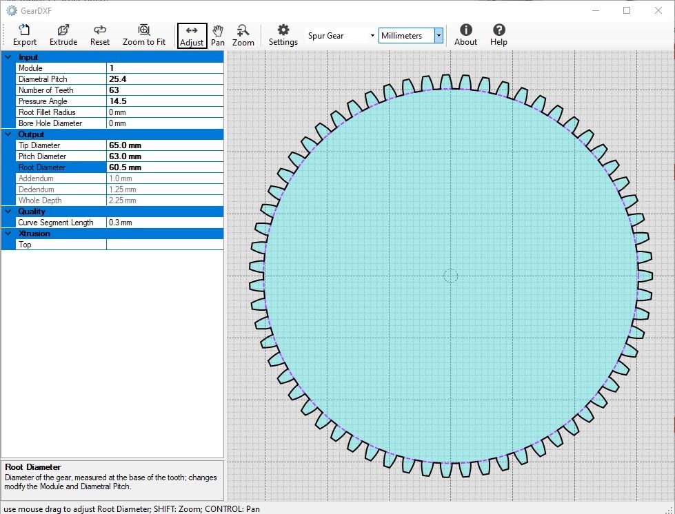

        As all my gear cutting has been in clockmaking, I have been using cycloidal form gear teeth. I have one involute gear to make it is Mod 1 & 63 teeth. I would be grateful to know the full depth I ought to cut it.

              To answer your question directly, I used my go to gear generator software. It gave the following result for the quoted gear:
              GearDXF screeenshot
              In case it's not too easy to see from the above screenshot, the depth of cut works out as 65.0 – 60.5mm = 4.5mm. Or if you prefer, 0.177in.

                  Posted by John Hinkley on 07/04/2021 15:57:58:
                  David,
                  GearDXF screeenshot
                  John, it's actually half of that.

                    Posted by Pete Rimmer on 07/04/2021 17:18:02:
                    David,
                    GearDXF screeenshot
                    Regards
                    Pete
                    Thanks Pete, I had already 'read between the lines'
                      Regards
                      Pete
                      Well spotted, Pete. Should have been obvious, really. I thouht it was a bit deep at the time, but failed to apply what little common sense I have left!

                        Good program. I would have expected the pressure angle to be given as 20 degrees, not 14.5.

                          Posted by not done it yet on 07/04/2021 19:12:18:
                          You can specify but for the purpose it wouldn't matter, the whole depth is the same for both.
