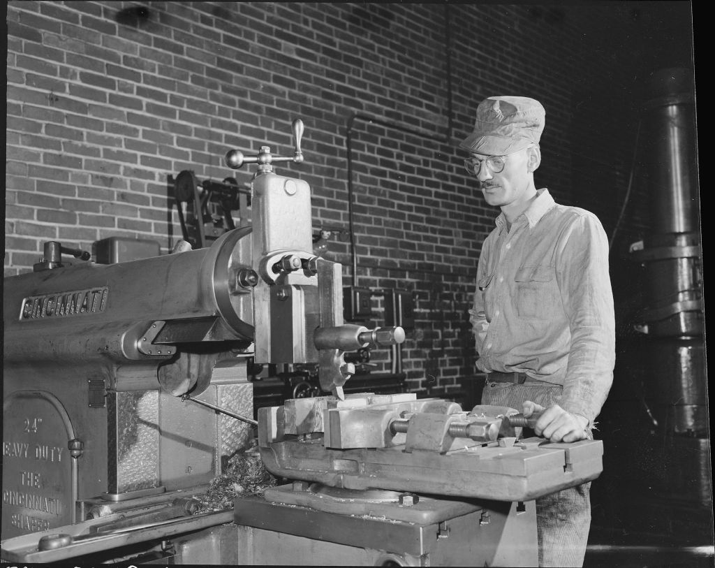

      Faced with possibly having to cut internal key-ways or splines in some gears:
      I know the common dodge of using the lathe as a sort of shaper is poor practice especially on a light machine like a Myford 7; though a Harrison L5 might be man enough to take the widths I need cut, if taken gently. (Up to 1/4inch / 6mm)
      I could use my Drummond manual shaper, and I know for such tasks the tool is not pushed through the work on the cutting stroke but pulled, with the clapper-box locked by an upwards extension to the tool-holder. *
      Or I could make a slotting-tool rather like a boring-bar to fit a small fly-press. (Broaches are a bit on the pricey side for me…) One possibility I have is to adapt an old boring-head for this duty, so setting the depth for each stroke is simpler. More accurate too as it keeps the cutter itself aligned.
      On which, would it be permissible to use the lathe's tailstock to drive said boring-head, which has a matching taper; or will that force an excessive and unbalanced load on the tailstock?
      My main question though is the width of the tool assuming 1/4in / 6mm maximum. Would it better to use a thinner tool and offset the work or cutter to widen the slot, or go in with light cuts by a full-width tool?
      * The shaper. I do know too that the cutting edge should be under the clapper fulcrum, but learnt that only quite recently, and I have seen and probably been guilty of some very unfair tool-setting on shapers.

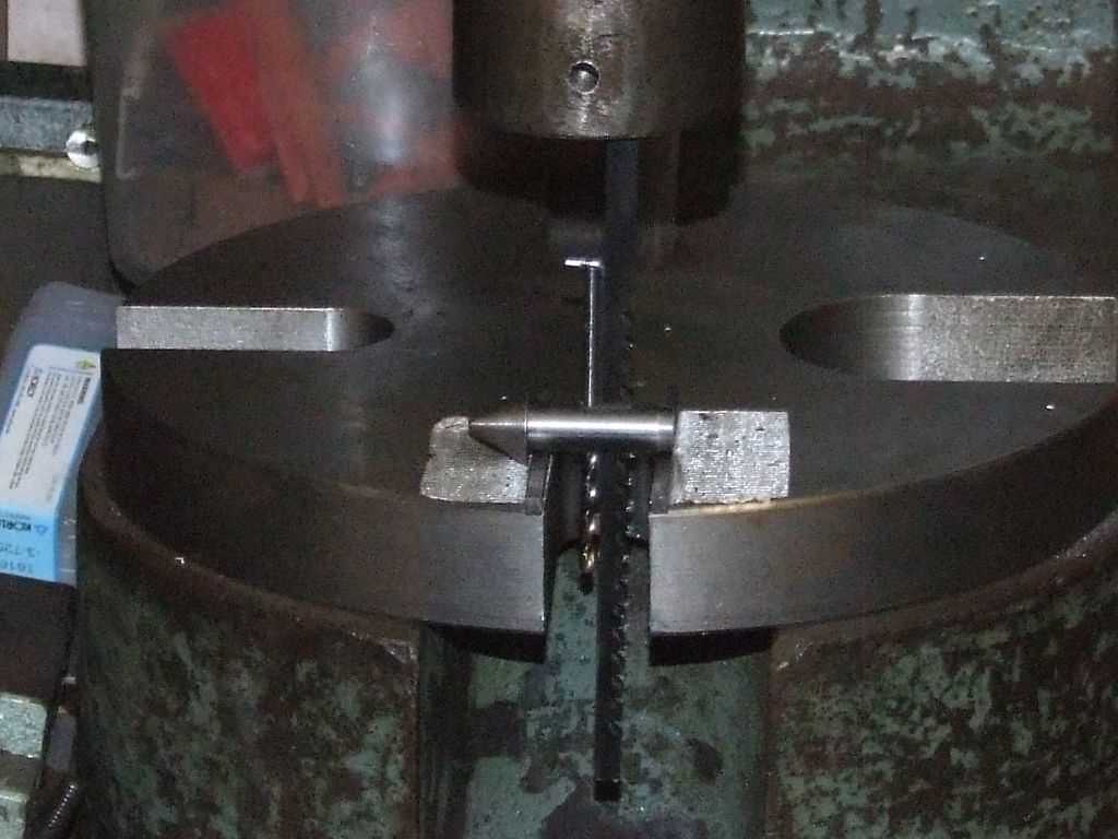

                        I've slotted with the X3 Mill but only in bronze after drilling out most of the waste which worked well but Would not want to do 6mm wide in steel that way. On the VMC it may be possible to raise the table rather than pull down the quill as I had to.

                            I drive my 1/8" and smaller broaches with my old Narok drill press which seldom gets used for drilling these days. Works OK on steel and CI

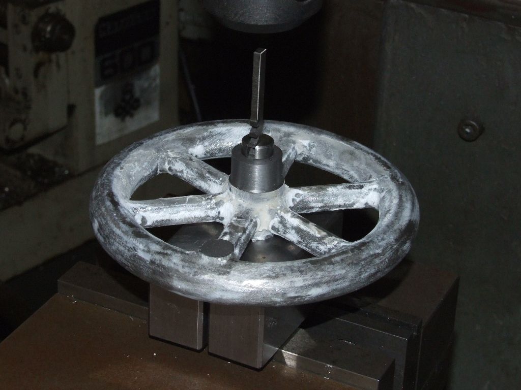

                              I've used the Bridgeport quill to drive a 1/8" broach in cast iron:
                              But I was pushing my luck and wouldn't do it again. Although I now have a proper arbor press broaches can still be fiddly:

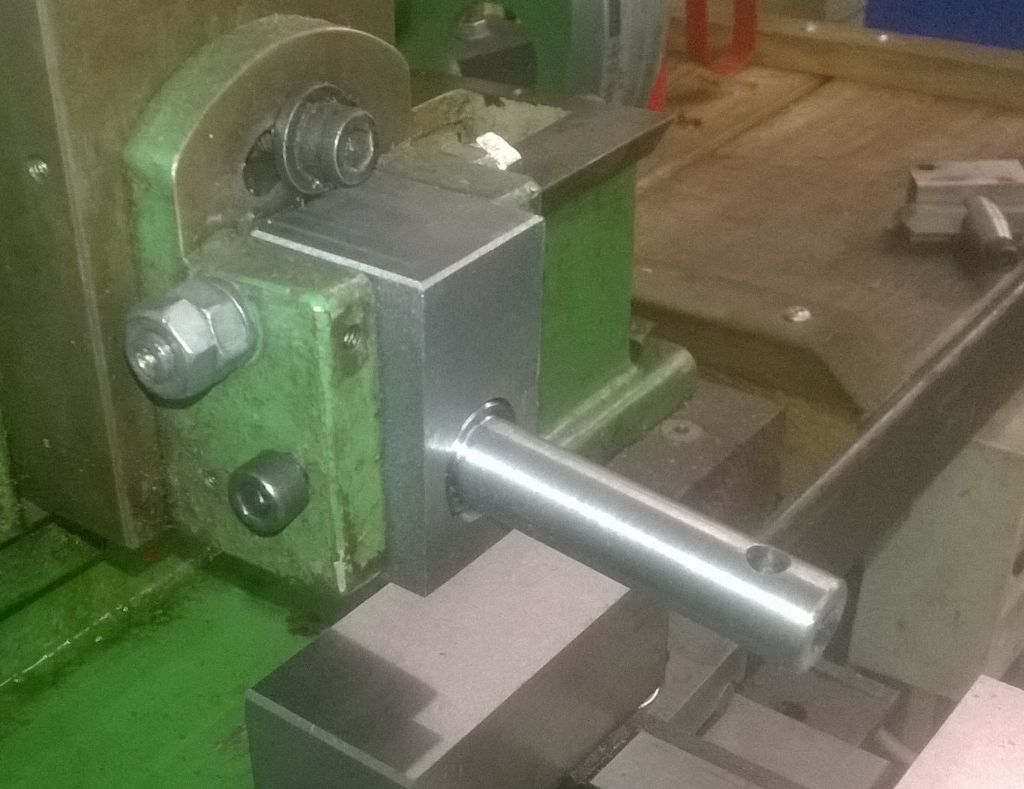

                                            When I was making my gearbox, I had a lot of internal keyways to cut and ended up buying a broach. But while researching the different means of machining keyways, I had a look at Stefan Gotteswinter's other video of slotting on the shaper, here.
                                            I didn't go that route, as I said, but did get around to making the tool holder for my little shaper – a motorised Perfecto, like this:
                                            keyway slotter_2
                                            The tool projects from the clapper at a downward angle of 5°, the tool is 12mm in diameter and takes 4 or 5mmØ round high speed steel. It is to a similar design as Stefan's, the beauty of this arrangement being that the back rake is imparted by the down slope of the tool projection. In my case, a previous owner had drilled and tapped a hole in the side of the clapper box, as seen in the photo above, which meant that I could lock the clapper with a suitably sized set screw. The thrust is taken by the enlarged step seen at the join with the clapper box and the tool is retained in the clapper but a couple of grub screws, gripping the rear portion of the tool.
                                            When my current project is complete, I intend trying it out in earnest.

                                                      Posted by Nigel Graham 2 on 24/11/2020 00:15:33:
                                                      Carry on the way you have been doing it and you will be just fine. I can't think of any good reason why the tool should be directly below the fulcrum — unless there is something special about the model-sized machines? Certainly is not usually the case on the way shapers were used in industry back in the day as the below classic pic shows. Good two inches of lead on the toolbit ahead of the fulcrum there.
                                                      That's the standard Cincinnati clapper box and tool holder that they all used, from what I remember of the few that were still in use when I was a spotty faced apprentice. (Shudder to think today that 16-year-old boys were left alone in charge of such beasts!)
                                                      You might think about getting yourself one of those cool shaperman hats to fend off the flying chips though. laugh
