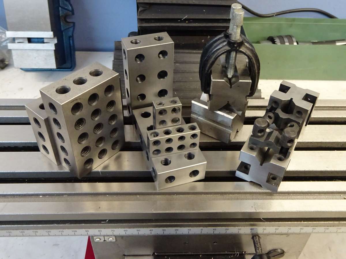

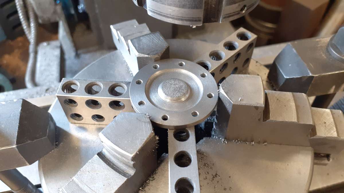

              Did someone mention my name?
              I have not got the mag yet but photo 37 shows me using three 10-20-40 metric blocks that were once available from ARC
              Photo 37
              I’m not seen another source for the various sizes ARC used to do but have not really looked as I have a reasonable selection that get used quite a lot as well as the traditional imperial 123 pair.
              Photo 33
              EDIT a quick look shows that Ausee do the blocks as they do a lot of items that ARC used to but postage to teh UK may make them a bit expensive

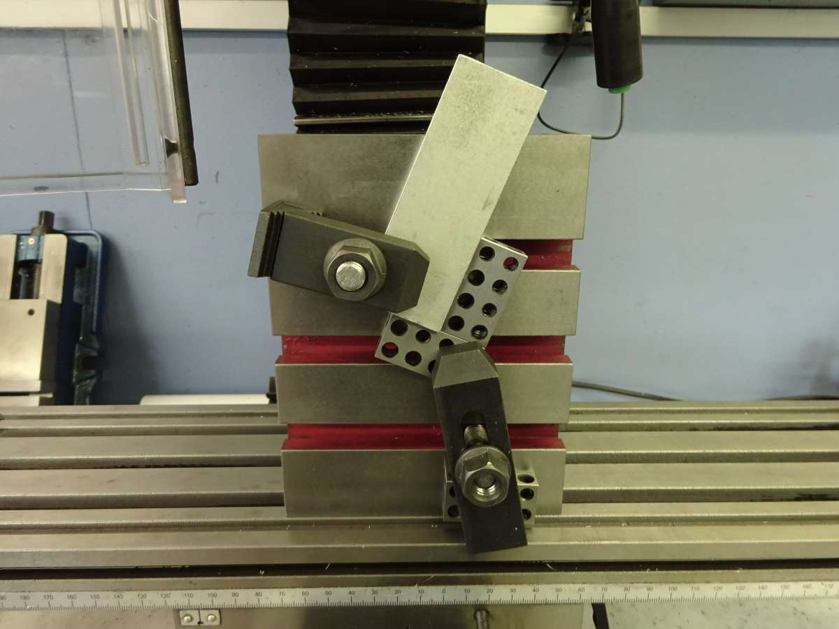

                        #844720
                          What is th eclearance siz eof teh other holes Luke, will they pass the 3/8″ bolts.
                          Most imperial blocks won’t allow the bots to pass through the plain holes so you can’t bolt them together like you can with the ARC ones.

                              For the application shown, maybe we should note that three anything of the same size would suffice.
                              For their low cost, buying a set of parallels and cutting one of the pair in half would give three spacers.
                              For spacing things off the face of a chuck, this is a neat solution (also in an Oxtools video somewhere I think):
                              They can be trued up in place if required, just like soft jaws.
                              #844815
                                For the operation shown the ability to easily move the blocks was an advantage as sods law says a fixed support will end up under a hole. The adjustables would be OK for just turning and won’t drop in the swarf tray like loose packing but I find in most cases two parallels will work OK to just position the work, it was the downwards force of the drill that is did not want upsetting the work.

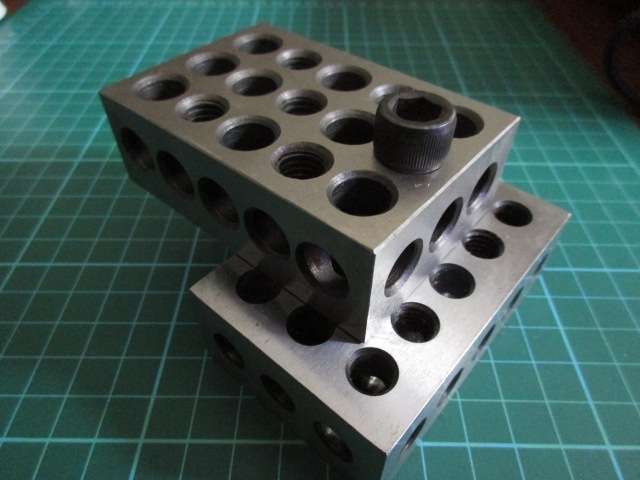

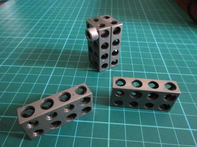

                                Nicholas Farr
                                  @nicholasfarr14254
                                  Hi, those blocks on page 17 are undoubtedly 10-20-40 metric blocks that Arc Euro sold, and I have six of them, along with six 15-30-60, and two 20-40-80 ones, and can be bolted together.
                                  003
                                  Like JasonB says, the normal imperial 1-2-3 blocks don’t allow the bolts that fit the threads, to pass through the plain holes, however, I got a pair of 1″-2″-3″ blocks from Chester UK, about 16 months ago that do allow the bolts to pass through all the plain holes, and the photo below shows one of them bolted to a normal 1-2-3 block, and they have the same five threaded holes as my imperial ones have.
                                  002
                                  Regards Nick.
