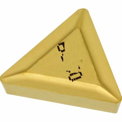

      Hi All
      Help please. I'd like to purchase some basic inserts for the usual machining operations that you'd contemplate on a 9×20 lathe.
      I propose making my own holder(s)
      I don't want to have to purchase a host of different inserts for this operation or that operation; so what's the best general purpose insert to go for so that I can try them, mainly for facing and turning, and get a feel for whether they suit without having to spend a fortune.
      Also I have a basic mill / drill on the way so, if the inserts could find an application in that too, it would be a bonus.

            Hi Wannabewelder,
            I have found triangular inserts can be used both on turning tools and milling tools. Steve Bedair has a description on how he made tool holders for 1/4" TCMT carbide inserts. I have made tool holders based on his description, and have used them for many years on my small lathe.

                        Thor, I decode TPMR110304 as:-
                        T= Triangular.
                        P= 11 deg. Clearance.
                        M= Tolerance as per table on all the insert dimensions. M is not the closest tolerance as far as I can see but certainly not the loosest either!
                        R= Chip-breaker one side.
                        11= Size, but I can't decode this.
                        03= Thickness 3.18mm.
                        04= Radius/Chamfer 0.4mm.
                        I've looked at Steve Bedair's site again but he doesn't specify an insert – just cheap from Ebay. From scaling the photos I reckon the insert is a bit under 3mm thick (and has a mounting hole) and the edges of the insert are approx.12mm.
                        I think I'll try the Norwich merchant as they seem to offer similar parts **LINK** and I'll also keep my eyes peeled on Ebay for a “bargain”
                        I'll report back when I've achieved something but I'm renowned for my slow rate of working!!

                          your decode is spot on, as far as I know the digits 11 is the length (in mm) of one side of the triangle.

                              As Ian did, I milled a triangular pocket for the insert. The clamp and the cutting forces will push the insert into the pocket. I have never had an insert come loose.
                              If you look at Steve Bedair's site you will see that he uses triangular insert with a hole in the centre. He used an 4-40 Allen screw to clamp the insert to the holder. For the single cutting edge milling cutter I made I used similar inserts, and a countersunk M3 Allen screw to clamp the insert.
