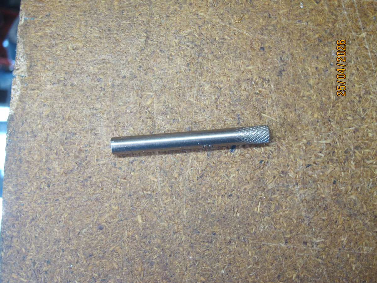

                          #845774
                          Greensands
                            @greensands
                            I would be quite happy to buy a spanner but I have not found the style I am looking for. The photo is of one I picked up at an exhibition some time ago buy have not found a current supplier. Any suggestions as to whom might be worth trying?Tubular Box Spanner
                            #845775
                            Andy Stopford
                              @andystopford50521
                              Pollymodels do one that’s similar – I don’t know what they’re like.
                              Beware, many of these now seem to have almost totally unformed ends, I bought a set where all the smaller ones needed a hexagon filing out from what was more or less a round hole in the end.

                                #845777
                                KenL
                                  @kenl
                                  Hi Greensands
                                  I have a part set of those spanners (4,5,6 and 7BA) and very good spanners they are too. Sorry but I can’t remember where I obtained them, not that it would be much help, I’ve had them for more than 45 years.

                                    Nicholas Farr
                                      @nicholasfarr14254
                                      Hi Greensands, EKP, do a set. EKP box spanner set.
                                      If you just want a 7BA Chronos 7BA box spanner
                                      Regards Nick.
                                      #845788
                                      Greensands
                                        @greensands
                                        I think that Nicholas has come up with the answer i have been looking for. Thanks to all who have contributed.
