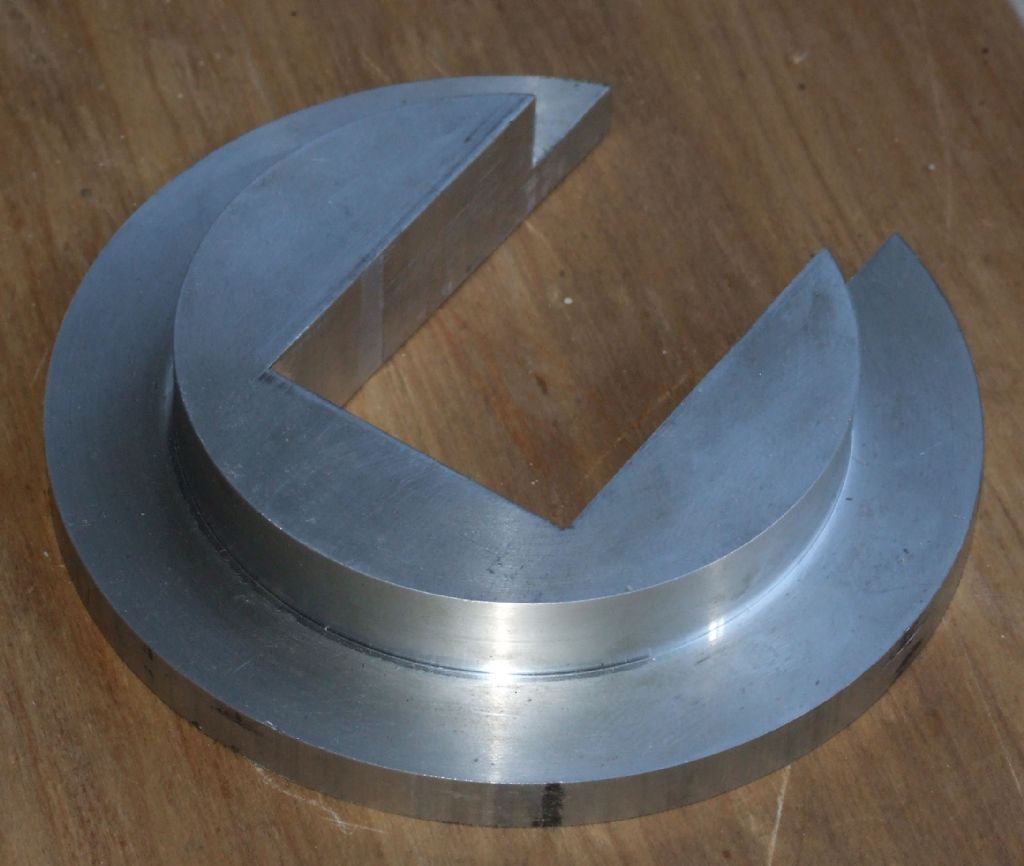

                    The soft solder method has never worked for me; it always ends with the joint breaking during machining. Soft solder isn't exactly known for its strength. I usually make a jig that allows the bearing to be machined without soldering them together. Like this:
                    Crankshaft Bearings

                                @Andrew, can you show some more photos of that?

                                  I'm afraid I don't have any more pictures of the actual machining operation. However I have taken a picture of the jig, as here:
                                  Jig
                                  For scaling the rectangular slot is 1.5" across. The sequence of machining to make the jig was as follows. The front face, smaller diameter and middle face were machined in one go in the lathe. At the same time a 1.5" hole was drilled and bored. The part was then turned round and plain facing operation done to get the correct thickness, 0.75". Note that the set up of the part is not critical for the facing operation; it doesn't matter if the machined diameters don't run true. The outer diameter was not machined as it plays no part when using the jig. The part was then transferred to the mill and the rectangular slot milled out using the 1.5" bore as a guide. When the remnants of the bored hole disappear on the sides and at the bottom I know that the slot is 1.5" wide, and that the bottom of the slot must be exactly 0.75" below the centre of the machined spigot.
                                  In use the jig is set up in the four jaw chuck so that the spigot runs true. I then know that the two sides and bottom of the slot are equi-distant from the centre line of the lathe. Thus, when the blank bearing halves are placed in the jig I know that a hole bored in the bearings will be exactly central in both X and Y. The bearings are held in place by the fourth jaw operating in the slot with a piece of scrap brass in the way to avoid damaging the bearings.
