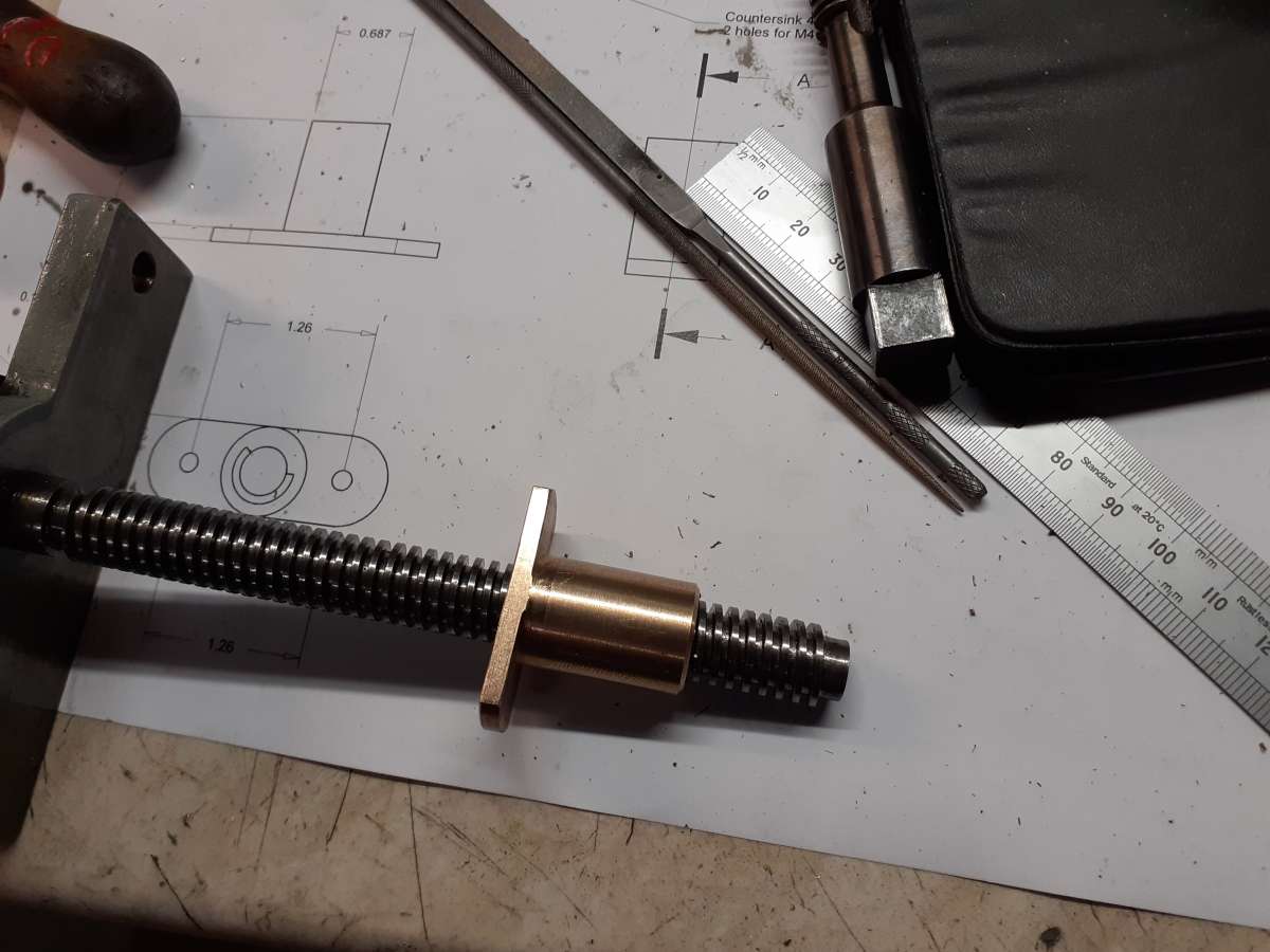

                        Well chaps I’ve got an email back from Chester and a new crossnut is nearly £100, it has to come from China and most of that is postage and VAT. Fair play to them though for finding a solution to an older model machine, if I do ever upgrade I’ll be sticking to that brand as they have been very help.
                        I did decline though as I’d rather spend an afternoon making one and then take the £100 to the pub.
                        While I was waiting I knocked up a little internal threading bar and have made a working replacement from some Brass scrap I had so the mill is back and limping along but I think I need a better more permanent solution.
                        The ball screw solution does interest me, is that a big improvement? I thought this was more of a CNC conversion thing.
                        I’ve also read a few posts about people creating “evan nuts” out of delrin. There shouldn’t really be any real load on that nut so I think this would also work. I know you can also get impregnated plastic so it would self lubricate like bronze.
                        And of course I could use a nut and make a housing for it, or even make my own tap at this stage now my mill is back online.
                        It’s been a good opportunity to clean my mill though, it’s been completely degreased and is now back together with fresh oil and it’s running the best it has in my ownership.

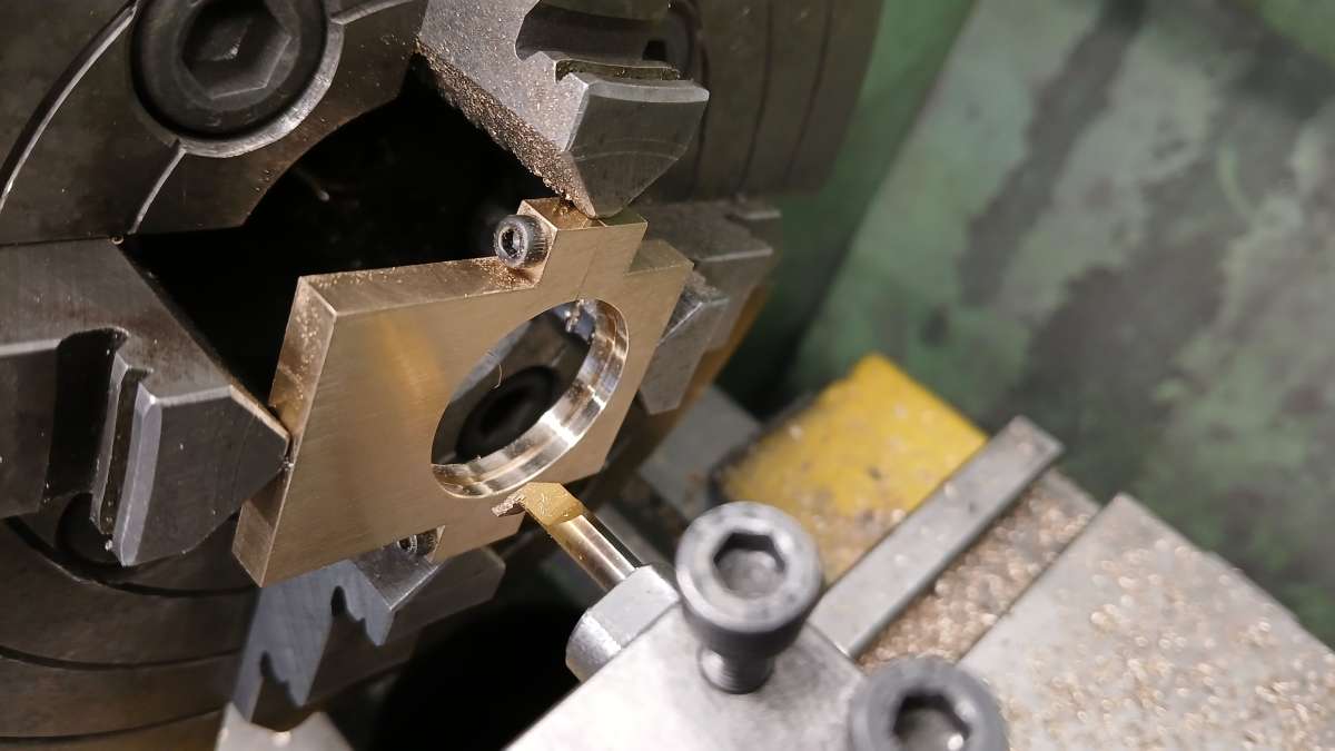

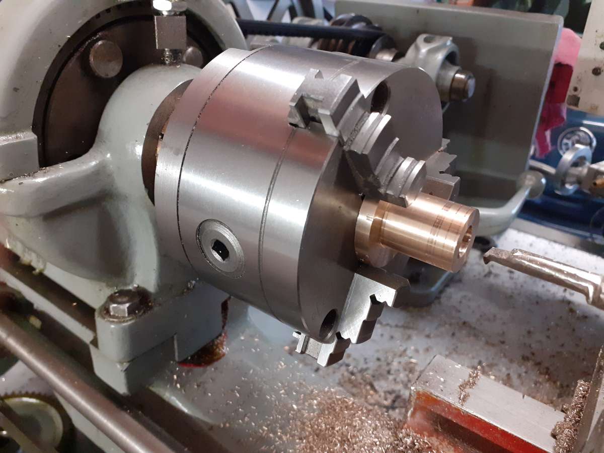

                          This is my 1/2″ x 0.1 pitch square thread internal screw cutting tool.
                          20200418_102437
                          20200419_155450
                          David
                          #782971
                          moonman
                            @moonman
                            20200418_102437
                            20200419_155450
                            David
                            That’s very similar to the one I ended up making, the only difference is I used a 01 tool steel shaft and cross drilled it for a bit of HSS (a dead endmill).
                            It worked nicely, I’ve got some Bronze on the way for the “final” attempt at it.
