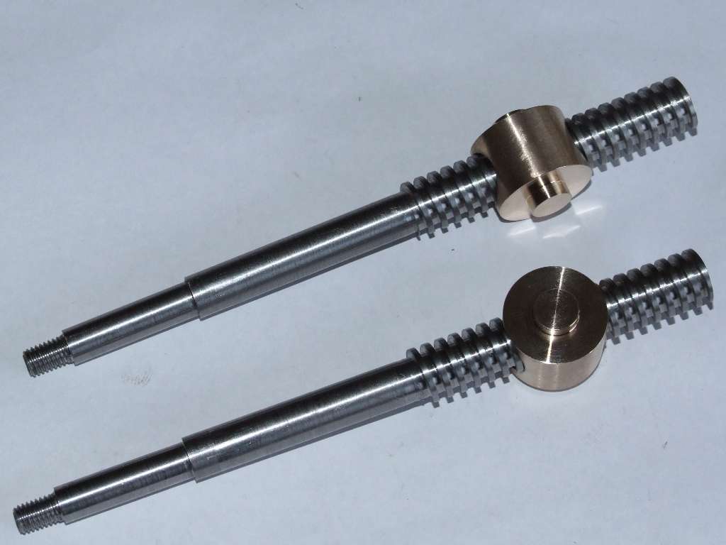

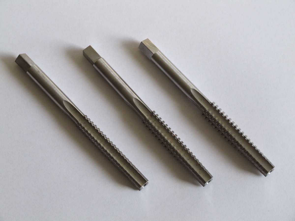

                            Personally I’d screwcut the thread on a lathe, or make my own taps. It’s not difficult; these taps were made for a square thread, but same principle:
                            2015_03070019
                            And the finished brake shafts:
                            Finished Brake Shafts
                            Julie

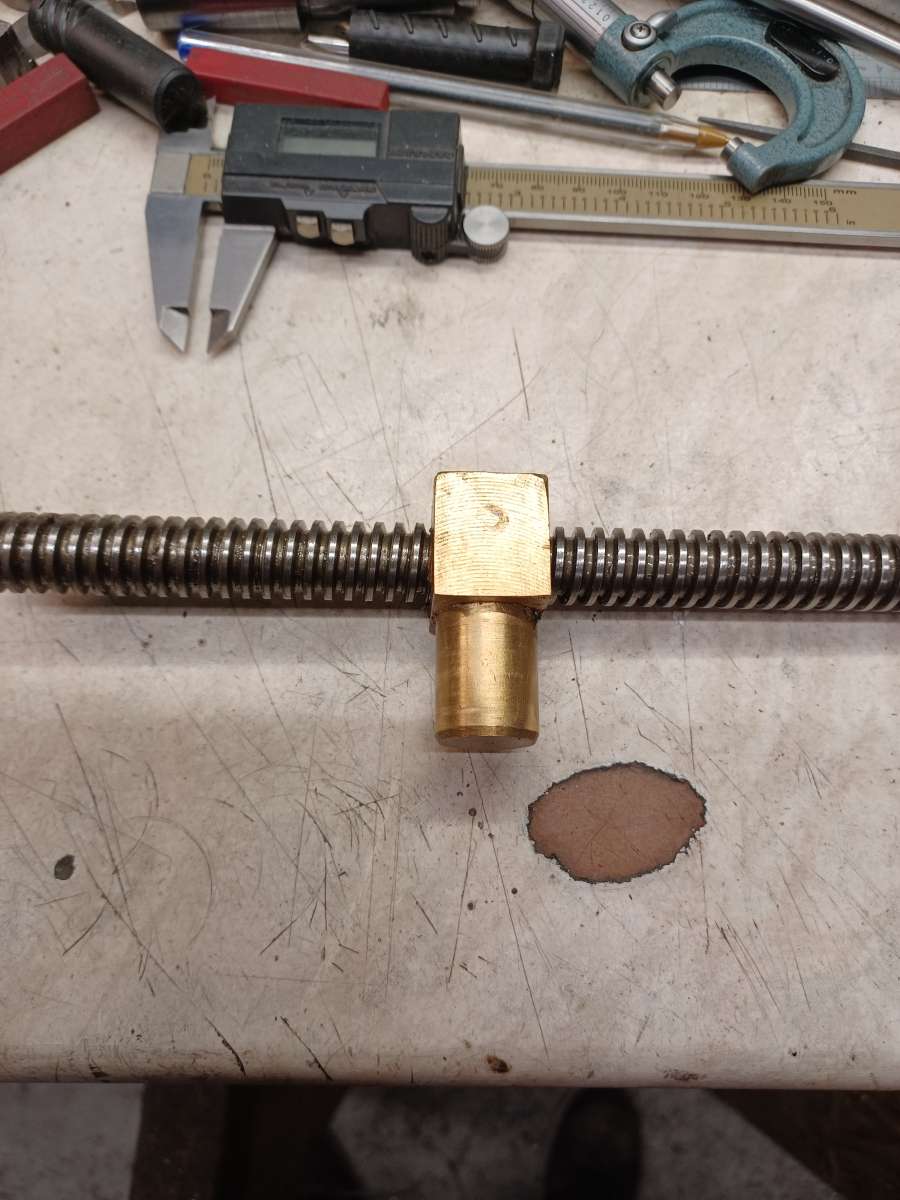

                                                Hi I have a Chester champion 16V and I have converted the Z axis to ball screw so the Z axis leadscrew and nut are sat in a plastic bag doing nothing If they are the same thread and attach same they are available. I haven’t looked at my bits yet but will look further and take a picture of spare bits when a bit lighter.
                                                David
