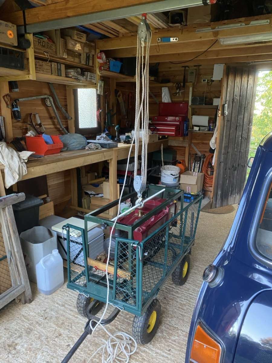

                            Speedy Builder5
                              @speedybuilder5
                              JA,  I will weigh my SPEEDY this morning. I was surprised how heavy it got especially once the copper boiler was added.
                              #819904
                              Speedy Builder5
                                @speedybuilder5
                                JA – Speedy 61Kg with its transporting cradle and about 3 litres of water in the boiler.  Note the lifting is by a simple lifting block/tackle which is in a slider so that the loco can be placed on the workbench (if there wasn’t so much rubbish on it) or onto the garden truck for taking out to the track.  The garden truck has a couple of legs that can be locked in place to stop the truck tipping backwards as the loco is rolled off the back of the truck onto a ramp and down to the track.
                                Bob
                                SPEEDY lifting 1

                                      I haven’t the luxury of an overhead crane but I do have a block and tackle, simple trolley and motorcycle lift/work bench. In addition a set of shear legs is easy to make and safe to use.
                                      JA
