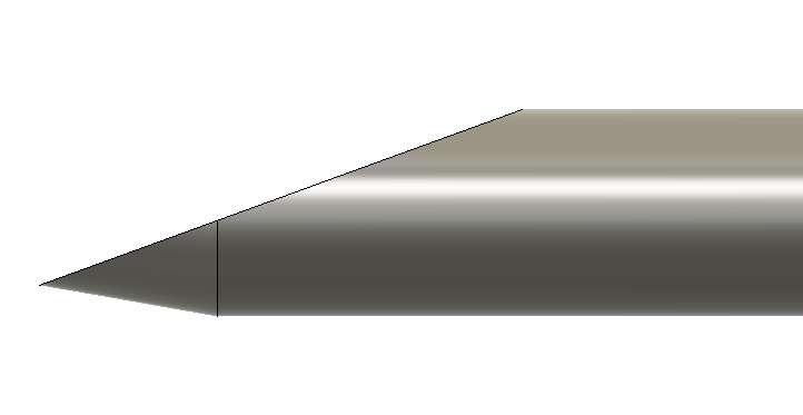

      On Fulmen Said:
      So, like this then?
      2026-10-15_221608
      This is a 20° included chamfer and a 20° oblique. And I think it’s a sensible idea, it should move the cutting action closer to the center line.
      Yes, that’s it.  I also ronuded off the left hand end as shown but not actually necessary.
      Martin
      #869769
      Fulmen
        @fulmen
        No, for a one-off job with a well sized hole it’s not absolutely required. But it’s a small tweak that should make the tool a bit more versatile.
