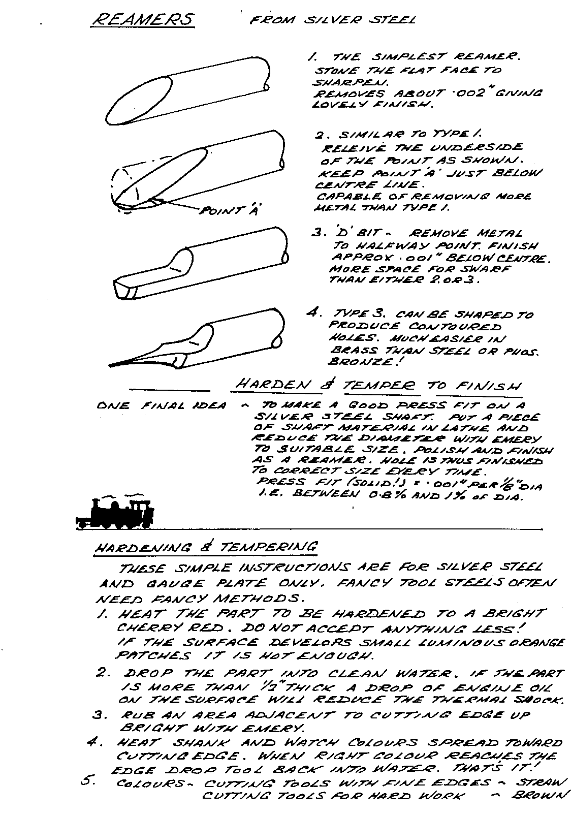

                  The last link provided this image, and the #2 looks interesting but I can’t really see exactly how the relief is placed.

                          After making the reamer I discovered that I didn’t have any bits between 2.5 and 3mm. I tried with the 2.5mm, and while it had no problems cutting the hole it came out around 3.2mm and tapered. But with a fresh 2.9 bit it worked like a charm with good fit and finish.
                          #869531
                            On Fulmen Said:
                            https://www.homemodelenginemachinist.com/threads/diy-reamers.4142/
                            #1 is what my Dad used to make
                            But I do agree, #2 looks interesting.
                            #869536
                            Fulmen
                              @fulmen
                              I made it like #2 (hopefully), just adding a bit of taper and back relief to the cutting edge.

                                        No. Without the flats on the leading flanks. Just an oblique flat surface.
                                        Like #1 in the sketches. But it did have the weak point reduced with a bit of a taper before the oblique cut was made. I don’t think that affected its operation.
                                        #869610
                                        Fulmen
                                          @fulmen
                                          I see. I’m still trying to figure out #2 and was hoping you had the answer. Either way the first render was what I used and it worked fine with a proper sized starter hole.

                                              I think that picture is the Type 2 shown in earlier diagram.  I have made them generally as the above phtoto but a bit more rounded off.  It helps the pointy bit find the drilled hole without bouncing off the adge and shifting the work as would Type 1 in theory.  Also lets you ream right through with a shorter reamer – remember the full diameter section is some way back from the end on Type 1.

                                                The handwritten blurb on Fulmen’s post suggests 1 thou interference pet 1/8″ diameter for press fits. This seems very high to me. Interweb suggests H7/s6 which gives 1 to 3 thou per inch if I’ve read the table correctly.
