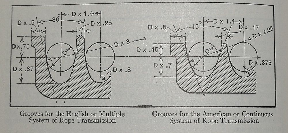

      Anyone know if there is a specific shape I should machine a pulley to accept polyutethan round belts?

          "Our" Tubal Cain reckons 30-35 degree V up to 1/4" / 6mm, depth 1.25 x cord diameter.

            GHT [for the Universal PillarTool] started at 50° included angle, and revised that to 40°
            Looks like it's not too critical.

              I use 60* for the 3 mm fused belts that I use on my hot air engines, I make the top of the groove about 4 mm.

                Returning to the original question … I think we are all agreed that [except for idler pulleys] the best basic shape is vee groove, truncated if you wish, with an included angle somewhere in the range 30-60 degrees.

                  I have seen a round profile at the bottom of the V on older stuff but the modern belts are pretty compressible so it may be tricky to get it right. I think there is info in older copies of Machinery's.
                  As pressure on the belt needs to increase under load I think Tubal Cain's figures make sense. A more acute angle will help with that.
                  One thing I do know is that round belt into a old L1 (light 1) profile as on my Pultra is pretty useless for anything other than very light work on rather small diameters – what ever diameter goes into it.

                    I'm happy to be corrected, but: I think that 'round profile' is just a tidy alternative to truncating the vee [i.e. I believe that the belt is intended to ride on the flanks of the vee, and not touch the profiled bottom]. Idler pulleys, such as those on the BCA are, of course, a different matter; in those, the radius of the belt is smaller than that in the pulley groove, to accomodate some mis-alignment.

                      Old round belt pulleys were round bottomed, I think that was because they used round leather belts, a higher co. of friction. Modern plastic belting works better with a V groove, I don't know that the angle makes a lot of difference. Last I made was using a threading tool 60 deg. works well, but not high power.

                        I think I'll just leave people to figure out what happens when these systems are used under load.
                        I have seen something similar for leather belting but can't remember where. These are for manilla rope.
                        Anyway it would be tricky to work out on belts with different rates of compression with load but going on the above I would try the English one with no chance of it bottoming. On the other hand the belt coming out of the V may be "sticky"  of the angle is too acute.

                          Useful illustration, John
                          Thanks for posting it.
                          P.S.  I was [slightly] amused to see that both drawings dimension the Radius at the bottom of the groove as a decimal fraction of the Diameter of the rope … Practical, I suppose, but it does seem odd draughting.
                          P.P.S. … More importantly, I note that both varieties have curved faces to the vee.

                                I'd guess TC obtained his views from the English version. Neither are supposed to bottom but I find that hard to believe on the American one.
                                It also mentions that some think curved faces are undesirable.
