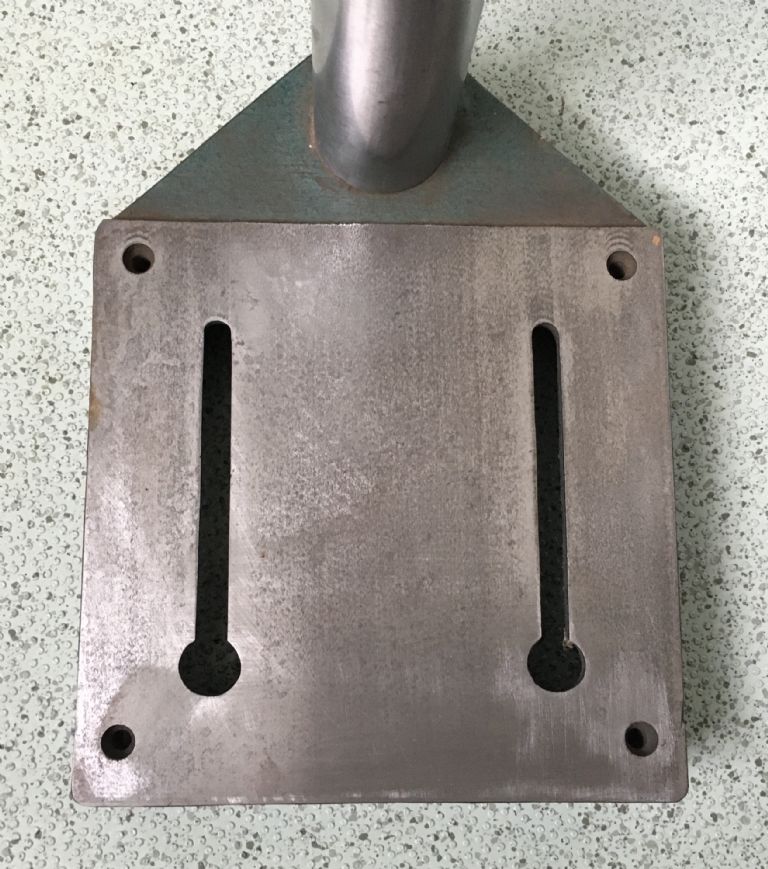

                          #619737
                            Posted by Stephen Follows on 02/11/2022 21:54:28:
                            I had a water leak in my shop which went unnoticed for a few days. The table rusted. Cleaned the rust but some very minor pitting. Watched videos where people finished surfaces with a stone but don’t know what stone. Looked very like oil stone used for sharpening.
                            Here’s a similar, but rougher, job in progress
                            The base of this bench drill was not only rusty but significantly bumpy [having originally been finished with a linisher], so I set-about-it with a suitably large flat stone.
                            As you can see …There is a way to go yet !
