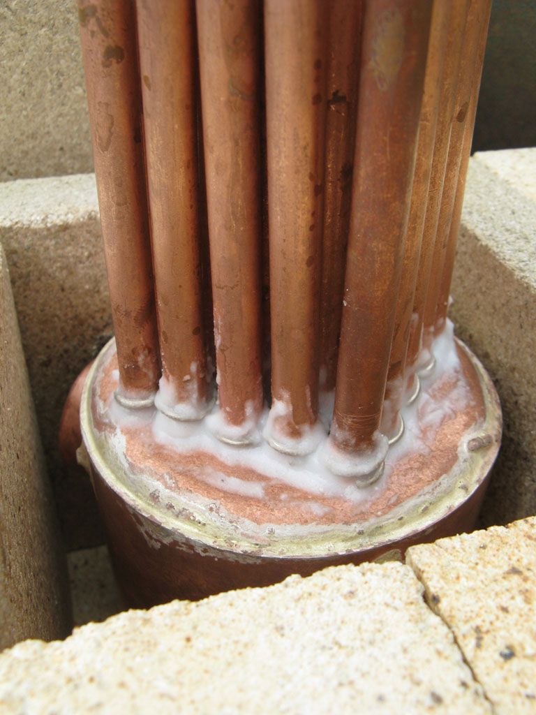

                      I used a Sievert 2941, which is 7kW. Soldering this boiler was pretty scary. Don't make the same mistake I did, and do it inside (the garage, not the house). Apart from the smoke alarm going off, after a few minutes of 7kW burning away there isn't much oxygen left – even with the garage door open.
                      You'll need welders gauntlets or something else substantial to protect your hands, and a bucket of water just in case.
                      As to whether a 3kW burner would do it… well, I am no expert at all. But it did take what seemed like an age to get the boiler up to temperature. So it would take even longer with a 3kW burner. I would play safe and go for a bigger burner.
                      Here's a photo of my arrangement. The whole job is surrounded by vermiculite bricks and I found an old barbeque to act as a hearth.
                      Soldering GLR Vertical Boiler
                      I put rings of solder around each tube, and I think I had a length of silver solder in my other hand to touch it up.
                      I have some more photos if you would like more.

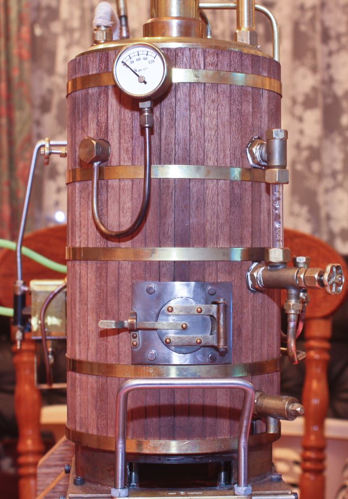

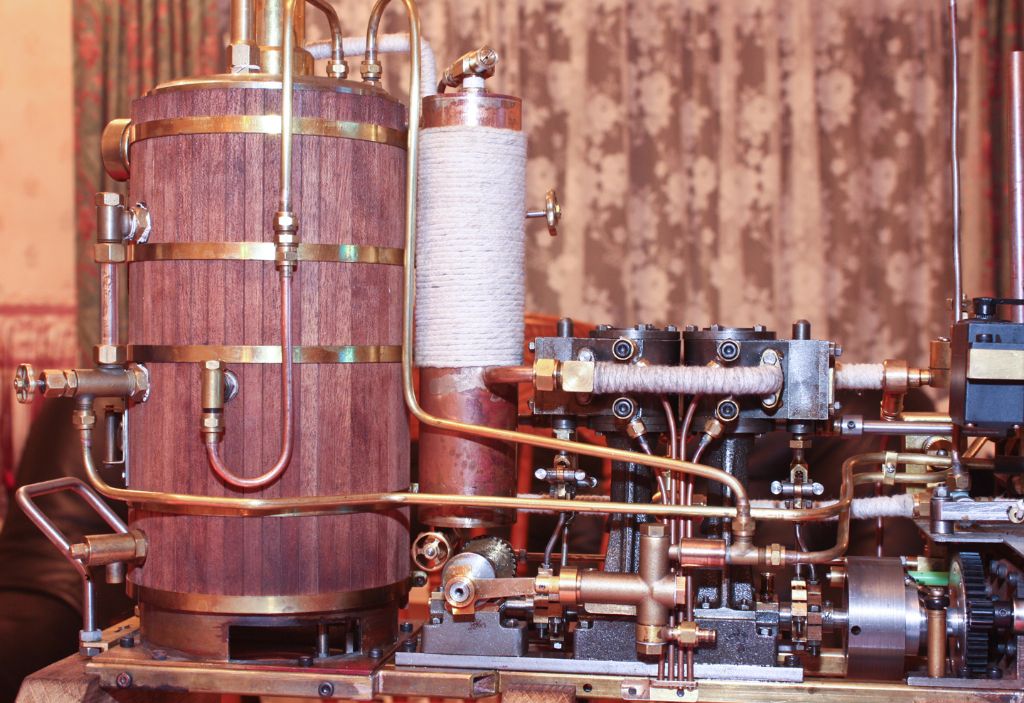

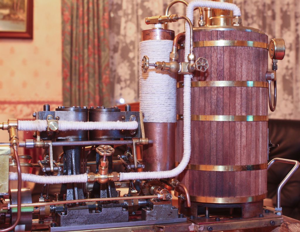

                              I have put some more photos here. I can't claim it's the best made vertical boiler, but it raises steam and building it was hugely educational.

                                  Thanks Martin the boiler looks great, love th idea of sticking the cladding to some card, I shall be using/stealing that idea
