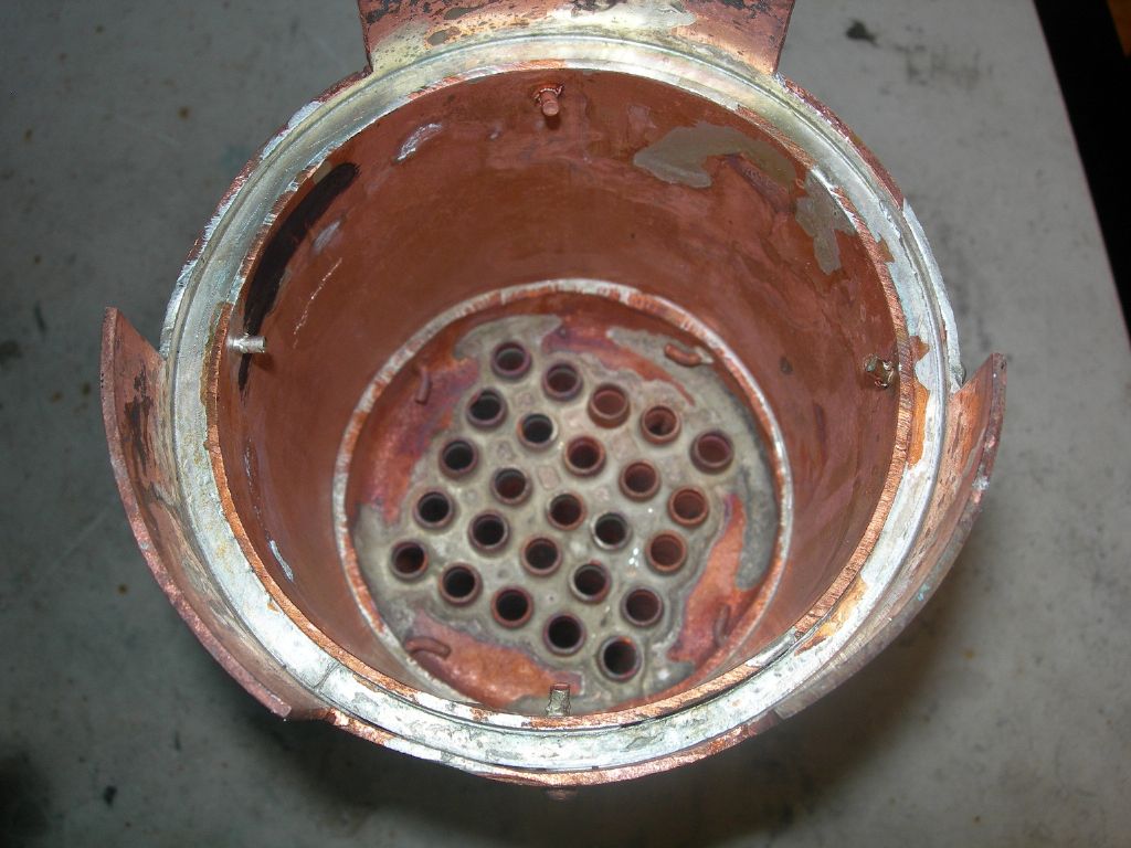

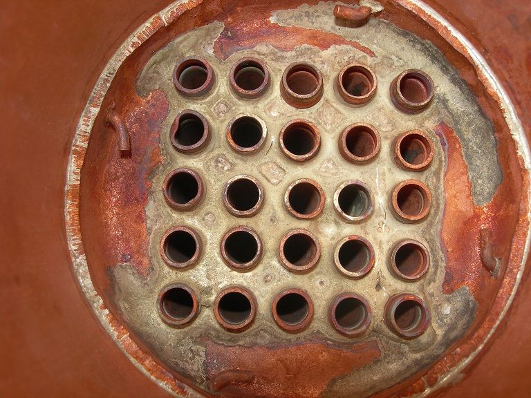

              Hi Chaps, thanks agiain for allthe advice, Adams boiler/engine setup looks the business. So I've at least made a start.. Here is the tubes and firebox from the bottom (the fact that it has no firebox door may seem a little odd, but seeing as its going to be gas fired and it was my first attempt I thought I would follow the sdvice in the wee book and just mage a "dummy" door).
              Here is the foundation ring which has couple of bits where the solder has not flowed correctly (i think it did flow but the gap was too large, so it did "tin" both edged but fell through the hole. I have since given the side a bit of a tap and will try again when my solder/bigger burner arrives from cup).

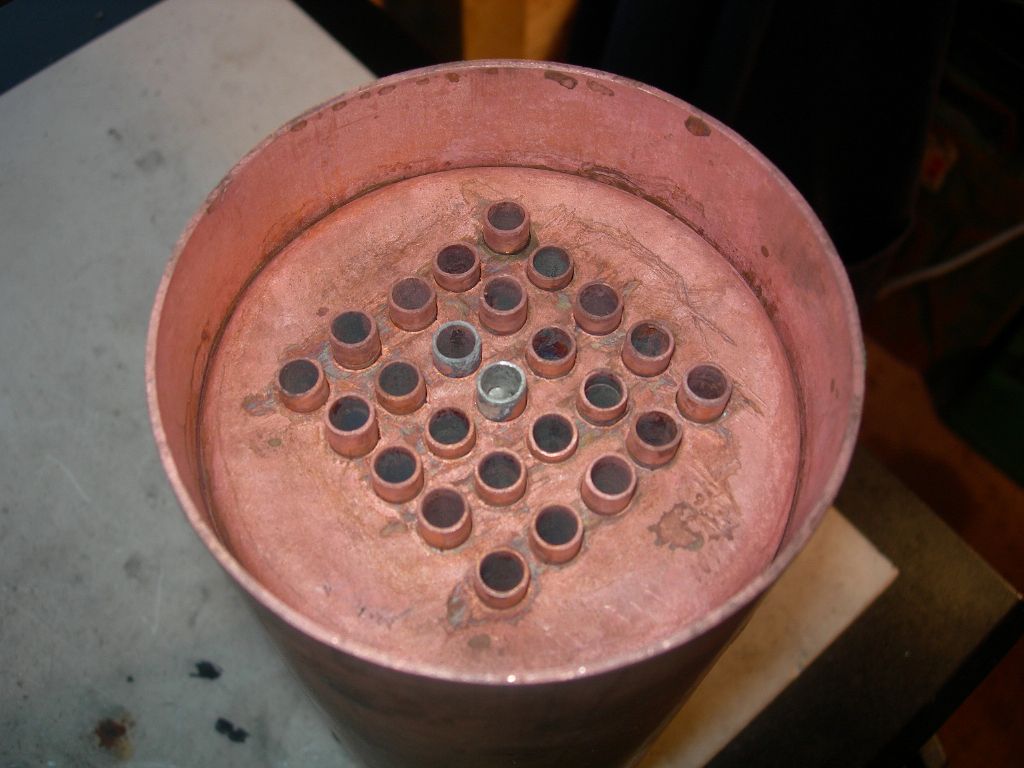

              I made rings of solder for the tubes and cut little lengths for the rim. You can see the small ridges to stop the tubes falling through. I had to put them on the inside as did not leave enough lenght to fit through the plate (whoops!) this means the water section will be about 3mm shorter than it should be.
              and finally the top tube plate waiting to be soldered when the solder arrives (i've run out) you can see where some solder I applied by had went into a tube and ran its full length (a waste of expensive metalcrying 2)

                Looks good Dunc, you are at about the same stage as mine but with a bit more success than me at the moment by the looks of it.
                Bill D.

                  Dismaldunc
                    @dismaldunc
                    Aargh! Trying to solder the top tube plate , put loads of flux, solder rings around and the tubes and short lengths of solder tucked in the flux all around the outside. I made a little hutch in the brazing hearth ,heated it from the outside a till all the solder melted and disappeared. The tubes all look fine but half of the circumference of the outside is not sealed, so I fluxed it again and tried again but still the same result….. Help !!!!
                    #107977
                    Dismaldunc
                      @dismaldunc
                      well I think I've got to the bottom of why this is suddenly a lot harder….. owing to me having the typing skills of a baby elephant wearing boxing gloves I ordered 449 solder instead of 455 not only does it melt at a higher temp, it also costs more I. hearby award myself the "Order of Numpty class 1" (bows and retires)

                      Bill Dawes
                        @billdawes
                        Hi Dunc. I had the same problems with the firebox and foundation ring, erratic melting, mine not due to different solder though (455) just erratic skills I think.
                        One thing I am still trying to get used to is the time it takes for the solder to melt, just as I am beginning to think it never will, it suddenly goes.
                        Getting to your stage in next day or so.
