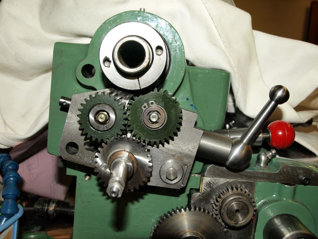

                              @kwil
                              Meek+KAW
                              I have used OILON mateial for these gears and they are 20DP 20PA as they are driven from the Myford Spindle gear.

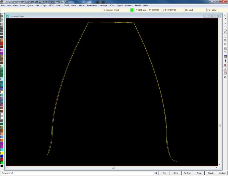

                                              John Stevenson 1
                                                @johnstevenson1
                                                Phil,
                                                I beg to differ and bearing in mid we are talking units of scale here.
                                                Now if you swap a 25T 20 DP gear for a 25T 1.25 mod gear one for one then the Mod gear will be 1.328" and the Dp will be 1.350", a difference of 21 thou which would be a no no.
                                                However if you use the mod cutter to cut the gear based on an OD of 1.350" and cut to the designated depth for the DP gear of 0.1079 you will need measuring equipment far in advance of anything found in the home shop.
                                                I drew both gears and over laid them, then moved one tooth of the Mod gear to match the OD of the DP gear.
                                                Not probably the best picture but the inner yellow gear is the mod gear, the outer brown gear is the DP and at the greatest distance which is towards the root the difference measures 0.00027"
                                                So basically using the 1.25 mod cutter but using the DP calculations will get a you a gear that is more than serviceable, in fact it would be interesting to measure a genuine gear to see how close to specs they are.
                                                I could do this as i bought all Myfords gear cutters re the sale but unfortunately i don't have any method to measure to this accuracy.
                                                What is important is the fact that the first 4 gears are 20 PA, something that the people selling the red plastic gears on Ebay haven't realised crook
                                                Edited By John Stevenson on 21/07/2013 12:10:02
