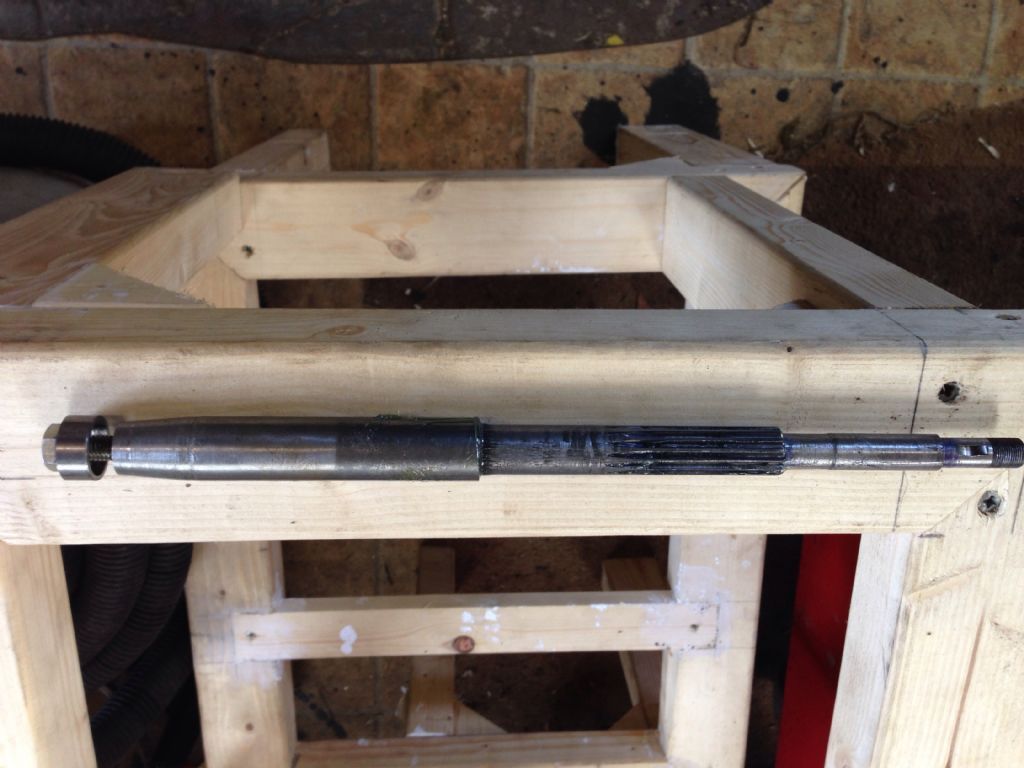

      Hi John, we have been down this road before, the early Deckels FP1 mills was indeed 14.5 PA as one of these shafts was made further back in this post by a forum user. Speed"" slow as it will go, think about 150rpm, yes the fly cutter is indeed a 7.5 " x 1" round disc solid as a rock on a 4 MT, as I know nothing about gear cutting but thinking of purchasing a 20 degree just to see if it works.

            Ian hi,, I have an inch one I could use how will this make a difference? All this is new to me, do you have any problems fly cutting gears, I have 14 teeth to cut @ 82 mm deep, lot of cutting for one, as a gear cutter as 12 teeth or so lot more cutting action,

                Sorry I do this a lot, 0.82" 2 & a bit mm. Ok John shaft size is 16mm 14 teeth if you do that I can try it in the Deckel I'm not saying your wrong John, you have forgotten more about this type of work than I will ever know, I have a thought that you have been on the money all the time, as when I measure the angel ( best I can) 14.5 looks wrong to me, but with no experience!,, if I can use a gear cutter that will cut the profile I will be well happy. Maybe I should stick to clay shooting at least I can win some money on that.

                                Just put the fly cutter cutting tool in a 1" fly cutter. Been cutting now for 2hours works perfect. Lesson learned .

                                      Hi" almost done now, the gear cutter did the job, 20pa mod1 No7 just didn't go full depth, as the gears are 14.5pa mod1 No7 but you guys found a way to solve the problem. Just putting a taper on the end for the handle, & I have the woodruff key to cut, that arrived today, & I will post a photo.
