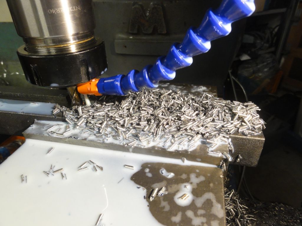

                      As Andrew says, experiment to see what your machine can do. You are more likely to be limited by the machine rigidity (judder) than by the power of your machine and even then, changing (increasing?) the speeds and feeds may help bring you out the other side. My machine is almost identical to Andrew's ie 1.5hp motor like yours, so hardly a monster
                      This shows what 1.5hp can do. It's a 5/8" tee slot cut in 4 passes using a 12mm HSS end mill. 2 passes to get down to full depth, one to open out to 15mm / 5/8" and then one pass with the tee cutter. As Andrew says, make use of as much of the side faces as you can otherwise the ends and corners will wear out prematurely.
                      For prolonged cuts like this, the coolant is necessary to avoid the tool overheating. You have the power – now see what it can do! Power feed is a bonus, as it allows a consistent and safe feed rate.
