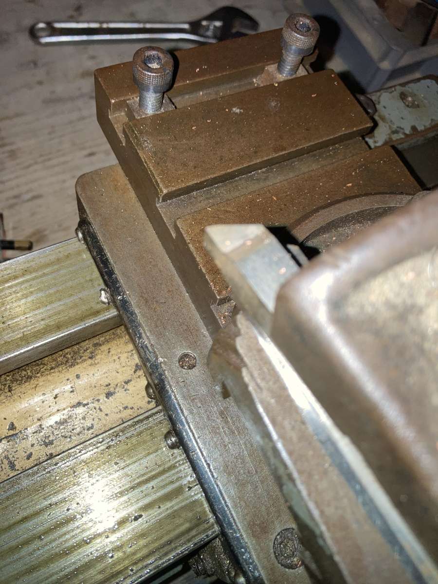

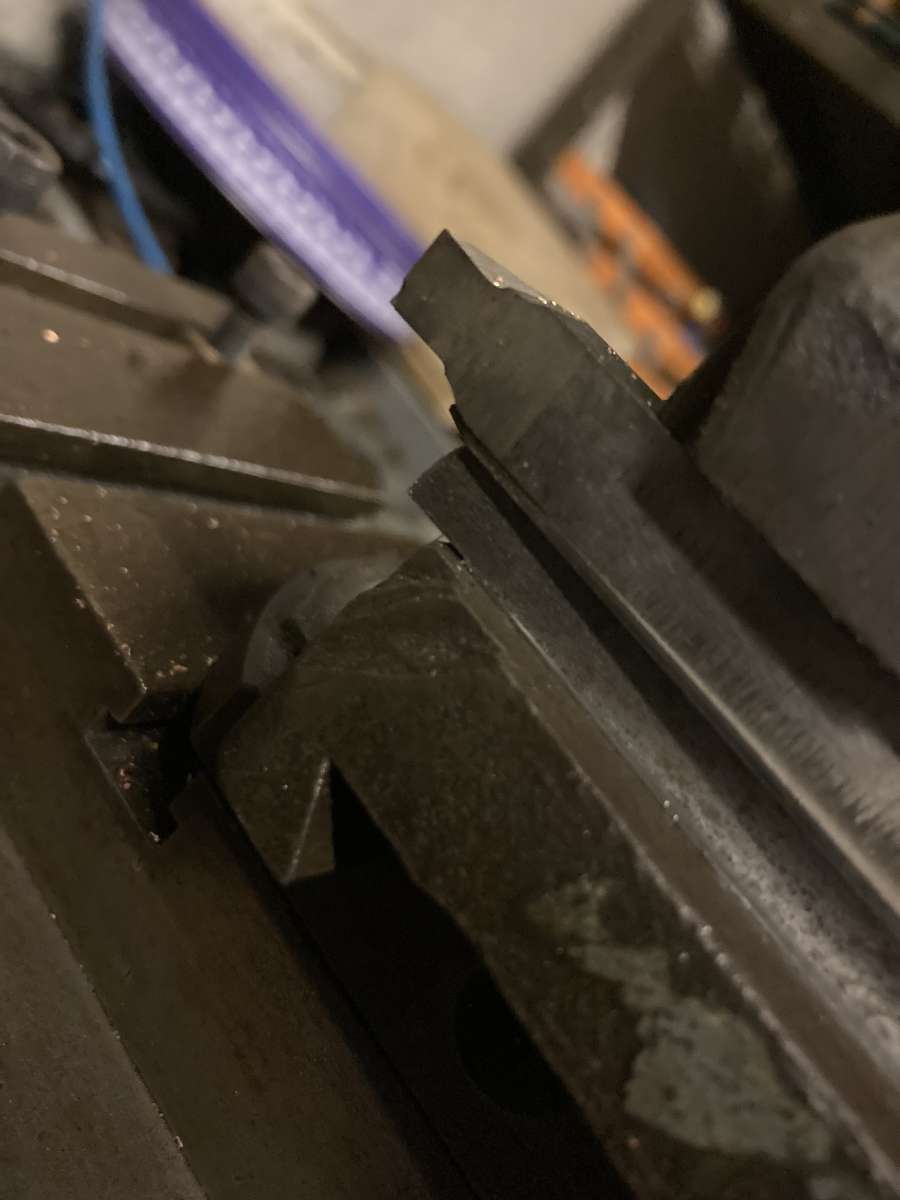

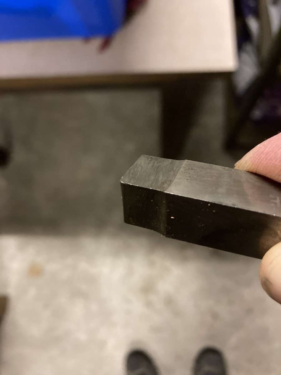

                        I’ve followed the thread with interest and slightly daunted by the differing advice. Anyhow, there was a request for a photo of the cutter – the 1st and 2nd photo is the cutter in the tool holder which was the second one i used after i wasn’t getting good results with the first cutter (3rd photo held in my hand).
                        Tomorrow i am going to try get some mild steel – i think i started off on difficult material.
                        Once again, many thanks and it is a steep learning curve.
                        Andy

                        Dave Halford
                          @davehalford22513
                          The last one is blunt, you should be able to shave your nails.
                          #824562
                          cedric 1
                            @cedric
                            And the first one looks like it is laid over sideways. Needs rotating 90 degrees to bring the cutting edge up to the top left hand edge.
                            #824568
                              I’d agree with cedric, the one that did not cut has been ground to cut a groove and is mounted on it’s side.
                              The last is the right way round but not the sharpest, you should not be able to see that slightly shiny corner where the horizontal and vertical faces meet. A rub on an oil or diamons stone will help it no end.
                              Both tools also look to have a near flat top face which is more suitable for brass, the bronze you were cutting really needs more “top rake” that is where the top face slops downwards from the cutting edge. 5-7degrees would be a good general angle without having to grind specific tools for each type of metal. You will need to grind that amount of material away not something you can do with just a stone.

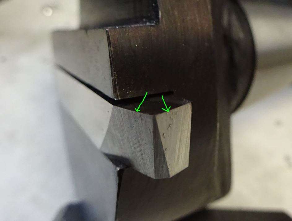

                              #824570
                                Here is a photo I had on file, where the top meets the sides there is no shiny “blunt” area, it should be a clean crisp junction.
                                crisp
                                Shaped on a belt sander for those interested.
