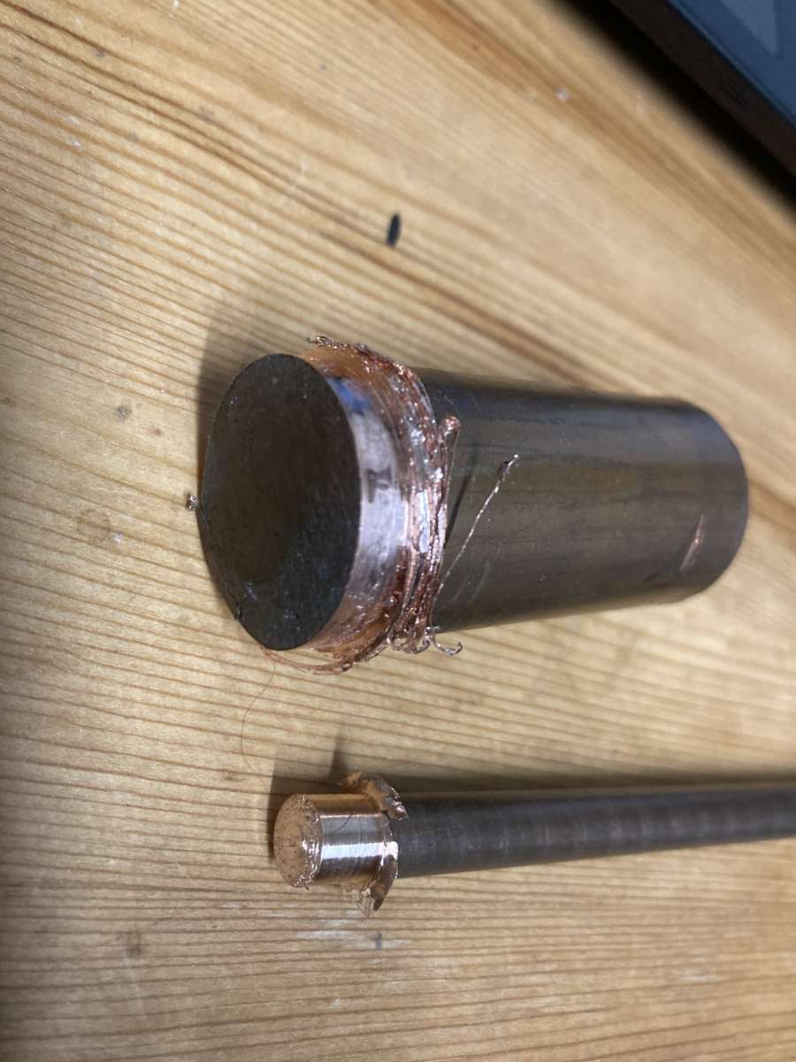

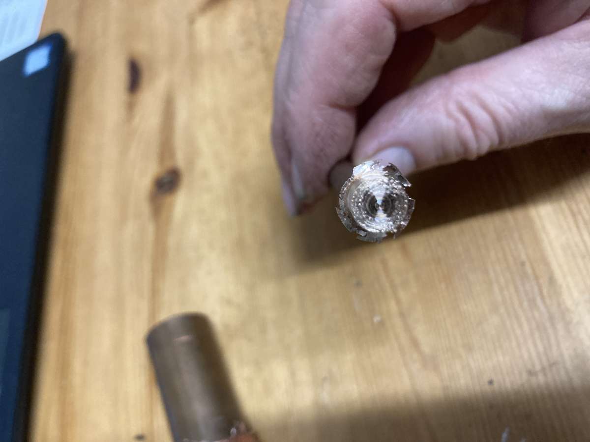

      Hi, at last i have got my Myford lathe running and this evening took the first cut, however, as you will see in the photos, it wasn’t a great success. Couldn’t get a smooth finish and it just seemed to push the metal along and created a big burr. And facing left it scuffed.
      By-the-way, not sure what the metal is, it was just some scrap someone gave me for exactly this sort of thing!
      any clues on what I’m doing wrong?
      thanks, Andy

        Difficult to tell from a photo but as a start I would weigh that bit of metal in and buy a piece of known steel.  Looks like a copper or high copper alloy both of which are not particularly nice to turn and probably not the best material to learn on.  Weighing that in will pay for a reasonable bit of known steel and then you can play around with tool types hss self ground, replaceable tips or even brazed carbide – the latter will get howls of derision on here but they have served me very well in the past and are cheaper than tips!
        Paul.

          Could We see a picture of the tool edge?

              Looks like Phos Bronze to me – lucky boy!

                A photo of the tool in the machine and a closeup of the cutting edge would be useful and also to see if it is HSS or carbide. Most likely blunt or not set on centre height.
                Keep the expensive bronze for something later like the boiler for your oscillator, the larger more copper coloured one is not so easy to turn but the smaller looks to have less copper as it is yellower and will be more useful.

                  It looks like you have the tool on centre as you have faced to the centre on one of the pieces so as Jason has stated above it’s down to tool geometry and condition, some photos of the tool being used would also help.
                  Looking at the material, you have two different types which probably require different geometry to produce a good finish. It may help for you to obtain a couple of books on basic turning from authors like Tubal Cain or Martin Cleeve which give all the basic shapes, clearance and rake angles.
                  Andy

                    Or just settle on CCGT inserts and they will cut both of the different bronzes without issue as well as a lot of other materails. It will then take that worry out of getting a decent finish.

                      I diagnose these problems by looking at the three main causes:
                      • Machine: wrong RPM, feed-rate, insufficient rigidity to wear or poor work-holding, wrong cutter shape, not at centre height, or blunt.
                      • Material: may not be machinable!  Or difficult.  Too soft, too hard, many metals work-harden during cutting.  Choose carefully, and know what it is.
                      • Man:   operator doesn’t know, yet, what he has to do.   Doesn’t recognise symptoms.  May be clumsy or poorly coordinated.  Practice required, plus some good books, or a mentor. Lots of practice: turning, facing, boring, threading, trepanning, tapering, finish, and accuracy all have to be mastered.
                      In this case maybe all three, but mainly learner driver and scrap metal.  Made a terrible start myself due to collecting scrap to learn on, and it all turned out to be horrible.  I was convinced that Mini-lathes don’t work – complete rubbish.   By chance, a friend asked me to turn a steel rod to size, and provided the metal.  It was wonderful – EN1A.  Now I advise beginners not to pratt about with scrap – buy known metal, where the specification says “free-cutting” or “good machinability”.  After learning on them, try scrap.   It can usually be machined by an experienced man.
                      Hard to tell from the picture, but Andy’s rod looks like Bronze – a difficult metal.  Might be a soft Brass.   Be aware that ‘Bronze’, ‘Brass’, ‘Aluminium’ and ‘Steel’ are alloy families, not one metal.   There are thousands of alloys, each race-tuned to meet a manufacturing need, and very often not machinable.  (The Aluminium alloy used to make extruded greenhouse frames is too soft to machine well in a lathe.  The steel alloy used to make cutters is much too hard.  etc etc.  Beware scrap.  DIY store metal is mostly nasty too.)
                      The cutter might be wrong toom a machine shortcoming.  For example, those brazed carbide tip cutters are often supplied unsharpened!  I found out the hard way.   HSS and carbide inserts are safer.  Bear in mind that sharpening HSS is an acquired skill.  Some lucky so-and-sos have no bother learning it.  Others struggle – after a lot of practice I manage, not very well.   Watch out for well-meaning chaps who assume that because they are good at grinding HSS, it must be easy.  They are misguided!  A man problem.
                      Persist.  Starting out, I made many small  mistakes.  Practice, reading the books and taking forum advice slowly eliminated them.  Then something ‘clicked’ and I was away.   The man had learned enough about materials and his machine to get reliable results, unconsciously!  Part of the learning is recognising what’s going wrong.
                      Andy is doing the right thing: try it, and ask here if it goes wrong.  Lot’s of good suggestions already.   Consider them all, even if they seem contradictory, for example:
                      • I say avoid Bronze, a difficult material
                      • Jason says, correctly, Bronzes are cut well by CCGT inserts.
                      Mine is ‘get you started’ beginner advice; train on easy materials.  Jason’s advice is gold in the next stage –  how to machine Bronze on a real job.  But there’s no learning objection to Andy trying CCGT immediately; inserts are a ‘good thing’.  One caveat: Andy’s Myford was designed when HSS was king, and the machine is a bit slow and underpowered for carbide.   Jason and I have Chinese WM280’s; they’re heavier, faster and more powerful than a Super 7, making it easier for us to get good results from inserts.  Carbide performs best when driven hard and deep with gusto!  Something else to explore.
