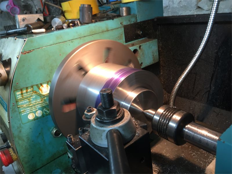

      I'm 95% sure this is OK but as I've never done it before, or seen it on the 'net, I would like reassurance – or otherwise.
      I'm thinking to fix a 150mm diameter by 100mm long round steel bar (so about 14kg) to the faceplate by tapping an M8 hole centrally at one end and passing M8 threaded rod through the spindle then clamping by tightening a nut/washer arrangement at the back end of the spindle.
      Is there any reason to think that this arrangement might fail? My aim is to turn the ends of the bar as parallel as possible – so I'm looking at a thou or so facing skim.
      Reading what I've written I'm up to 99% confidence, but would welcome any comments. I am of a nervous disposition.

          Well I have been known to push the envelope with work holding but I don't think I would contemplate that on a single m8 stud. A thou or so or not I wouldn't recomend that. At a guess I think m16 would be as small as I would go. I would probably do some calculations on load before committing.
          Paul.

            Those slots in the faceplate are there for a reason. Drill and tap four 8mm holes into the back of the job and bolt it down securely. It will move about all over the place with only one on the centre.

              You'll never achieve your best results by bolting to the faceplate. Any runout in the face of the plate will be reflected in the end of the part, and the OD. Turning between a pair of solid centres is the proper way.

                    Why not mount on centres and tap a hole off centre to use a screw as a driver. This still leaves the od clear and the part is fully supported.

                      Using only one clamping location is always a bad idea when machining as the cutting forces tend to pivot the work around the single clamping point with nasty consequences.

                            Not a good idea IMO, plus if the bar is not cut truly square where fitted to the f/plate the faced end will not be square to the 150mm length, I believe the 4 jaw with centre support is the route to take.

                                      Ian, if pulled back to the faceplate the billet may not form a square with the f/p surface so any facing although will be parallel with the faceplate it won't be square with the length if the mounting surface is not square.
                                      You seem to be assuming an accurately cut end which may not be the case, if using a 4 jaw this can be detected and adjusted out before facing.

                                              Thanks for the suggestion Jason – I tried the stub in the 3-jaw method but found I was still about 40 microns out of parallel over a 100mm diameter. That was turning the bar end-for-end between the stub and the tailstock centre and facing at the tailstock end. I'm not sure why, but will investigate.
                                              When I realised (duh!) that that I could combine the screw though the spindle with tailstock support:
                                              I went for the faceplate method. Cripes, I thought, I bet I'm in for another disappointment. But it came out within 12 microns parallel over 140mm. I'm well chuffed with that.
