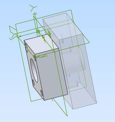

      I thought I’d discovered how to do this only a couple of days ago, but it must have been a fluke…
      This little assembly, of nothing itself, is to see if I really had managed to copy features from one Part to another. As I sometimes want to do in the real CAD drawings.
      It didn’t work!

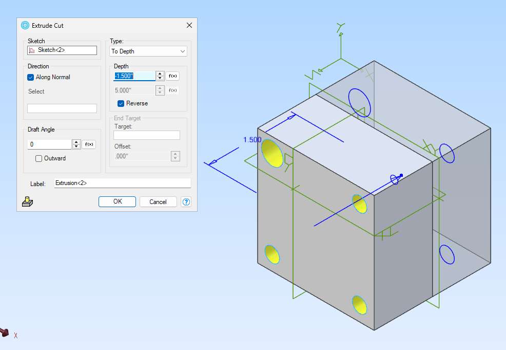

      Screenshot 2026-01-13 204951
      E.g locating bolt-holes from an existing component into a baseplate, or modifying their pattern.
      The Manual tells you to right-click on the part you want to edit, then right-click it to return to the Assembly page. Here the change is not editing the original, outer part as such but extending its holes extrusion to modify the substrate.
      After a few attempts to work out the direction, I created as shown above, 4 holes in the second block exactly matching those in the first.
      Only, then any of “OK”, keyboard “Enter” or right-clicking anything (which – original or copy?) simply cancels the tool with no effect on either Part. Changing the “Label” from “Extrusion <2>” to Extrusion <3> still cancelled the operation.
      The Manual is not very clear, and its example illustration is not at all useful.
      So am I wrong thinking this form of copying through is possible?
      Can you plot all the common features only by doing them twice, once on each Part individually?
      Or does it work only if you assemble both parts first then plot all the holes as if a single piece?

                            The smallholes were meant to go to half-depth (half-inch). Then separately the large central one, right through.
                            I don’t know what I did wrong… but I didn’t expect this result. I don’t suppose there’s a tool anywhere in Alibre that lets you do this deliberately.

                                      Nigel had 3 separate extrude cuts acting on the ‘rear’ (in his image above) block.
                                      1 of the extrusions was exactly as it should have been, projected edges of the (outer 4) holes of the front block – and cutting about half way through the rear block.  ‘Maintain association’ had been used correctly.
                                      1 extrusion used the entire projected face of the front block, to cut through all the rear block.  ‘Maintain association’ had been used correctly – just too many figures in the sketch, and too deep – hence the ‘negative’ part left at the back.
                                      A final extrusion had edges of the 4 bolt holes projected, but no ‘maintain association’ used – and these had somehow been moved.
                                      The extra cuts had also cut away things that had previously been used for assembly constraints – can’t fix to an edge if it doesn’t exist any more…
                                      Suppressing or deleting the 2 ‘extra’ extrude cuts, resolved most things.
                                      There was also a minor confusion relating to the ability to modify colour and opacity of a part in the assembly independently of its original colour.

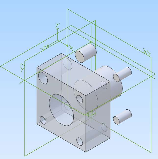

                                        There in the end. The rear block is deliberately translucent this time.
                                        What a struggle – that must be among the hardest tools to use.
