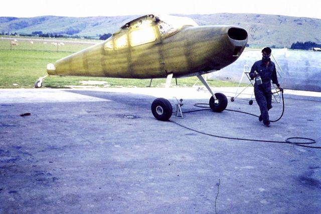

                                          I was once asked to write on aluminium light bulb caps using chromic acid and a stick. At the time I thought that was etching, but it seems it produces a 'corrosion resistant' oxide layer. It might work as a resist.
                                          #340147
                                          Ian S C
                                            @iansc
                                            Alan, you are right about the chromic acid, that's what we used in the aircraft industry to neutralize corrosion on aircraft skins{Alclad), then they got a coat of zinc chromate primer2012-09-15_0cfi painting (1)sam sands painting cfi (640x427).jpg
                                            Ian S C
